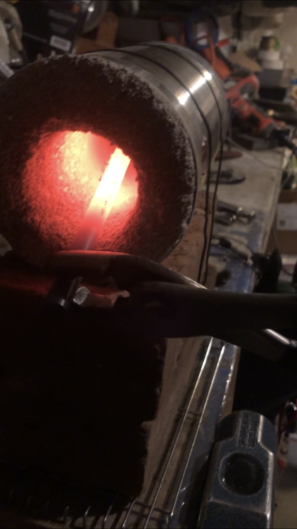

AngryDaddyBird Posted January 14, 2019 Share Posted January 14, 2019 I transferred this over as mentioned I should do. Here is my first attempt with mistakes upon mistakes but in the end, It works! the post was this: For several months I been using two propane torches to try my hand and forging small steel stock into flint strikers and other things. One torch is a bernzomatic BZ8250HT and the other is a modified Old bernzomatic all brass torch. Both are regular propane/mapp torches. I been reading for months about what forge to buy. Then decided since I don’t know if I really want one I’ll just make an easy mini can forge. I Used Koawool, Kast-O-Lite 3000 and Metrikote. Heat source will be my modded torch head. I do have a few atlas burners and regulator hoses from atlas. The 30k with 20psi regulator and the dual 150k setup with 30psi regulator but I think I’ll save those for a nicer more thought out build. This was a fun build and works. I tried to angle the heat into a swirl and it does it well! It’s my first try so lots of mistakes and lots of things I’ll do different on my next bigger build. I’ll make the next one with a 5” diameter chamber that’s 12-15” long. There’s Many, Many mistakes on this build! But hey.... I tried Heres some pictures. Quote Link to comment Share on other sites More sharing options...

Mikey98118 Posted January 14, 2019 Author Share Posted January 14, 2019 To begin with, congratulations on building such a hot forge. Great photos too. Please go into some detail on how you lined it. How long does it take to heat up, and what is the longest time you have run it for? That is the hottest micro forge I've ever seen running from a regular cylinder-mount burner Quote Link to comment Share on other sites More sharing options...
Mikey98118 Posted January 14, 2019 Author Share Posted January 14, 2019 As to your mistakes, there is an old saying; "If it's dumb and it works, then it ain't so dumb." At first I thought you had placed the burner port too close to the exhaust opening, but a second look makes me think that the exhaust blows out the large opening at the far end of the forge (its back), while work pieces are feed into the forge at it front. Normally the back end of a forge is sealed or only has a tiny opening, which would cause the exhaust gas to blow out the front opening past the work pieces. And--normally--that would overheat a brass burner head. What you have designed is not the most efficient forge, BUT IT SETS A NEW HIGH FOR PRACTICAL!!! Quote Link to comment Share on other sites More sharing options...
AngryDaddyBird Posted January 15, 2019 Share Posted January 15, 2019 4 hours ago, Mikey98118 said: To begin with, congratulations on building such a hot forge. Great photos too. Please go into some detail on how you lined it. How long does it take to heat up, and what is the longest time you have run it for? That is the hottest micro forge I've ever seen running from a regular cylinder-mount burner I’ll try to answer best I can and I appreciate allthe kind words. I ran it yesterday 3 hours and the can didn’t get hit until the 1-1.5hour mark. My torch now gets about 2-3 hours on a 1lb tank but yesterday I backed it down and it’s still got about 1/4 tank left after a 3hoyr run. I find that after up to temperature I can back it off quite abit! I think the heat out the end eventually reflects to the outer can or its overal so small it’s bound to get hot no matter what. I’m sure I could wrap koawool or even fiberglass around the outside and it be cool to touch. It takes 5 minutes to get up to good temperature and anything I place inside heats up fast! I lined it first with Koawool and packed it against the wall tightly. Tried it and did ok just like that with a coat of Metrikote on the koawool. Then I decided I’d try putting the Kast-O-Lite 3000 on it and finished with the Metrikote. If I had to do it again I’d just do koawool andmetrikote or just Kast-O-Lite and Metrikote. the burner/torch is 1.5” away brim the front opening angles upwards and towards the back opening. I played around with jet/torch angle a bit before I was happy. The flame swirls the entire chamber length and heats to the very back of the forge. The bricks that are in back of the firge are 1/4” away. I tried blocking it but got better results with it open. Out the front is only A tiny bit of flame. I planed on using a regularforge burner but think this will be ok to play with. I already have the materials to make a second bigger version. I have 1/4” thick 6” square tubing 15” long. I’ll use it to make the next one. Also plan to make a nicer micro with 4” square tubing. I also have 20psi & 30psi regulator hoses, extensions and burners. So lots to play with once I decide what to make. I’m thinking I’d only need the 100k atlas burner and not the dual 150k for a 5” chamber 12-15” long but I’ll have to just test it and see. Heres some one things I just made in the pictures below. Mini log dogs and a snail striker. I heat treat only the face with a torch instead of the forge to keep the rest of the striker soft not brittle. Thanks Ryan Quote Link to comment Share on other sites More sharing options...

AngryDaddyBird Posted January 15, 2019 Share Posted January 15, 2019 6 hours ago, ThomasPowers said: Don't they still make adapters to run torches off bbq sized tanks? Yes I have one. Two actually. But I also had lots of half full tanks like these so am using them up. Once gone I’ll be running it off a regular BBQ tank. Quote Link to comment Share on other sites More sharing options...
Mikey98118 Posted January 15, 2019 Author Share Posted January 15, 2019 It is always good to point out that what is needed to make a great little forge like this can be considered a minimum. While such upgrades as stainless steel burner heads, and special hoses to attached these burners to refillable propane cylinders can be added later on, if they are ever desired; some will want such upgrades, while others won't use a micro-forge enough to find them worthwhile. Quote Link to comment Share on other sites More sharing options...
