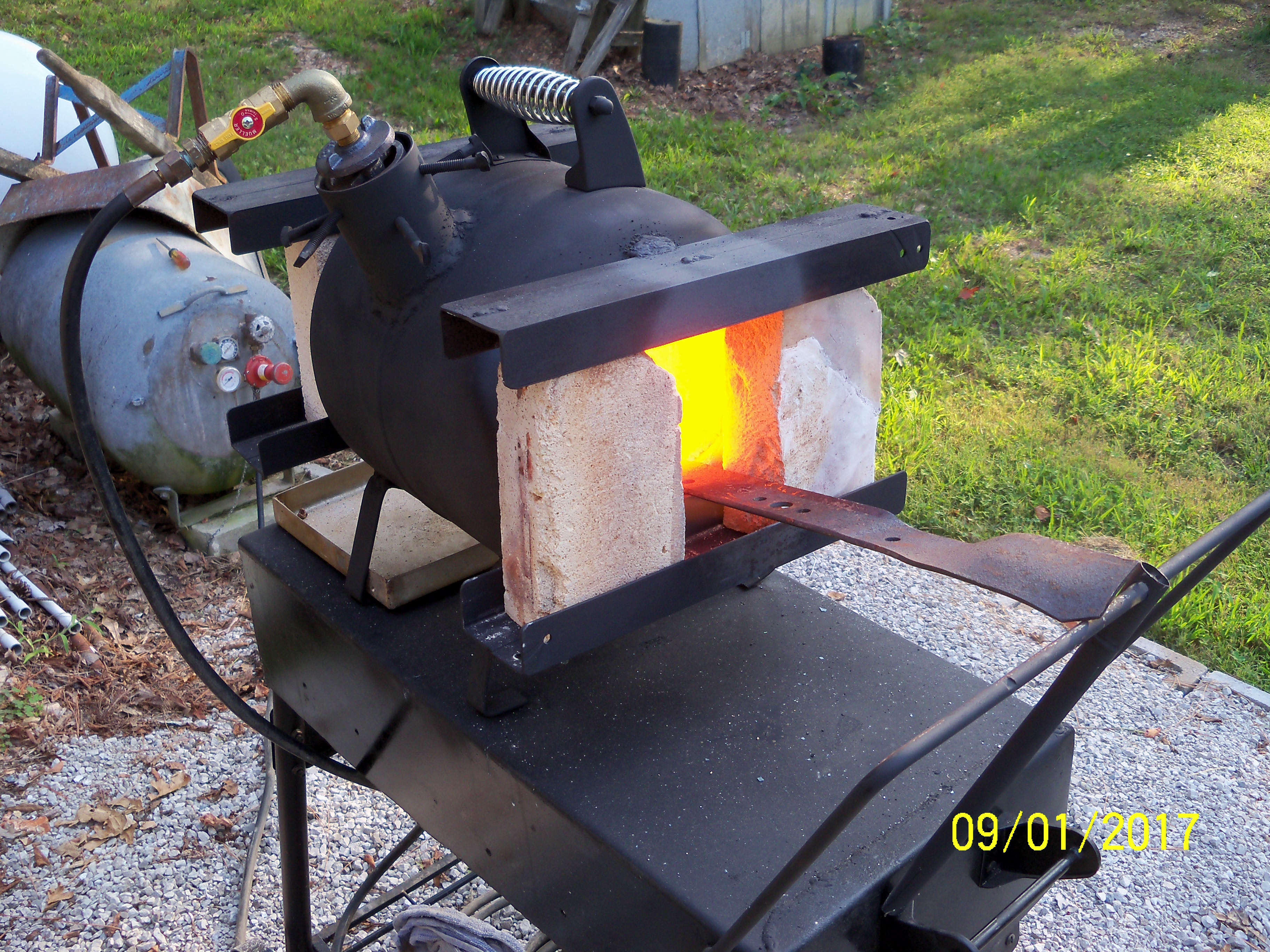

Mikey98118 Posted September 1, 2017 Author Share Posted September 1, 2017 In the five gallon propane forge, I think I used 2" from TDC, along with aiming the burner vary carefully, but 3" should work out okay. However, you only want to aim the flame about one-third of the way in from the kiln shelf edge. You want avoid aiming the burner at your work pieces. Even though there will be no VISIBLE flame impingement from a properly tuned burner, there can still be super heated gas molecules, which can chemically interact with the metal; why take the chance of going there? Okay; you could do much worse than to use that old book. Everything in the text is straight forward. There is zero padding, obfuscation, and B.S in it. BUT, the information is also dated; my designs were the last word, then. But a lot more words have been added my a lot of clever people, since. You need to read Burners 101, and Forges 101 threads if you want know all those changes; should you want all the edge you can get. If you just want rock-on equipment, it will deliver. Getting the most out of Gas Burners for Forges, Furnaces, & Kilns The first thing you won't find mentioned in the book, is that a few years after it came out there was a quiet revolution in rotary hand tools (electric die grinders to our generation), and their accessories, which changed from over priced and underfed, to powerful and cheap. So, for get using a small angle grinder. The next thing is Larry Zoeller's change over to 1/8" schedule 80 pipe nipples for the gas tubes; this makes a more powerful gas accelerator, which can be threaded directly into, for the MIG tip. These advantages are well worth having to special order the part, rather than picking the schedule 40 version at your locale hardware store. After thousands of burners were built around the world, my six un-puckered, and I started making the burners with only three air openings, no matter what their sizes; this configuration is more powerful than five or six openings, which I used as an added safety feature, back then. Finally, I would recommend using two 1/2" burners (instead of the single 3/4") with a movable internal baffle wall in any five gallon propane cylinder forge, it will allow you to heat with half the fuel for most of your work.You need well contained heat in your forge; not blasting into your shop. I shouldn't need to say that the smaller non-returnable Freon or helium cylinders make a better size first forge, but it's no big deal. It can always be a second forge. I think most smiths who even heed this advice, simply end up building the five gallon size later on. So, most people will just reverse the cycle, and arrive to the same end point Quote Link to comment Share on other sites More sharing options...

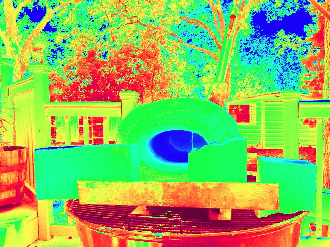

ede Posted September 7, 2017 Share Posted September 7, 2017 Here's some photos from earlier this summer. For those wondering if the zirconium kiln wash with bentonite works or not as a high emissive coating. In my case I used bentonite at about 5%-- if i recall correctly--with a zircnium powder mixture. I've also used the zircopax with kaolin as well. The only thing I encountered with both is the way it dries appears like a dried up lake bed. Forge is powdered by a 3/4" Mikey burner. second photo was a heat image done with my iPad. Last photo if I recall was on cool down. Quote Link to comment Share on other sites More sharing options...
Frosty Posted September 7, 2017 Share Posted September 7, 2017 Looks pretty good, especially the psychedelic pic. I see C-O-L-O-R-S ! How wet did you mix the liner? Shrink checking is something that's concerned me. I keep thinking it shouldn't be any damper than absolutely necessary to ram it in. Spreadable like plaster is I'm afraid asking for shrink checking. How'd it hold up after the tests? Frosty The Lucky. Quote Link to comment Share on other sites More sharing options...

ede Posted September 8, 2017 Share Posted September 8, 2017 Well if she had iron like thighs instead of kaleidoscope thighs, the anvil orientation would not have been so much of a problem. Frosty, I don't remember if I buttered the kaowool before applying the zirconium mixture. I know you recommend doing this and plan to add it to my routine. As far as durability, I've been using a friends coal forge at his place as of late since I don't have a shop currently, so could not tell you about overall long term durability. Quote Link to comment Share on other sites More sharing options...
Mikey98118 Posted September 9, 2017 Author Share Posted September 9, 2017 Something that jumps out from these photos, is the unusual temperature gradients within the the Kaowool blanket. Normally, ceramic blanket heats quite evenly. What we get to observe is the effect of heat reflection by re-emission; This works in a synergistic fashion with the insulation to slow heat loss by conduction. Conversely, it shows WHY that is important; to keep the hot face radiating energy back into the forge. Quote Link to comment Share on other sites More sharing options...
