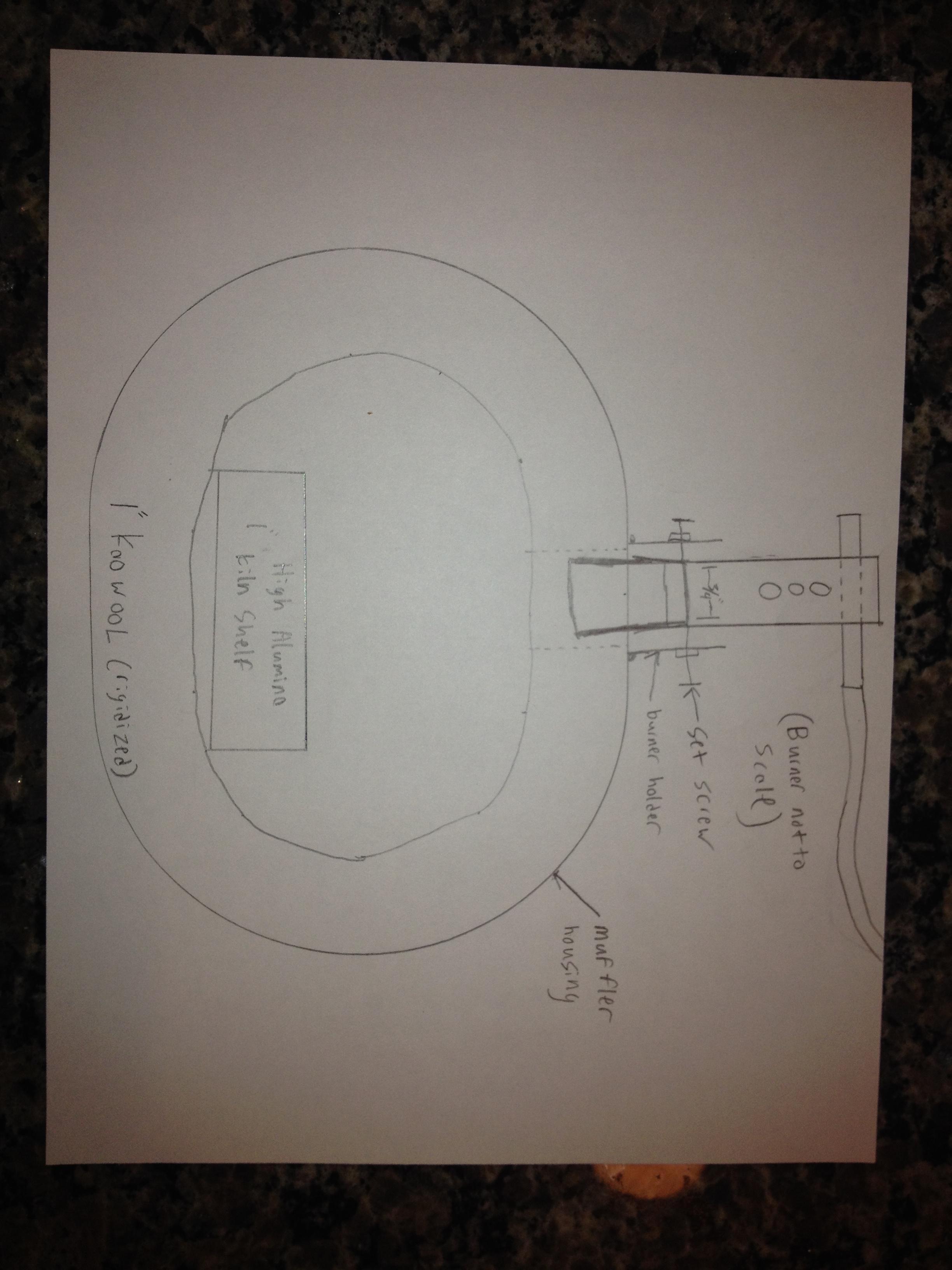

Hey, I have a design here for a muffler forge, everything is labeled.  I am thinking of just rigidizing it for now, then adding refractory and maybe plistix or something when I have the $$.  I am planning on using 1900 F vermiculite board for the ends.  wiIl that melt or something?  I want a small chamber so as not to waste interior space (and thereby heat and fuel) as I only want to forge knives.  the floor will be a high alumina kiln shelf as described.  the burner will be an 3/4" oliver upwind, keith999 had great success with this (ammo can forge thread).  I am wondering whether I should scrap the shell idea and find a balloon helium tank and also if the 2300 F kaowool will degrade in a small forge with so much heat.
thanks
(M)
this is my first forge
the kiln shelf should be 1/4"
Muffler forges are used to come up with a convenient shell to build into an oval forge; such a forge is meant to give a maximum amount of parts space in a small area; this is why the burner is positioned at an angle from one side of the forge; never straight in. Once you re-position the burner, that brick won't work either.
