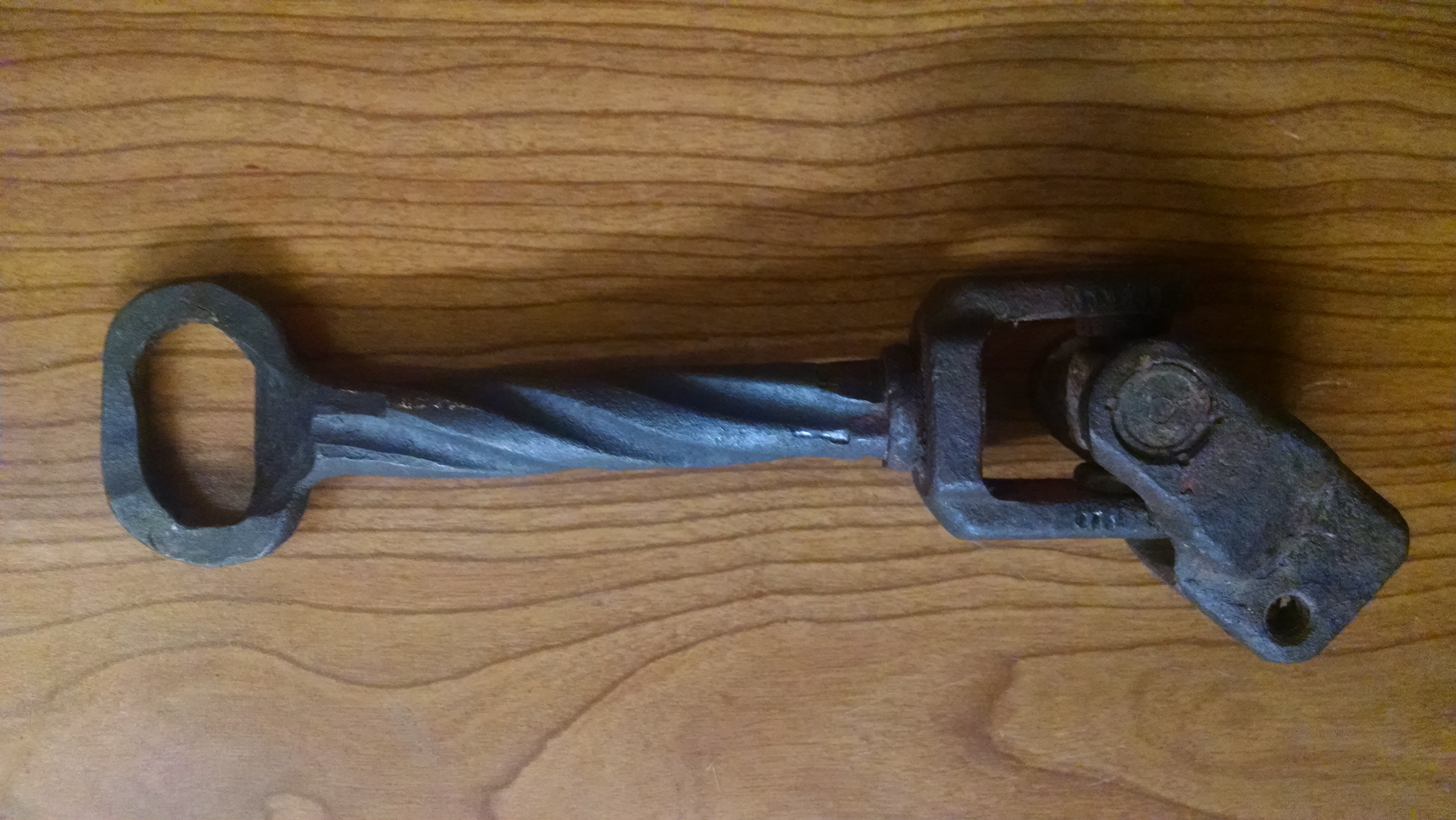

ThomasPowers Posted June 21, 2016 Share Posted June 21, 2016 I found an old unplated wrench and made a bottle opener from it and gave it to my Mechanic---don't know if it ever got used as he has it on display in the office and has thrown open his scrap pile for me in return. As high carbon steel is more expensive to make and work with it tends to be used only where absolutely necessary so knowing what it was is a good start on knowing what it may be made from. Quote Link to comment Share on other sites More sharing options...
JHCC Posted June 21, 2016 Share Posted June 21, 2016 Here's a bottle opener I made for my mechanic from part of a collapsible steering column. He now calls me whenever he has something he thinks I'd like, and I have more scrap than I know what to do with. Quote Link to comment Share on other sites More sharing options...
