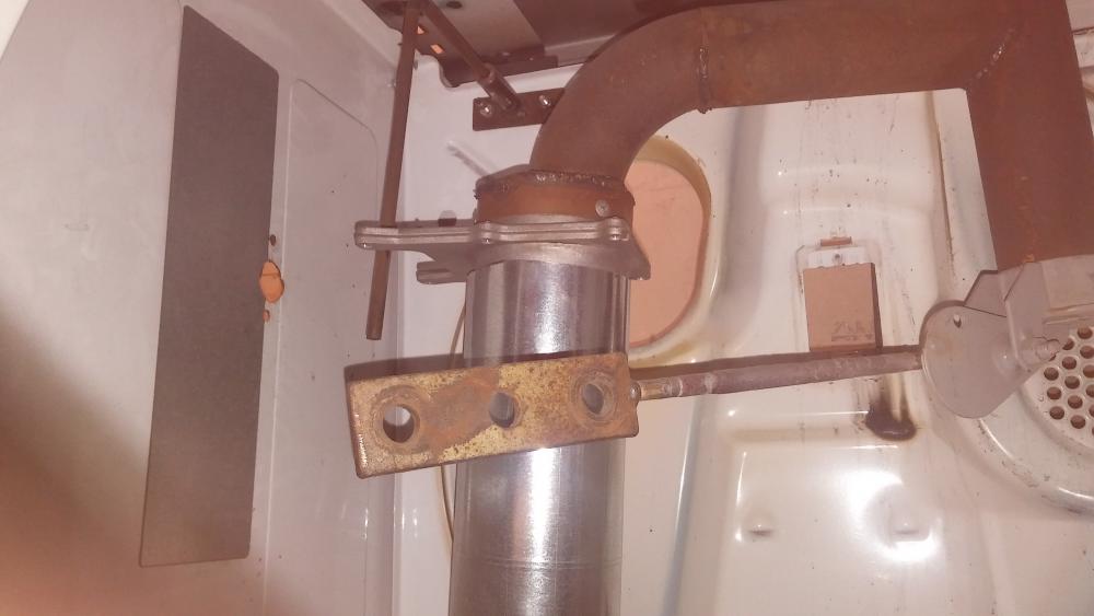

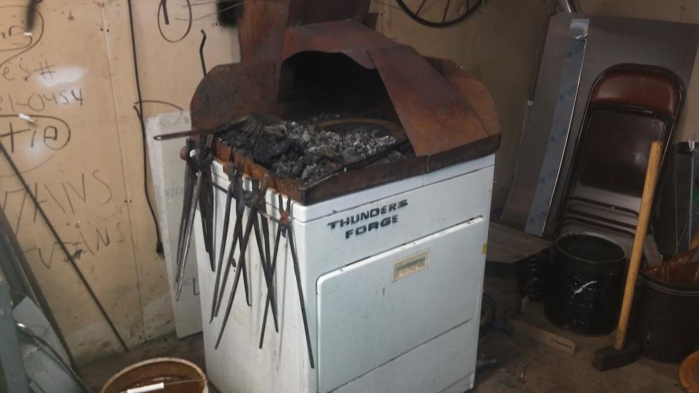

Kevin Olson Posted June 12, 2016 Share Posted June 12, 2016 You only need constant airflow for anthracite coal but only a little bit at idle. Bituminus need no air between heats. Heres a pic of my clothes dryer forge. You can find them free on CL and most of the time the fan still works. With a little dryer ducting and a sliding airgate this is what you get Quote Link to comment Share on other sites More sharing options...
