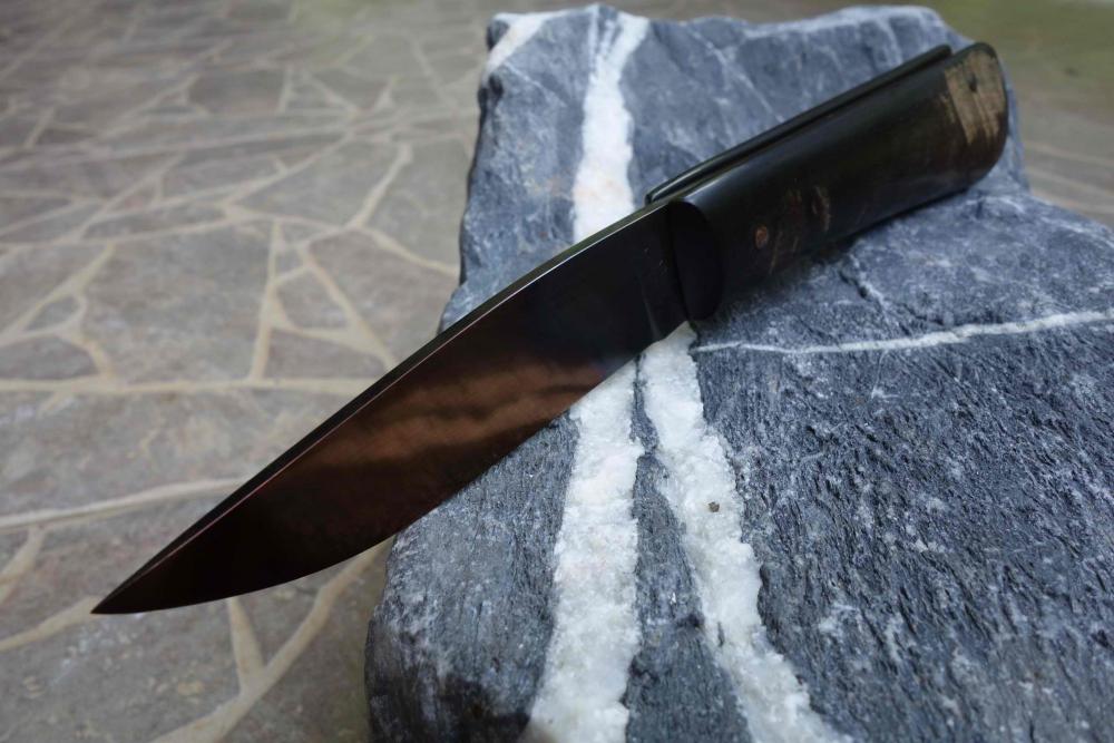

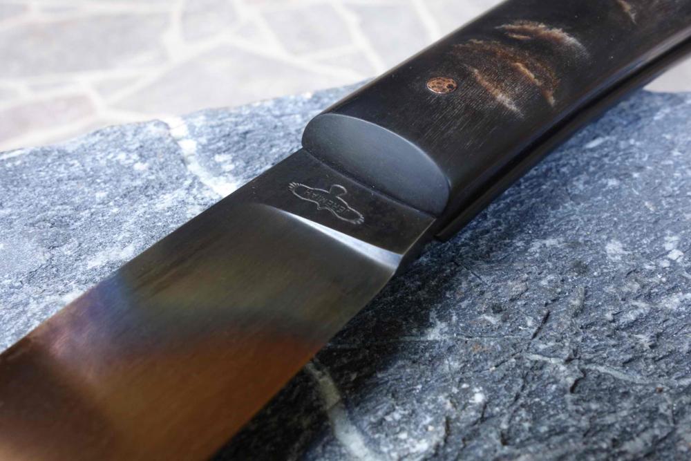

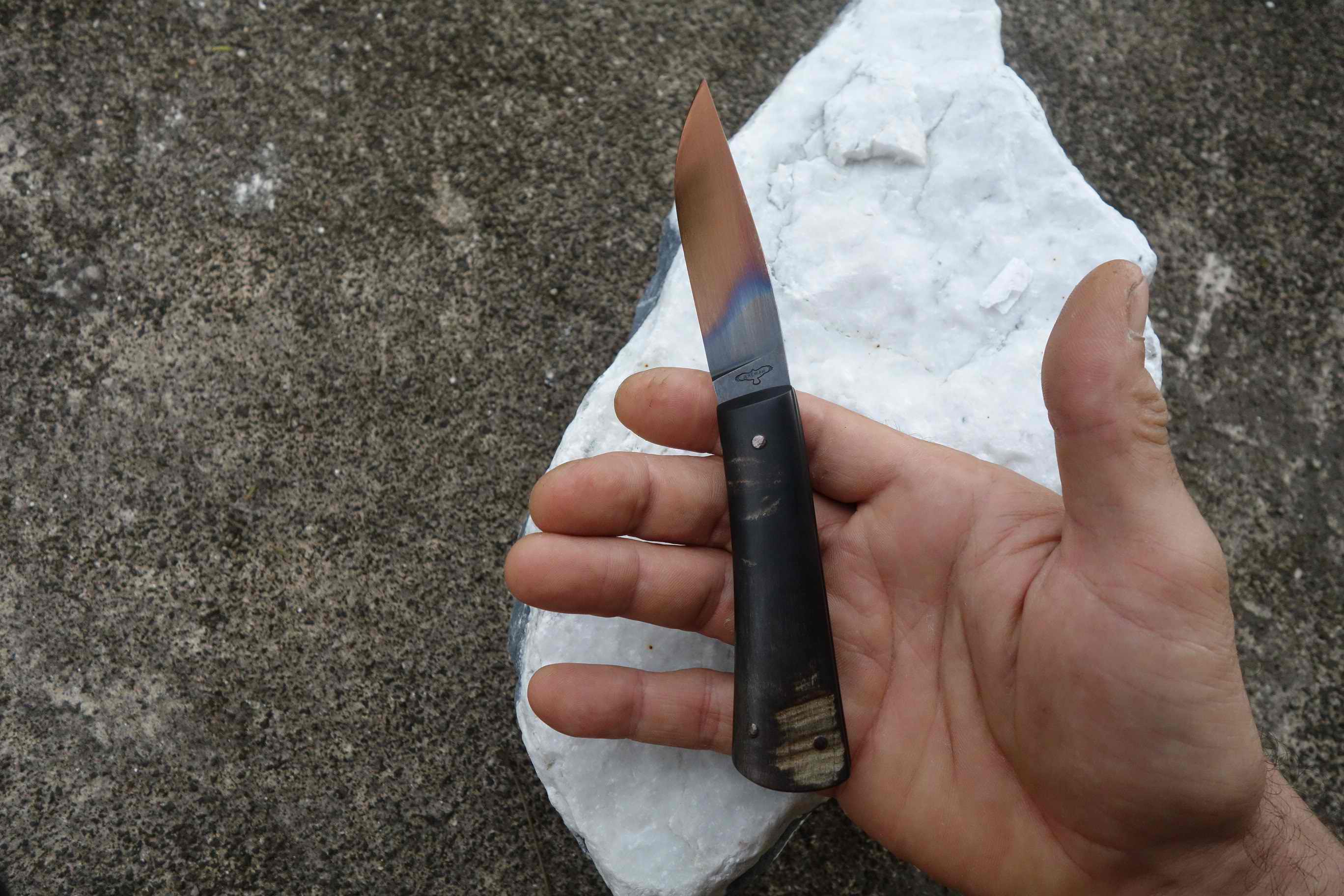

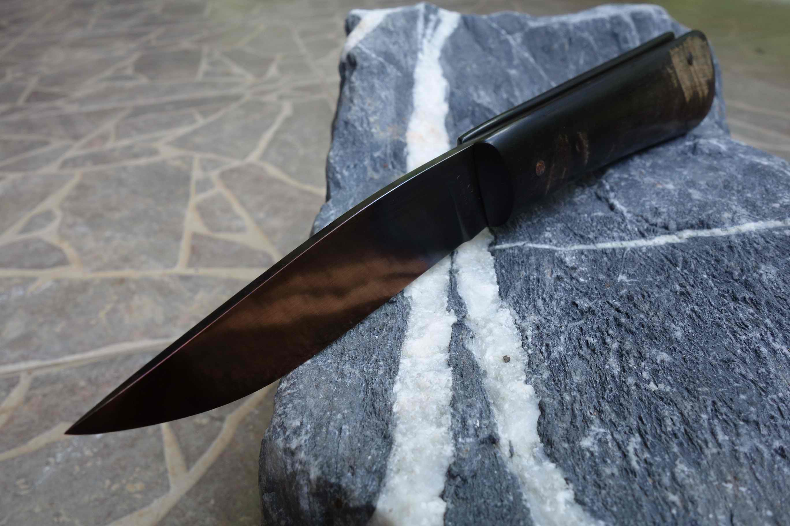

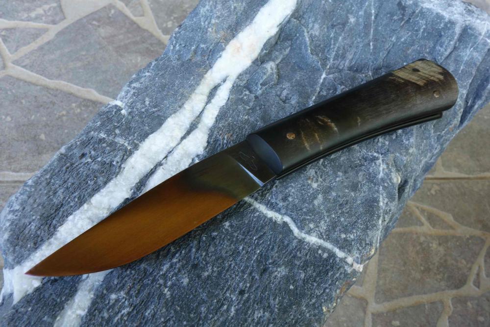

templehound Posted June 12, 2016 Share Posted June 12, 2016 A small utility knife forged from OW1(1.2516, 120WV4) round bar, with Ibex(capricorn) horn slabs, copper pinned and an overall length of 185 mm. This steel is about 100 years in use and it is such a great stuff to make excellent blades.Forges and welds very easy(actually a waste in a damascus billet)grinds and finishes also with very less effort....very good edge holding and easy to sharpen.....http://www.metalravne.com/steelselector/steels/OW1.html....simply a joy to work with. Cheers Link to comment Share on other sites More sharing options...
7A749 Posted June 12, 2016 Share Posted June 12, 2016 I'm just blown away with the quality of workmanship I've seen since joining here. Thats a wicked nice blade. Link to comment Share on other sites More sharing options...
mitch4ging Posted June 13, 2016 Share Posted June 13, 2016 Beautiful little knife! I really like the shaping of your scales! Nice flow over the whole knife. Great job! Link to comment Share on other sites More sharing options...
bigfootnampa Posted June 13, 2016 Share Posted June 13, 2016 Beautiful! I appreciate your elegantly simple style! The ibex horn is very interesting to look upon! Each piece that you've posted pictures of has impressed me! Fantastic work! Link to comment Share on other sites More sharing options...
