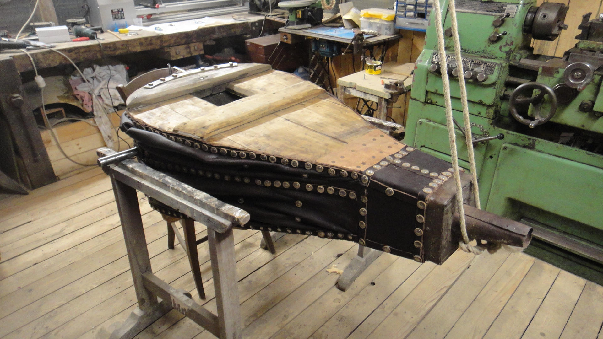

ThomasPowers Posted June 5, 2016 Share Posted June 5, 2016 Lovely article in "nature" on the Monsoon powered bloomeries of Ceylon (Taprobane). They were designed so that the prevailing stead 40 MPH winds would pull the air through the charge. (Interesting math describing how the effect of the wind going across the specially shaped top opening was several times stronger than the effect of the wind blowing against the holes in the base of the bloomery. http://www.nature.com/nature/journal/v379/n6560/abs/379060a0.html Also tall shaft bloomeries built into hillsides could get enough chimney effect to work. BTW WHO SAID BELLOWS HAVE TO BE MADE FROM LEATHER? I used a superb double lung bellows made from heavily treated canvass used in the oil patch to make wind wings for drilling rigs. Lasted over 20 years and I could pump my forge to welding temps with my pinkie. IIRC Biringuccio in the Pirotechnia (1500's) mentions using canvas for bellows. And of course as mentioned the chinese box bellows requires no leather to make. It looks like you are trying to make it as impossible as possible for yourself. May I suggest you learn the process first and then branch into doing it per earlier historical methods. I've been part of a crew doing a Y1K short stack scandinavian bloomery digging the clay from the creek It took several years of experiments before we got good results---15 pound blooms in a human powered bloomery. The leaders presented on their then 10 years of experiments at the Iron Masters Conference held in Athens OH 15+? years ago "The Mastery and Uses of Fire in Antiquity" Rehder, has plans for a "foolproof "modern" bloomery in it's appendices Link to comment Share on other sites More sharing options...

natkova Posted August 12, 2016 Share Posted August 12, 2016 Double lung bellows are nice but you can't build it from everything i think you could but naah. Don't do it it will just make you sad. And build it when you have space time money. Since i come from old Country wich is bridge off East and West i can teach you how things are mixed in here i mean blacksmithing, Turkish adzze Hungarian Bellows, and other tools that are too old for some part of World. They are rare here but drawings and ideas traditions are not. Link to comment Share on other sites More sharing options...
natkova Posted August 12, 2016 Share Posted August 12, 2016 Every nation in Europe have their own stly how bellows are made France have different than Austro Hungay Germany different Russia. Some have box nozzle , and yes North Europe country have their on stlye. South Europe different, Britain. I studied them for 2 years. You just need to google war forge for example some century i mean Usa have it Colonial, France Napoleonic wars, wars are important at forge casue it is fast solution to find it. I mean traveling foge i don't know in english how they are called "Field forge" i think go to google translate try German Blasebalg, try other lenguages in google search for more informations. Example France i had drawings of "Soufflet but i lost it. Link to comment Share on other sites More sharing options...
