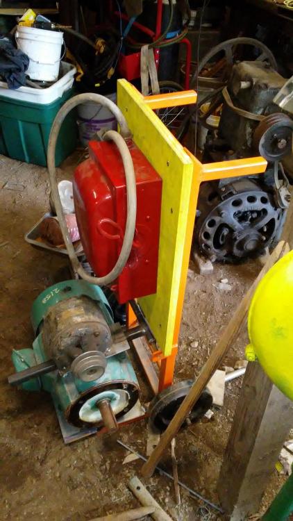

BIGGUNDOCTOR Posted May 30, 2016 Share Posted May 30, 2016 ARCO Roto-Phase is the company that made mine. It will start up to a 15hp, and run a combined 60. I never hooked it up, as I just used a second 3 ph motor and wired through it to run my Monarch lathe, surface grinder,and milling machine.. That convertor used was $1,300, new it was $4,200 and designed for CNC's. I have a 650A Miller MP65-E MIG that is 3ph, and that convertor would give me 50% output. I can get 480 3ph run across the street to may property for $12,000. $7,000 of that is the 75kva transformer. Link to comment Share on other sites More sharing options...
