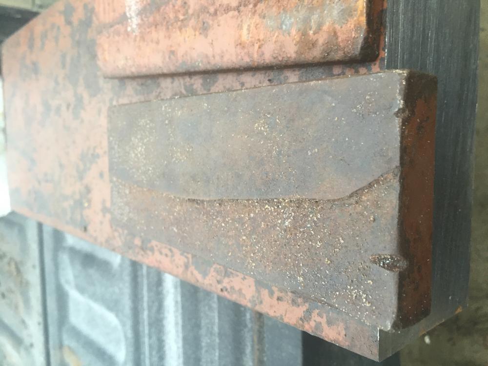

At the community college I took my smithing classes at they used some dozer blade for anvil tops.
On 5/22/2016 at 1:52 AM, BIGGUNDOCTOR said:
The plates with the holes can be used as a bender. Make some shouldered pins that you can drop in at different spacing to get different radii. Place the part between the pins and bend it around .
I was considering making a piece from one of the cutting edges into the top of my anvil but I think I'll wait to do that until after I get some time to have some one on one with Frosty.

In other news, I got my anvil cut flat last night!!! Thank god for friends/former bosses with access to a horizontal bandsaw!:lol:
