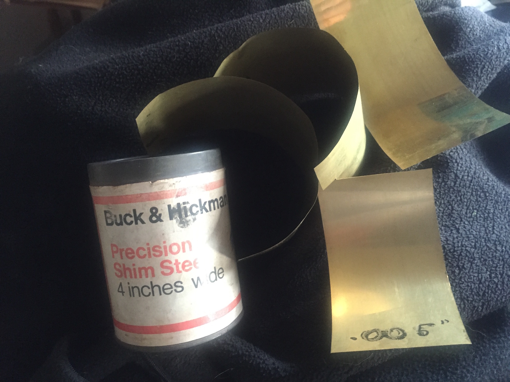

Alan Evans Posted May 12, 2016 Share Posted May 12, 2016 If you don't fancy hammering them out, you will probably be able to get the Beryllium Copper in strip form to the thickness you want. I still have a couple of old 1lb tins of Buck and Hickman Shim Brass and Shim Steel at set thicknesses. Thickest brass I have is 0.005" You will have an equivalent over there I am sure. Just noticed in your OP you referred to it as ".005 mil copper" rather than 0.005" which would be thousands of an inch...are you this side of the Atlantic perchance? Alan Link to comment Share on other sites More sharing options...

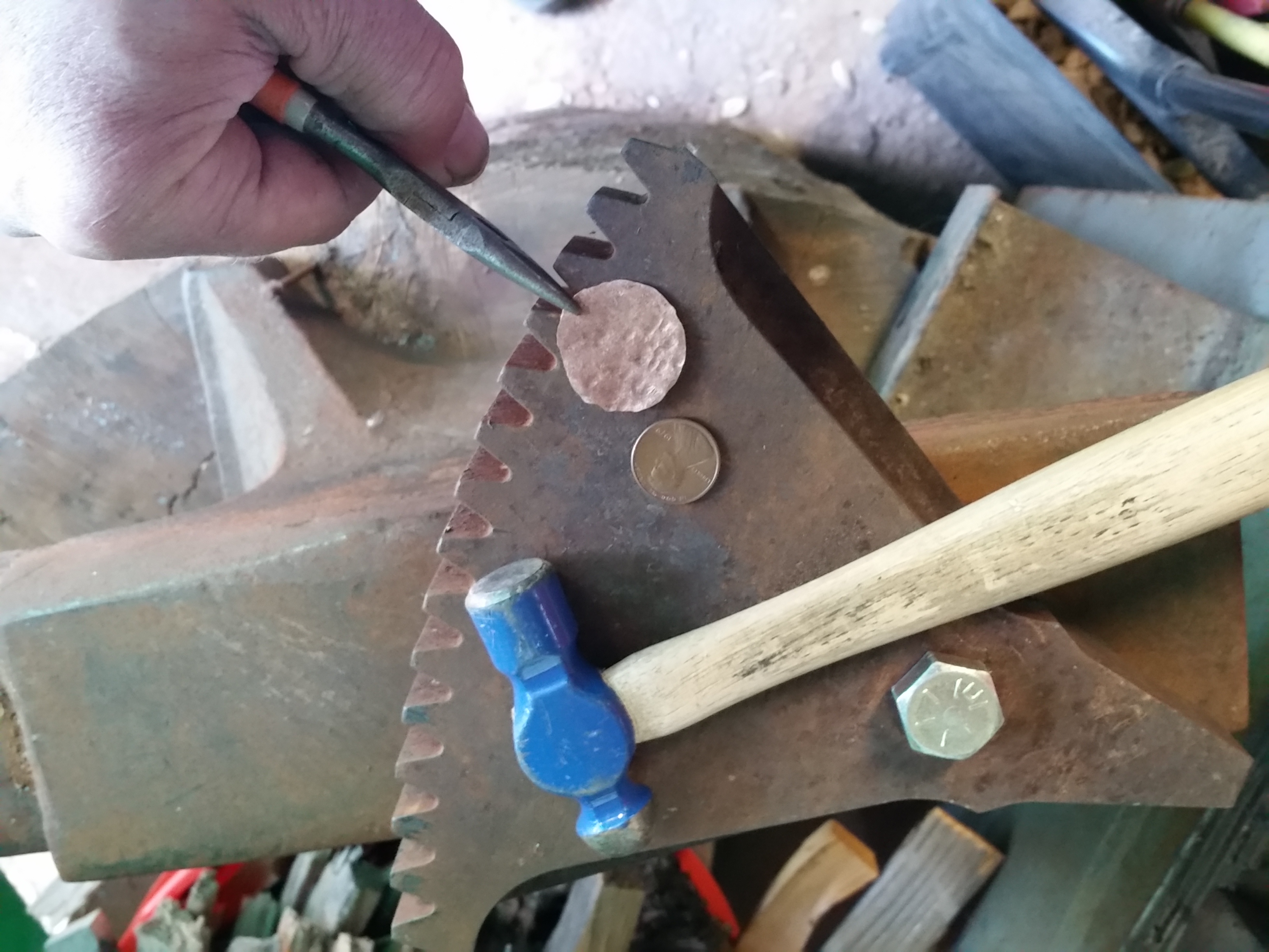

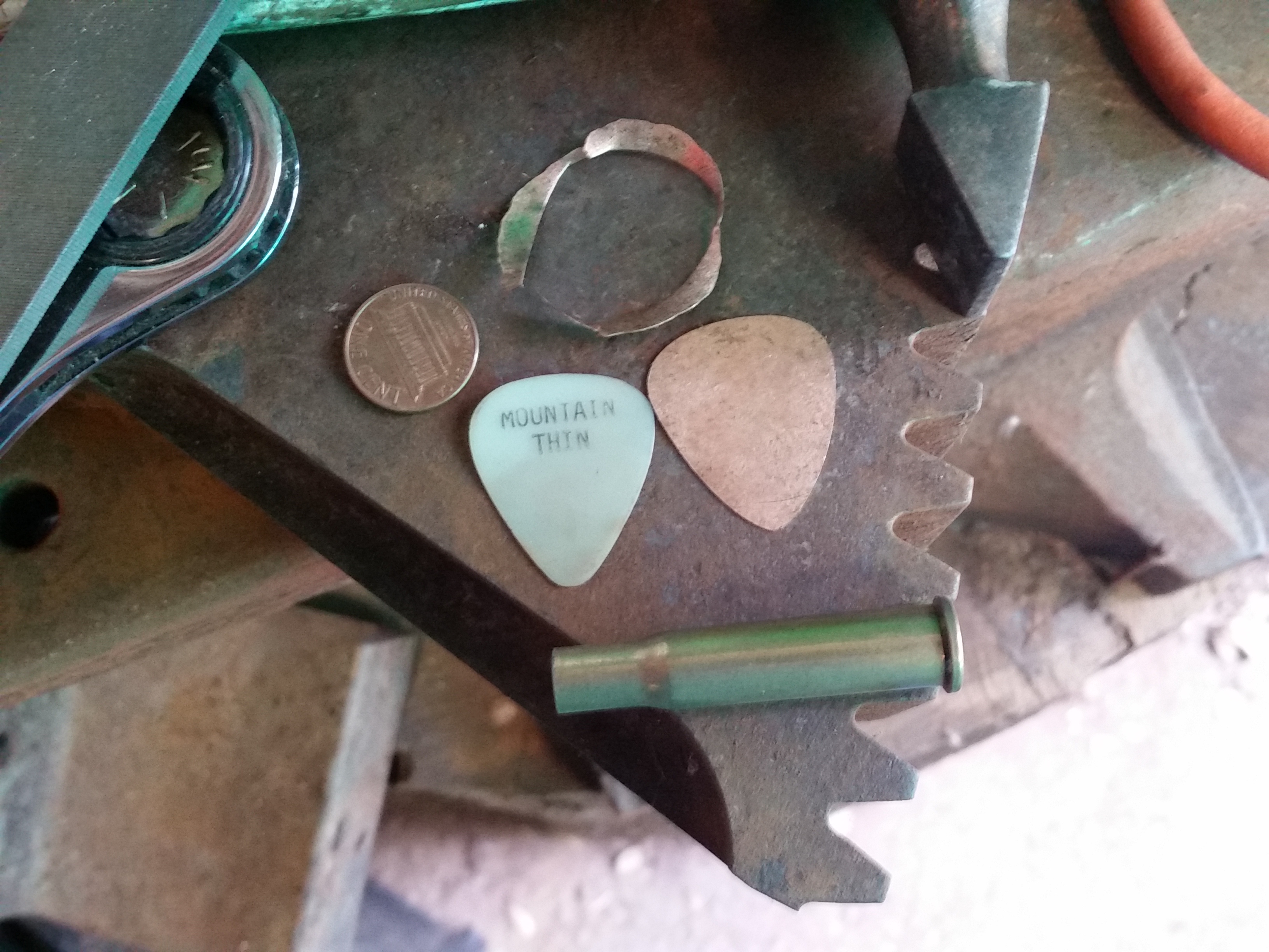

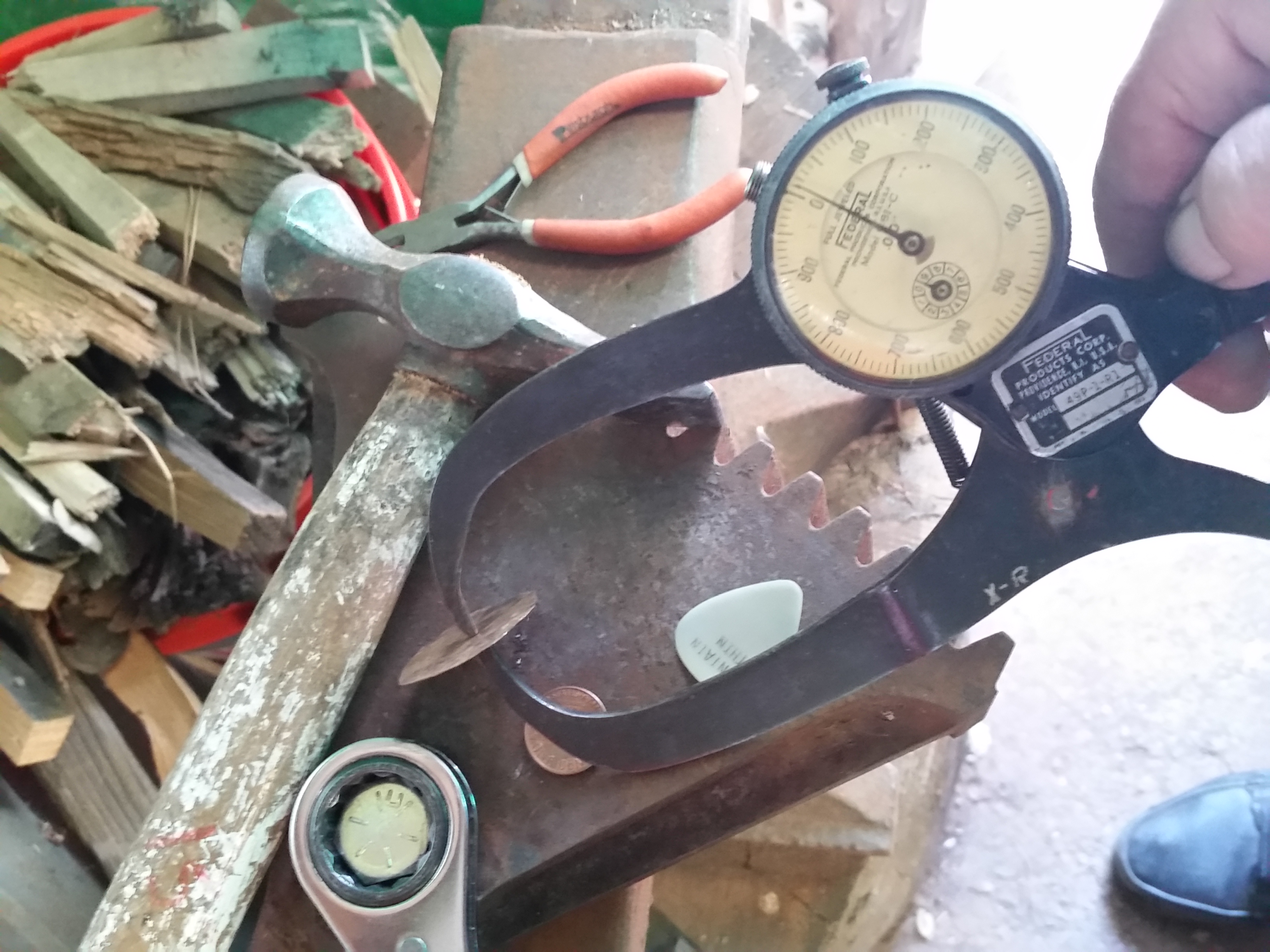

Anachronist58 Posted May 23, 2016 Share Posted May 23, 2016 Ok, so I decided I'd better show something for my previous lip service: This copper gets hard really fast. Then at about < .010, this really start to slow down, and I had to watch the corner of my hammer - any sharp crease wants to propagate a crack. Next will be some 30-30 Win: the cartridge will unroll to bigger than pick size, but will still need to be thinned. Oh my gosh, I never get to make anything (no scale on THIS anvil), and it makes me crazy! I'm sure I am not alone. Robert Taylor Link to comment Share on other sites More sharing options...
Alan Evans Posted May 23, 2016 Share Posted May 23, 2016 Don't forget...I advised you to sand and polish your anvil block and hammer faces to mirror finish...the imperfections in their surfaces are transposed to the workpiece. When you are only dealing with between 0.005-0.010" a blemish of even 0.001" will make a difference to the plectrum. I would also ensure you soften the edges of the hammer faces and put a very slight crown on them so you do not get any dents. If you lightly abrade the surface of the workpiece with some 600grit wet and dry or scotchbrite (or even just dunk it in vinegar or citric acid coca cola or whatever for a few minutes) you will then be able to trace your hammer blows and ensure you planish the whole surface evenly with slightly overlapping blows. Glad you have a source of cartridge brass...when you cut the cartridge up don't cut it down to plectrum size/shape...work it as is which will give you a handle/holding point...only cut the plectrum out when down to thickness. Alan Link to comment Share on other sites More sharing options...
Anachronist58 Posted May 24, 2016 Share Posted May 24, 2016 Alan Evans, All good advice and duly noted. There is actually a 32 micro inch ground finish under that 63 finish rust patina on the anvil block. I work around 4 micro inch finishes for a living, so I am on your page. All of those surface texture and hammer face refinements will have to wait, as I am already stealing time just to get in a bit of hammering. I skid my plannishing blows, and that makes up for some of the poor static texture. I just finished thinning a U.S. nickel, oh what pleasure! Very stiff and hard. I hope to get into some heat treatment, as noted above and elsewhere. The missus needed a new garbage disposal installed six months ago. My in-laws are asking me why I haven't finished the new front stairs. Oh, and the back stairs broke in January. Robert Taylor Link to comment Share on other sites More sharing options...
