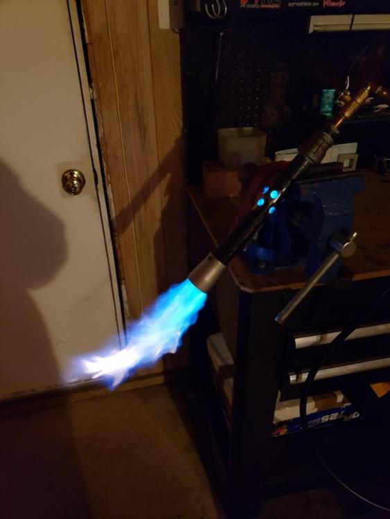

Lee Wehr Posted February 15, 2019 Share Posted February 15, 2019 Not sure which design this is called or who's it follows, but this is what I came up with. All of the brass plumbing is 1/4" leading to black steel reducers up to 1". The SS flair is 1.25" to 1.5". Currently using a .035 MIG tip as I had a bunch of those laying around. Frosty and Mike recommended a .045 tip in another member's post (for a 1" pipe). Will there be a noticeable difference between the two sizes? Using a standard Blue Rhino 15-lb tank and 20psi regulator. Pay no mind to the flames coming out of the breather holes in the photo. That was before I made the choke collar; the video is after. 20190211_210431.mp4 Quote Link to comment Share on other sites More sharing options...
Another FrankenBurner Posted February 15, 2019 Share Posted February 15, 2019 As far as design, the air inlet holes remind me of a Dave Hammer burner and the jet mount system reminds me of a Mikey burner but this burner is a Lee Wehr design. Unless your fuel pressure was lower then you are going to be using normally, the flames visible in the air inlets should be concerning. A choke is used to reduce air induction, not to prevent flames from sucking back. As is, that first image shows a very rich flame which requires more air. The .045 mig tip would make this worse. Be very mindful of carbon monoxide. We all should always, but rich running burners produce more. It is a stealthy danger so adequate attention and ventilation always. Those air inlets are quite forward, towards the flame end, then usual. Typically they are as far back, towards the gas jet end, on the pipe as they can be. Where does the gas jet end in the 1" pipe? I suspect it is quite a ways back behind the air inlets. Quote Link to comment Share on other sites More sharing options...
Lee Wehr Posted February 15, 2019 Share Posted February 15, 2019 1 hour ago, Another FrankenBurner said: As far as design, the air inlet holes remind me of a Dave Hammer burner and the jet mount system reminds me of a Mikey burner but this burner is a Lee Wehr design. Unless your fuel pressure was lower then you are going to be using normally, the flames visible in the air inlets should be concerning. A choke is used to reduce air induction, not to prevent flames from sucking back. As is, that first image shows a very rich flame which requires more air. The .045 mig tip would make this worse. Be very mindful of carbon monoxide. We all should always, but rich running burners produce more. It is a stealthy danger so adequate attention and ventilation always. Those air inlets are quite forward, towards the flame end, then usual. Typically they are as far back, towards the gas jet end, on the pipe as they can be. Where does the gas jet end in the 1" pipe? I suspect it is quite a ways back behind the air inlets. Nice to know I made a one off design. I looked at several since beginning this quest, even almost bought one pre-made, but decided to create my own since my forge in general is of my mind's eye. Should I try going smaller on the MIG tip? I have a couple .025s sitting around. Concur on the ventilation; the back of my garage isnt' the ideal place, but that's where my vise is. Once the forge is up and running, I'll move the whole thing to the shed out back, being able to move it outside when I start forging. The MIG tip is sitting on a 1/4" cap, drilled and threaded to match the lincoln tips, on top a 4" nipple. It rests just about at the end of the first series of holes. I'll have to snap a close up photo and post it when I get home. Quote Link to comment Share on other sites More sharing options...
Mikey98118 Posted February 15, 2019 Author Share Posted February 15, 2019 Go with the smaller MIG tip. I like the tapered flame retention nozzle (AKA flare). You want to go into how you formed it? The one part you can't live with is the mixing tube itself, sorry, but you will have to replace it and start again; next time move the holes further back. The end of your MIG tip should wind up about 1/4" to 3/8" behind the forward edge of the forward most air holes. Do this, and I think that outstanding nozzle will spout a very nice flame Quote Link to comment Share on other sites More sharing options...
Lee Wehr Posted February 15, 2019 Share Posted February 15, 2019 Forming was quite easy actually,... Haha Stainless Steel 304/304L Pipe... Link remoced Understand what you are saying, however, even though the air inlet holes are pretty far forward, the nipple is 4", bringing the MIG tip just right behind them. Still no good you think? Quote Link to comment Share on other sites More sharing options...
Mikey98118 Posted February 15, 2019 Author Share Posted February 15, 2019 With the air holes well forward of the MIG tip's gas stream, you are combing the fuel and air, whithout speeding up the mixture's flow past the speed of the flame front, so it will ALWAYS burn back into the burner. Quote Link to comment Share on other sites More sharing options...
Lee Wehr Posted February 15, 2019 Share Posted February 15, 2019 Just now, Mikey98118 said: With the air holes well forward of the MIG tip's gas stream, you are combing the fuel and air, whithout speeding up the mixture's flow past the speed of the flame front, so it will ALWAYS burn back into the burner. I have some more pipe. Back to the drawing board! Quote Link to comment Share on other sites More sharing options...
Mikey98118 Posted February 15, 2019 Author Share Posted February 15, 2019 Excellent choice to use for a flame retention nozzle BTW. Quote Link to comment Share on other sites More sharing options...

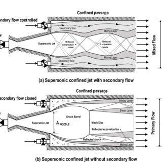

671jungle Posted February 15, 2019 Share Posted February 15, 2019 found these and thought maybe help some visualization on flow dynamics. not sure if they apply being these are supersonic. Illustrative flow field encountered in the supersonic gaseous ejector: (a) with controlled secondary flow and (b) without secondary flow. Some of the basic features of supersonic confined jet is also marked up in the illustration.A typical set of instantaneous schlieren images (non-correlated in time) obtained by varying the operating pressure (P OP ) in the supersonic gaseous ejector for certain conditions. A red-dotted line is added to the image to visually appreciate the change in the wavelength qualitativelyshows the effect of varying the inducted secondary flow qualitatively through the schlieren images. The secondary flow is varied by using a gate valve near the upstream side of the confined passage as shown in Fig.Typical instantaneous Planar Laser Mie Scattering (PLMS) image showing the dominant flow features and image artifacts in supersonic gaseous ejector for certain condition (Conditions: M PD =2.0; SPR=17.42; ω vp-4 =0). The secondary flow is completely cut-off and the ejector is operated in the vacuum mode of operation (nozzle started-diffuser unstarted). Quote Link to comment Share on other sites More sharing options...
Lee Wehr Posted February 15, 2019 Share Posted February 15, 2019 1 minute ago, Mikey98118 said: Excellent choice to use for a flame retention nozzle BTW. Thanks. Maybe a result of what we are already discussing, but I was getting flames creeping up and through the 1/4" gap between the nozzle and mixing tube. Last night I welded it on. Quote Link to comment Share on other sites More sharing options...
Another FrankenBurner Posted February 15, 2019 Share Posted February 15, 2019 1 hour ago, Lee Wehr said: Nice to know I made a one off design. The downside to your own design is that you have to design it. In order to get it working well you have to understand the science happening there, trial and error your way to a working burner, get lucky, or a combination of that. 6 minutes ago, Lee Wehr said: I have some more pipe. Back to the drawing board! I recommend you look into the Mikey burner since you are replacing the tube anyway. Then there is no designing needed. Build it to the recommended specs, tune it, and it works. His design is similar to what you built so the build would be similar. What is this burner's intended purpose? I am just curious because of it's 1 inch size. Quote Link to comment Share on other sites More sharing options...
