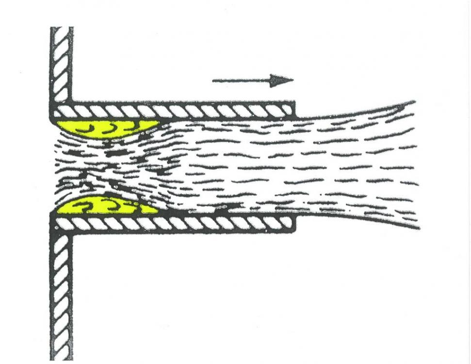

Mesquite0 Posted May 26, 2016 Share Posted May 26, 2016 Bah-da-ba-ba-baaaaah. I'm lovin it you guys! Thank you for spreading the knowledge. Im a total newbie. Been messin around with a bunch if different designs just for fin while i get a forge underway. Just a thought i'd like to throw out there, and it seems you are already touching on it heavily, is that these designs are an expression of fluid dynamics? A heavily studied field. One of the more interesting concepts i've come across is "vena contrata". This is a realized aperture area decrease in relation to the design of its opening due to localized belocity increases around the opening that can be rectified witha "flared" opening. In this meaning the flare is best as a parabola. Check it. i This issue was addressed as "eddies" in the current. I think the visuals help to show what mr. Mikey meant Quote Link to comment Share on other sites More sharing options...
Mikey98118 Posted May 26, 2016 Author Share Posted May 26, 2016 No; a vena contracta might give interesting results if installed at the opening of a compressed air burner body, with a gas jet introduced just beyond it, so that gas/air mixing could benefit from the eddy currents generated by it. In any naturally aspirated are standard fan-blown burner, those eddy currents would interfere far too much with flow to be anything but a burden. Even then, I would only use it to generate flow to a ribbon burner's head, since this is the only kind of burner that both makes compact flames and benefits from posotive pressure in the mixture flow; all others require a low pressure high speed flow. Quote Link to comment Share on other sites More sharing options...
Mesquite0 Posted May 28, 2016 Share Posted May 28, 2016 Oh. Ok. Thats interesting how that works. I had looked into this when designing a shops ventilation system. It was particulqrly interesting that the given flow of a ventilation system would be effected (upwards of 15% loss of airflow) based just on the design of the intake manifold. I was bringing this point up because i thought some problems folks are having problems might be related to the smoothness of transitions. Little bumps or restrictions that would be easy to brush off might be having a larger detriment on the shstem. So these eddies are generated leas in a jet induction system vs a forced air scenario? Thanks for all of your hard work! I am new to this hobby/proffesion (depends on the individual) and i am so thankful and impressed how all of you folks share your knowledge so freely!! Quote Link to comment Share on other sites More sharing options...
Mikey98118 Posted June 1, 2016 Author Share Posted June 1, 2016 Eddy currents are mostly made by complete innocents of what generates them, such as round shaped air openings (not to mention whole fields of them). Surprisingly. lips and threads from pipe fittings have a much smaller negative impact; not that I approve of them either, but it is difficult to argue with success. And there are plenty of sloppy burners around that are successful... Quote Link to comment Share on other sites More sharing options...
