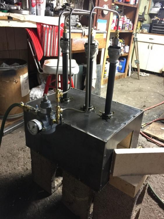

Jbradshaw Posted May 19, 2017 Share Posted May 19, 2017 Here's a 3/4" Mikey burner I just finished up. Photo taken about 2 minutes into the first test fire on10 psi with a 0.030 tip. This weekend I'll try to get some pics of the Frosty T and Dave Hammer burners that I built previously and post them all up. Quote Link to comment Share on other sites More sharing options...
Mikey98118 Posted May 19, 2017 Author Share Posted May 19, 2017 I think it could use a little more tuning. A smorgasbord of burner ideas, both good and very very bad: https://www.pinterest.com/dmasontov/venturi-burners/ Quote Link to comment Share on other sites More sharing options...
Jbradshaw Posted May 19, 2017 Share Posted May 19, 2017 Can you explain what it is you see in this pic that tells you it needs more tuning? I have some ideas, but would like to understand better. I plan on changing out the tip to a 0.035 tonight to see how that effects things before making any more permanent changes. Quote Link to comment Share on other sites More sharing options...
Mikey98118 Posted May 19, 2017 Author Share Posted May 19, 2017 First, please understand that what I do not see is a weak flame. You could mount this burner ,as is, in a forge, and make the equipment quite hot, BUT it would create a lot of scale on your work, because its long secondary flame contains a lot of free oxygen, which will reach your parts before being consumed; some of that free super-heated oxygen will combine in the heating steel to quickly form scale. Going from bottom to top in your photo: First, I see a flame nozzle with an ORANGE end, rather than merely RED end. Burning propane can only get a flame nozzle to orange incandescence , in the open air; this is the first indication or a very hot flame. Next, comes the base of the flame; what should be a single primary flame of blue, instead it has four zones of combustion. The mostly white area is probably from the combustion of carbon. Carbon can only come from from deterioration of the propane molecules. I suspect that the propane and air isn't leaving that very hot nozzle area quite fast enough to prevent carbon from forming. You will note some blue with just a touch of green in it for a short distance before it thin out to only a thin "skin" on most of the periphery of the flame, and then thickens again at the iip of the flame envelope; this area is what used to be thought as a neutral flame by most people, but is actually a little reducing. Third, we see a pure blue area at the tip of the flame, just beyond the blue-green reducing flame front; take a good long look at this flame area, because that is a truly neutral flame; this zone is what you want to have in the whole flame. Fourth we see the area usually described as "secondary flame". Note that it is purple. I think this is do to an abundance of super-heated oxygen, which escaped the so called "primary" flame. Again, you need to understand that, while this may seem complicated and ominous, the answer to this puzzle is straightforward. Everything we are seeing is the result of gas/air mixture speed as it enters the flame nozzle versus breaking effect by the nozzle. You may need to raise gas pressure into the burner, and shorten the amount of overhang, to prevent the faster flame front from blowing right off the end of the burner. I would begin by shortening the amount of overhang between the end of the flame nozzle and the end of the mixing tube. You also need to make sure that the diameter of the nozzle is correct for the burner size. The orifice diameter of the gas jet (MIG contact tip) needs to be right for the burner size. In the book I recommended both MIG tips for .023" and .030" welding wire; this is because the smaller tip is just a little too small and the 030" tip is just a little too large. I advised readers who wanted a perfectly performing burner to use the smaller tip, and use torch tip cleaners to enlarge it a thousandth or two at a time, on till satisfied. The orifice size of the gas jet much match up properly to the inside diameter of the tube. You seem to have used tubing, rather schedule #40 water pipe; this is likely to change the inside diameter of your burner from that of the pipe that jet is effecting; that could end up good or bad; what we can say for sure is that it can't be predicted. Finally, my burners are set up so that you can move the gas jet back and forth in the area of the air openings to 'find the sweet spot". he burner is provided with set screws to allow the builder to make sure the gas tube is kept parallel to the burner's axis; if it isn't, or if the MIG tip isn't kept parallel to the gas tube, the flame can be partially or completely destabilized. What you are trying for is a solid blue flame front with a rear side that is a cone shaped empty area. There should, ideally, be no secondary flame at all; this ideal is possible, but not practical. A wisp of secondary flame is feasible and will vanish in a heated forge, where the flame will turn light blue, and elongate into a blade shape. What else do you need to watch for? Wants you get your burner built and tuned up to a single zone of combustion, the only thing left that can go wrong is opening up the sliding choke too much; then the flame will become a darker blue, indicating excess oxygen. I once had a burner that I could open up so far that the flame turned purple, indicating that it was totally oxidizing. This is a serious problem. Once we make the magic flame our Mad Scientist can come out, causing us to laugh insanely and burn a lot of steel; naughty, naughty! What we need to do is pay careful attention to what we are seeing in the flame, so as to prevent the nut behind the wheel from running our car into the ditch. How would I no this? Dr. Frankenburner laughed madly and played in my garage for months... Quote Link to comment Share on other sites More sharing options...

Jbradshaw Posted May 19, 2017 Share Posted May 19, 2017 Thanks for the detailed feedback. I really appreciate the break down of the different zones of the flame. A couple clarifications of things from my end. This is a 3/4" burner (I am assuming you think it is a 1/2" burner based on the comments about orifice size). I did use stainless steel tubing for the flame nozzle (1 5/16" ID 304L, the 316 was more than twice the cost so even if it lasts longer it would take me burning through 8 of the 304 flame nozzles to catch up with me financially). After I posted the photo I realized that I forgot to do any adjustment of the flame nozzle overhang. I will play with that first and then try a different size MIG tip. Quote Link to comment Share on other sites More sharing options...

Mikey98118 Posted May 20, 2017 Author Share Posted May 20, 2017 Stockmaker asks "Shouldn't the adjustments you suggest be performed when the burner is insides the forge? Maybe a better question is what do you suggest be done prior to mounting in the forge and what adjustments be done after. " There is a burner flame, and a forge atmosphere/flame/environment ; these two intertwining, yet separate things, interact. Sometimes they must be considered separately, and at other times, they must be considered together. Furthermore how often they can simply be considered together depends heavily on the burner. Every burner needs to be tuned to some extent; some of them to a great extent. Also, if the burner has been set up to run only within a piece of heating equipment, it can't be tuned out in the ambient atmosphere of the shop, if it has no flame nozzle, it must be tune out in the open, at least the first time. Every burner I design, is meant to be tuned out in the open; once it is so tuned and mounted, the choke setting and needle valve and/or regulator setting on the gas pipe are all that can be changed within a forge or casting furnace. I design burners for maximum performance; this requires as many adjustments as possible to get the flame just right; trying to do all that inside heading equipment would be going about the task the hard way. Other burners call for other procedures. jbradshaw, I gave you the right MIG tips for a 3/4" burner. If you have my book or download a pirate copy, you can see it listed in the chart on page 22. A MIG tip for .023" is also listed in that chart for 1/2" burners, but only because there is no such thing a a smaller MIG tip; not because it has an ideal orifice diameter. Quote Link to comment Share on other sites More sharing options...
Mikey98118 Posted May 20, 2017 Author Share Posted May 20, 2017 blacksmith-450 writes " I have a hard time accepting (understanding) that there is as much adjustment for a burner that has 3-4 parts only. " Unless you build one, you are doomed to go right on having a hard time understanding them. You also write " Running too rich brings a lower temperature, more CO and... ? " And a longer flame; sometimes a lot longer flame, depending. That should have read "... if it has a flame nozzle, it must be tune out in the open, at least the first time. Quote Link to comment Share on other sites More sharing options...

Jbradshaw Posted May 24, 2017 Share Posted May 24, 2017 Mikey comment away. Anything I can learn to improve my skill set is a positive to me. Here is the burner pictured above after minor tuning, same light (LED shop light on the other end of the one car garage and an overhead 100w incandescent bulb), same camera (iPhone 6). I moved the flame nozzle back from about 1&1/2" overhang to about 1&1/8" overhang. This is held in place with set screws so is very quick and easy to adjust. The other change was I small movement of the accelerator tube. This is held in place by a single collet nut. So loosen and then tighten the nut back up. The flame is more blue to my eyes than this photo shows. Quote Link to comment Share on other sites More sharing options...
Mikey98118 Posted May 25, 2017 Author Share Posted May 25, 2017 Okay, what I'm seeing is a slightly reducing flame, that is almost correct. How can you tell this? Compare its tinge of green in the primary flame, with the perfect blue color around the flame's periphery, which turns into a short secondary flame on its tip. I would suggest that you drop down to the next smaller MIG tip diameter; when you do, don't be surprise if you need to lengthen the amount of nozzle overhang again. You are VERY close now. Quote Link to comment Share on other sites More sharing options...
