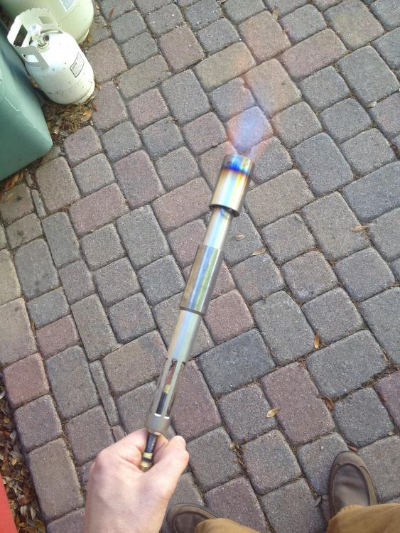

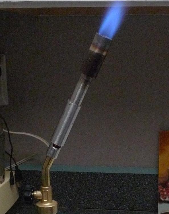

Mikey98118 Posted March 16, 2017 Author Share Posted March 16, 2017 Above is a photo of a canister-mount 3/8" Mikey burner. You can see it is choked back severely; this is because it was just ignited. and was still running cold. Once fully heated the flame nozzle turns orange, and the flame can be turned up more than twice that high. and much faster running. The main point is that this burner, and others, can be canister mounted or mounted on the end of a special extension hose for use in really small forges, as the burner portion is stainless steel, and can be placed inside of a sealed burner portal, to attain very high temperatures. Quote Link to comment Share on other sites More sharing options...
Mikey98118 Posted March 16, 2017 Author Share Posted March 16, 2017 Note the flame color has no tinge of green in it; there is no white segment in the flame, and no secondary flame. This is complete combustion in a neutral primary flame. Quote Link to comment Share on other sites More sharing options...
Jbradshaw Posted March 16, 2017 Share Posted March 16, 2017 The idea of repurposing a plumbers torch this way is very interesting to me. Did you cut of the rest of the original torch tube? Did you use the original orifice as the jet? Or retrofit a capillary tube as described in the previous post? Also it appears that the hole is beveled on the outside, rather than on the inside. If this is true I must have misunderstood your book. I thought the air holes were supposed to be beveled on the inside of the mixing tube (good thing I haven't gotten to that part of my burner build yet). Quote Link to comment Share on other sites More sharing options...
Mikey98118 Posted March 16, 2017 Author Share Posted March 16, 2017 The rest of the original torch tube is cut away except for about 1/2" of threaded portion, which is press fit into the the stainless steel mixing tube, so that it can be screwed back onto the bottom portion of the original torch (goose neck, needle valve, etc.). The original gas jet is tossed away. A short bit of .023" I.D. capillary tube is press fit into a MIG contact tip, and the tip is threaded into the end of the goose neck ((old gas tube). The bottoms of the three rectangular air openings are beveled on the outside; the tops the those air openings are beveled on the inside, as per the book. Quote Link to comment Share on other sites More sharing options...
Mikey98118 Posted March 16, 2017 Author Share Posted March 16, 2017 One of the things I like about using a canister-mount torch this way is the needle valves on them (I have purchased several of them for study) all have exceptional valve seats, every one of which close completely; this is far from a given with needle valves on pipe fittings these days. Considering that the torch costs less money than the average needle valve, I consider them bargain basement priced parts for re-purposing. Quote Link to comment Share on other sites More sharing options...
ede Posted March 16, 2017 Share Posted March 16, 2017 Here's one that I made recently that is a 3/4" Mikey Burner. It has an interesting orange streak around the flame. Quote Link to comment Share on other sites More sharing options...
Mikey98118 Posted March 16, 2017 Author Share Posted March 16, 2017 A fine running burner! I am very sure the orange streak is from oxidation of the flame nozzle; I have seen this non-problem crop up in burners here and there over the years. Quote Link to comment Share on other sites More sharing options...
Mikey98118 Posted March 17, 2017 Author Share Posted March 17, 2017 Please note that the apparently lighter blue of the 3/4" burner in the second and third photos are actually the same tint of blue flame; only it is seen in brighter light. Propylene gas actually makes a lighter blue than propylene flame in the same light; but not much lighter. Quote Link to comment Share on other sites More sharing options...
