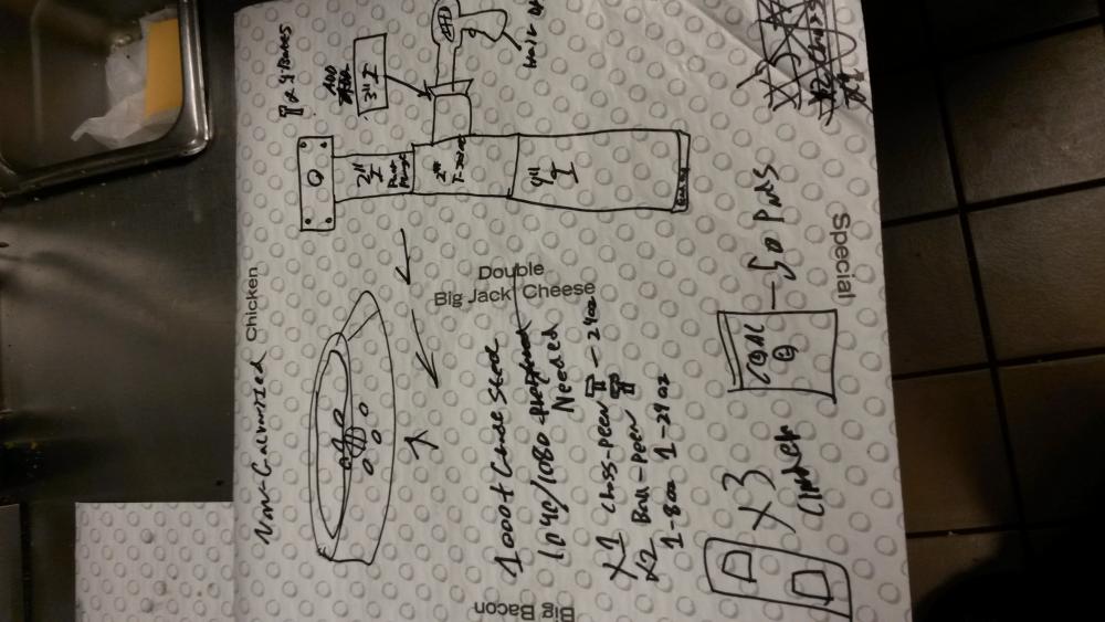

AlabamaAmatuer Posted May 7, 2016 Share Posted May 7, 2016 Hi all, I'm in the middle of building my first forge and getting my tools together. I have my hammers, my Brake-Drum, Concrete blocks, and an around 1 foot diameter, 6 inch thick piece of hardened steel that's a lot heavier than 30 pounds, to use as my Anvil. I still need my pipes, hairdryer, Coal, and Tongs. now that, is wherein lies my dilemma, I have read, and watched how to make, the tongs, but I have not a clue what to buy (or rather scavenge, I'm not broke but I'm not rich, just a High School Senior working a fast-food job till college) in the way of metal bars or "repatriated materials". Any help is appreciated, I'm looking for tips on places to find material especially, and if you're in Alabama, and have any techniques or spare/old tools you want to sell or throw out, let me know. I am in Ashville, Alabama. Quote Link to comment Share on other sites More sharing options...

AlabamaAmatuer Posted May 7, 2016 Author Share Posted May 7, 2016 Thanks Curmudgeon man and Admin, If I am to use my Brake Drum (or, Two, as they basically just wanted to get them out of their scrap pile at the Autobody shop) how would I do so? I cant really find anything except monstrous forges online, and this isn't something I am setting up permanently, It's something I want to set up and take down after I'm done. Unless, I wonder if I can do that sort of thing but with an Dakota Fire hole?? and a brake drum down in the hole? Quote Link to comment Share on other sites More sharing options...

Glenn Posted May 7, 2016 Share Posted May 7, 2016 At this point may I suggest you read the forges > solid fuel section of the site. There are many discussions there on setting things up. Simple answer is to build a side blast forge as described above. One pipe and your operational. Leave an air gap between the hair dryer and the pipe in order to control the air blast to the forge. Also look at the 55 Forge set up and modify it to your needs. This is nothing more than a piece of auto exhaust pipe put through a piece of plate steel in the bottom of a brake drum. The 1/4 inch round bars stick out past the exhaust pipe to keep it from falling through the hole. Yes, it works. Quote Link to comment Share on other sites More sharing options...

AlabamaAmatuer Posted May 7, 2016 Author Share Posted May 7, 2016 Alright cool, so I drew these plans up at work, I have bad handwriting Quote Link to comment Share on other sites More sharing options...
