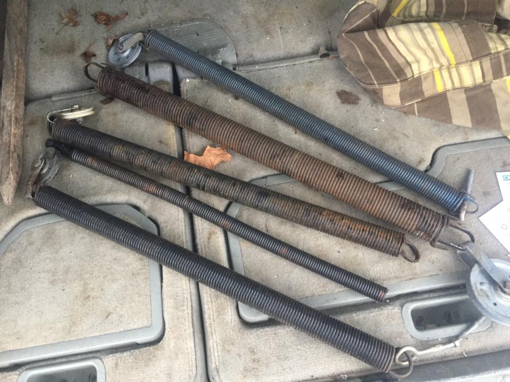

Blister Fingers Posted March 11, 2016 Share Posted March 11, 2016 Hey everyone, since this is my first post let me introduce myself. My name is Daniel and I live in the Willamette valley in Oregon (in case anyone needs a shop hand). I made this account when I was still a complete novice and trying to make tongs out of railroad spikes and using channel locks as my main tongs. Also when I was collecting cast iron window weights thinking that I was going to forge them into something. lol anyway let me get into the meat and potatoes of this post... I've been searching all over the web looking for different designs of treadle hammers because I want to build one to suit my needs. Compared to almost everything else blacksmithing, there is very little data on the good 'ol human powered beast. However the discussion is always centered around one existing design vs. another (Grade-Marx vs. Clay Spencer's design, the fabled Grasshopper, etc. Swing arm vs in-line etc.) Nobody really talks specifically about WHY these designs are good or bad beyond the basics: Anvil, hammer and spring weight, materials, build complexity... But one thing is ALWAYS ignored... GEAR RATIO!! First let me mention that I have never used a power hammer OR a treadle hammer. In videos, though, I am not at all impressed with the power of Clay Spencer's design. It's a 1-1 gear ratio with the pivot in the very center of the bar, and the drive linkage at the very end of the bar. It appears it hits NO harder than your foot can stamp the lever. The older gentleman with the Grade-Marx hammer, however, had some oomph behind it. I'm sure you've noticed how far back on the spring his linkage is set up. However I did notice when he went to faster hits, it seemed to lose a lot of power. The Clay Spencer seemed to really shine for repetitive hits. I'm also thinking a lot about drive systems. Levers and springs? Pulleys and springs? Counterweights? (I've read people don't like counterweight THs much though) I could make a treadle hammer with tons of pulleys, heavy duty rope, and a coil spring from a car, and it would be a wonderfully adventurous press. The foot pedal would have to travel so far that I'd need to climb a ladder and ride it down in order for the hammer to move a few inches with a tremendous amount of force. 9-1 ratio = 100 lbs on the foot pedal with 9X the travel distance = 9x the force on the hammer end with 1/9th the travel distance. And I also understand that Force is = to mass (weight) x acceleration. (I'm not actually this smart, my dad is a mathematician and i'm always bothering him with questions) So with this concept in mind I'm thinking I want the hammer to travel really far and the foot pedal to be very hard to press. But then there's a balance I need to find because I'm a hermit without power in my shop and really want to use this thing to draw bigger stock into smaller stock. (eyes the sway bar and coil springs on a junkyard truck) That being said, I also like doing decorative work and do love the idea of controllability while using tools. What are your thoughts? I really want to build this thing and I want it to be exactly what I need. Please help Link to comment Share on other sites More sharing options...
JNewman Posted March 11, 2016 Share Posted March 11, 2016 A Treadle hammer is a great tool for single blows with fair bit of power for light swaging that you could not do with a hand hammer. They are also great for the fact that it frees up your hands to hold top tooling. I built one and used it quite a bit over the years but I ran out of room in my shop and it had to go. Now that I have room again I may build one again. But don't make the same mistake i and many others have made. A treadle hammer is not a power hammer. If you use a peen and the corner of the anvil you can draw steel out as quickly or likely quicker than you can using fuller dies on the treadle hammer. If you want a tool for chisel work or occasional top tool work, or slow very controllable heavy blows, build a treadle hammer, if you want to draw out faster build a tire hammer, air hammer or buy a power hammer. For 2 reasons I suspect a hammer using a mechanical advantage would actually do less work. A hammer is not a press, the inertia is doing the work, a mechanical advantage is going to slow down your blow which will lessen the blow. The other reason is extra linkages guides etc add friction robbing your blow of power. My treadle hammer was a simple swing arm type. I used an inline type treadle hammer at a school and was surprised at how much less power it had. It was not the Clay Spencer type with the wheels which would have reduced the losses but I suspect it would still hit less hard than a swing arm type. Link to comment Share on other sites More sharing options...
Jim Coke Posted March 11, 2016 Share Posted March 11, 2016 Greetings Dan, Ahhh the quest to build a better mouse trap.. I have three treadle hammers and have many years experience using them . I would suggest that you find someone in your area that has one and spend some time on it .. Theory is one thing but when it is all said and done you are still limited to about 60 BPM and what you had for breakfast. Welcome to IFI and I wish you well on your build. Should change your name to Blister Foot... LOL Forge on and make beautiful things Jim Link to comment Share on other sites More sharing options...

ThomasPowers Posted March 11, 2016 Share Posted March 11, 2016 treadle hammers are inertia based as JNewman says and so the striking force is a factor of the weight of the head and how long you can accelerate it with your foot---what velocity it hits at. Thats for a single blow where they excel, multiple blows depend on how fast you can recover your leg position and how much umph you can exert rapidly with that leg. What type is best for you would depend on what type of work you are doing, tools you will be using, rapid light blows vs slow heavy ones, etc. and of course your physical limitations. Link to comment Share on other sites More sharing options...
Alan Evans Posted March 11, 2016 Share Posted March 11, 2016 What they all said above is good. I found a modified saw setters diagonal pein hammer over a heavy cheese fuller in the centre of the anvil, or a radiused anvil edge was far more effective at drawing out than my foot hammer. Mine is a simple ordinary sledge hammer pivoted at one end. It is pulled down by a bit of motor car safety belt attached to a long foot treadle. The ratio for pedal movement to hammer swing can be altered by shifting the point of attachment of the belt towards or away from the pedal. In actual use I have never bothered to alter it...I just adjust the weight of stamping. The big advantage of a foot hammer is having both hands free to manipulate a top-tool and your workpiece, not heavy blows. They are also great for scarf welds on complicated assemblies. The Black Country chain makers used them for shutting and forming up the link joins. If you want fast light taps for chasing, just use a lighter hammer head and short radius arc. One leg gets tired if you are using it for a few hours! Alan Link to comment Share on other sites More sharing options...
Frosty Posted March 11, 2016 Share Posted March 11, 2016 Welcome aboard Daniel, glad to have you. I love the Willamette Valley though its been years since I've been through. One more lash at the dead horse, treadle hammers aren't power hammers, a good striker can do more work quantity wise. Still, I think everybody new to the craft has tried to winkle out how to make one do power hammer work. I sure did. Force is mass x acceleration and acceleration is time based the shorter the deceleration time the more force applied. Hammer. The trouble is you can't get more power out of a hammer than you can put into it. your "gear" lever ratios have a close point of diminishing return and 9:1 is WAY past that point. Somewhere around 2or3 : 1 is about a practical goal. I'm a high gear kind of guy too. Experiment with a simple Oliver type treadle driven sledge hammer, it makes a good test bed for ideas and is a LOT easier and cheaper to build. If you don't have a stream close by coming up with an off the grid power system is a project in itself. For short duration power hammer work you COULD use a: gas engine, water power if available, wind or legs. Usable wind or leg power for a power hammer is problematical and I think a flywheel would make it "usable" for short duration. If you have a prevailing wind a flywheel is less necessary but pumping up a flywheel with a pedal drive would "work". Oh yeah, I think about things all the time and my first treadle hammer drawings are a hoot. I've given wind power a lot of thought over the years. Storing the power for when you need it is the trick. A flywheel isn't particularly practical, it'd need to be one BIG flywheel to store much poser. However heat is always a desirable item here, especially in winter and we live in a windy area. I was going to lay steel pipe under the shop slab and use it as a compressor reservoir. The heat of compression would go a log way to heating the shop in winter. One serious bug is powering the compressor, electric heat is a budget buster here, we're too far from Grand Coulee dam to get a break on elec ours is all nat. gas generated. However there's where the wind generator comes in, not to generate electricity but mechanically connected to the compressor. All it has to do is turn at all and it turns the compressor. Never did it but had it all drawn up, horizontal wind turbine so wind shadow isn't an issue and over spinning it is easily taken care of with a centrifugal clutch and generators, faster it goes the more generators are engaged so the turbine can't be blown apart in extreme winds it just generates more power. There are a number of ways to power a power hammer with compressed air. A wind mill could also store energy by pumping water into a tower or pone uphill from the shop. Like I say I think about these things. The one thing I've never figured out is how to make a treadle hammer do the work of a power hammer. The advantages of an inline treadle hammer isn't power or speed it's the ability to use closed dies attached to the hammer itself. Spring dies are a good alternative in a swing arm hammer though so the question in my book goes back to energy lost to friction and the swing arm as the better alternative. The grasshopper is a Watt's linkage adapted by Bruce Freeman that produces a close tolerance matched inline motion. It was one of many linkage systems James Watt experimented with to convert the reciprocating motion of steam pistons to rotary motion. Anyway, it's a pretty straight forward linkage that has a lot of reciprocating weight so if you use close fitting and robust pivots you can take advantage of all that mass for a minimal amount of friction. The question involved in building a grasshopper is how good are your shop skills? They aren't really all that complicated if you don't use Bruce's plans but you have to be able to do precise work and I MEAN precise. It only takes a small fraction on an inch miss match in one of many linkages and it's going to bind and there goes the energy you're putting into it. There are a LOT of options and possible new ideas out there waiting to be tried out. Have I mentioned I THINK about this kind of thing all the time? Frosty The Lucky. Link to comment Share on other sites More sharing options...
Blister Fingers Posted March 13, 2016 Author Share Posted March 13, 2016 (edited) Thanks so much for all the feedback, guys. It's a shame I can't have my cake and eat it, too. I think I will build a sort of treadle hammer for tooling. I have 2 pickaroons made out of railroad spikes, the punches and chisels to cut the holes, and no striker to help me muscle through that steel accurately and effectively. (I know, I know, I didn't punch the holes first, but I just didn't want to at the time!) Another advantage i'm thinking A treadle hammer would provide is giving my right arm relief from all the heavy metal movin' activities. I've spent a good 10 hours a day hammering on multiple projects at a time... could barely close my hand after all that. Surely it's advantageous in that regard? I mean, I DO have 2 legs... I found that I goofed up more projects trying to swing the hammer with my left hand. While i may be laughing, I am completely serious about that. I think i'll take your advice and build a simple one to play with, that way I won't be weeks into fabrication alone on a huge project without knowing my preferences and needs as a smith. It would be a shame to spend months collecting junkyard scrap (i'm a recycler) and building a full scale treadle hammer with, for example, a really short throw on the foot lever to find that it wasn't what i really wanted. I think a simple, quick and easy treadle hammer will allow me to play with the pivot points and where the linkages connect. Also i'll be able to experiment with different return mechanisms and really prepare me for when i'm ready to build the full strength model. Alan, I thought you were messing with me about the saw setters hammer and the cheese fuller, until I looked it up. That's an aggressive way to draw out steel! I'd bet it works like a charm. I have a 165# Trenton anvil. It's pretty soft on the surface, I don't know if I want to sacrifice a working edge for all that heavy hitting. Some guys say to draw out on the horn, but it's hard to keep it square, and tends to lack rebound. Also it shocks the crap out of your hand if you miss. Frosty, that stuff about the air compressor is interesting stuff. It reminds me of a bicycle builder in Portland (not suprisingly) would used a little antique brass canister and a piston to compress air while he rode his bike. Then after the tank was full, he was able to use that stored energy to power his bike for him so he was able to rest. Fascinating stuff. It makes me wonder about using belts and a flywheel to create a treadle hammer that operates the same as a power hammer, but also moves a piston to compress air. I have seen the former done, and even have a couple old flywheels and manual transmissions laying around. While electricity is great, anything achieved without it cuts overhead costs. And if you're a doomsday theorist, you'll be relieved to know that your shop will be unaffected by a power outage. That's why I stray from electricity, anyway. We get power outages out here. Sometimes for a couple days at a time. As far as my shop skills go, I am okay, I guess. I live with my parents on our small farm and help maintain the property. In exchange I get to use all of dad's great shop tools. We have a great mig welder. I can make a weld rock solid without co2, weld stainless to mild steel, burn through the zinc or the paint on metals I was too lazy to do proper edge prep on, weld up a hole on a weelbarrow, etc. I didn't have the money to buy a post vise for my shop, so I welded one up out of scraps. Works just fine. Anyway, this is getting WAY off topic. Here's a photo of the 12# sledge i'll use and a bit of railroad for the anvil. It will be a good test model. I think this one will get a wooden frame. I have some scraps... i'm also not sure exactly how i'm gonna build it yet. Trial and error, I guess. Also pictured: a wooden shield I made years ago, some lawnmower blades, window weights, and a bucket of railroad spikes (which DO make good knives if you harden them and don't temper them!) ::edit for another side note:: that's my anvil with a wooden cover on it to keep my nephew from peening the edges for me. Also a lawnmower blade sword in progress. I'll upload pics of my hovel in the "show us your shop" thread. Edited March 13, 2016 by Blister Fingers Link to comment Share on other sites More sharing options...

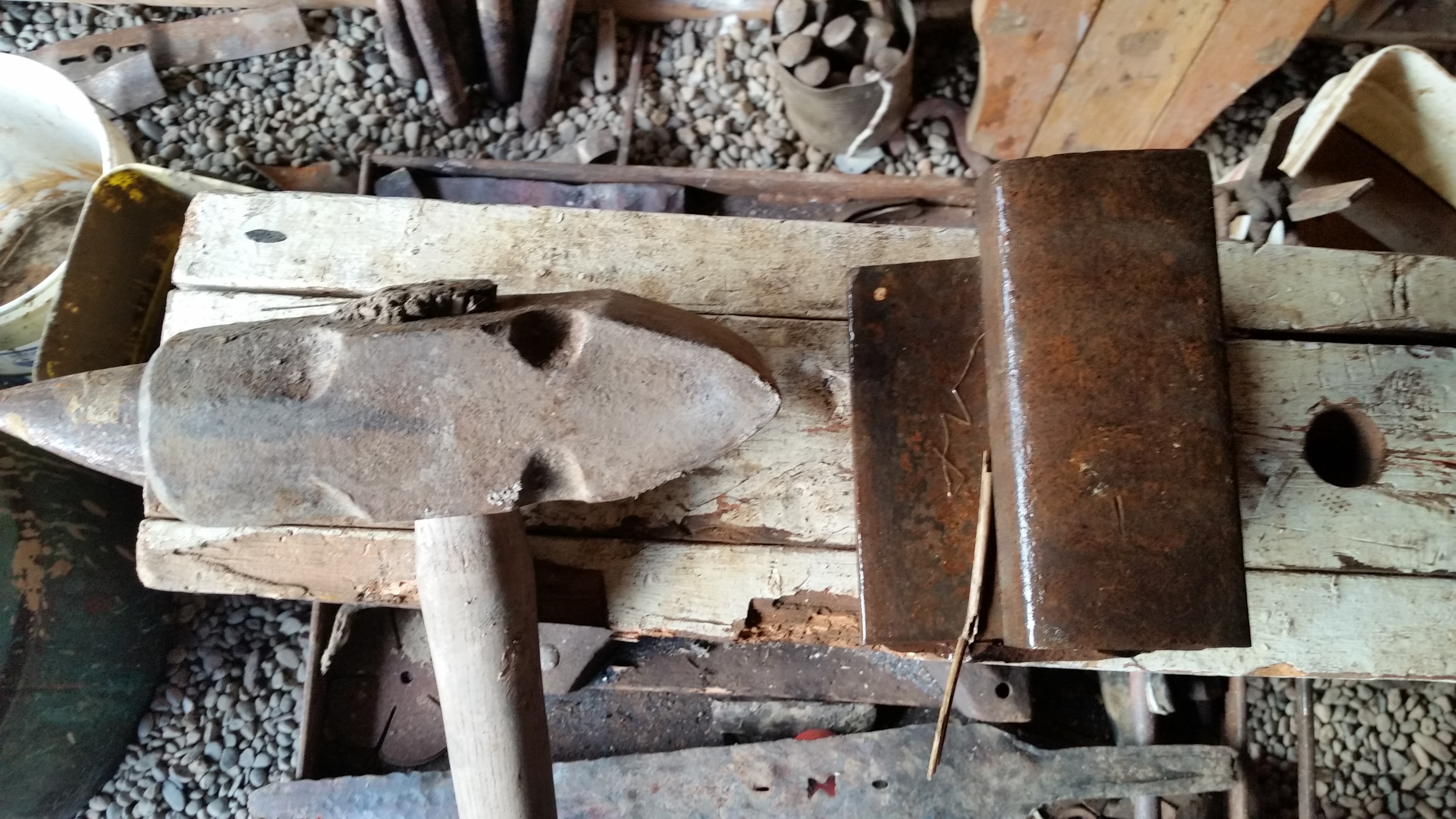

Alan Evans Posted March 13, 2016 Share Posted March 13, 2016 Here are the some images of my simple foot hammer. Mark 2. The hammer, axle, bearings, pulley, belts and treadle were found at a scrap yard and were originally mounted on an angle iron stand from an electric fence wire drum. The assembly was placed behind my hand anvil and the hammer was swung over when needed. The hammer was thrown on its back and the treadle came up and hooked under the heel of the anvil when it wasn't required. The pulley and belts could be replaced with a simple crank and con rod, which could be either in tension for pull down as this version, or push up from the back if you extend the treadle behind the fulcrum. If you made a version with a moveable anvil, or made the hammer independent/free standing of the anvil, you could take advantage of the clamp shaft fixing and adjust the length of the hammer shaft for a shorter throw for faster blows. I have never needed to do this, I found that this worked and was versatile enough just from stamping light or heavy. But then after a few years I started to acquire power hammers. A friend in Herefordshire, Simon Lawrence invented a single blow, powered foot hammer using the back axle, differential and brakes from a motor car. The hammer was driven by a vee belt pulley mounted on the nose of the differential. A hammer shaft was bolted onto one of the brake drums and held above the anvil by a return spring. The foot treadle operated the hand brake cable of the drum on the opposite side of the axle to the hammer. With the motor running and the treadle up, the hammer shaft was held stationary in equilibrium with its return spring, and the braked drum revolved freely. When the treadle was pressed it actuated the brake, the spinning drum stopped and the drive was redirected to the hammer shaft drum which came down whack. The treadle was then lifted; the brake released; the drive was redirected so the braked drum revolved again and the hammer was lifted by its return spring. He could strike as fast as he could treadle. There may have been a slight additional cleverness by having the hammer side drum brake operated when the treadle was lifted to stop any hammer nod...I can't remember. The key is to make up something from the resources available to you...as I am sure you know. Alan Link to comment Share on other sites More sharing options...

Blister Fingers Posted March 14, 2016 Author Share Posted March 14, 2016 Thank you, Alan for the photos and the drawing. I think I already have all the materials needed to build something very similar to that design. If you would have just explained it in words, I don't think I would have understood at all. I don't expect any of you guys have spent much time making chain maille? The first step of that process is essentially just making a spring. Change the diameter of the rod and the wire, and you have whatever size spring you want. It wouldn't be as durable as something made of a high quality steel, hardened and tempered properly. It would, however, work for what I need it for temporarily. Link to comment Share on other sites More sharing options...
