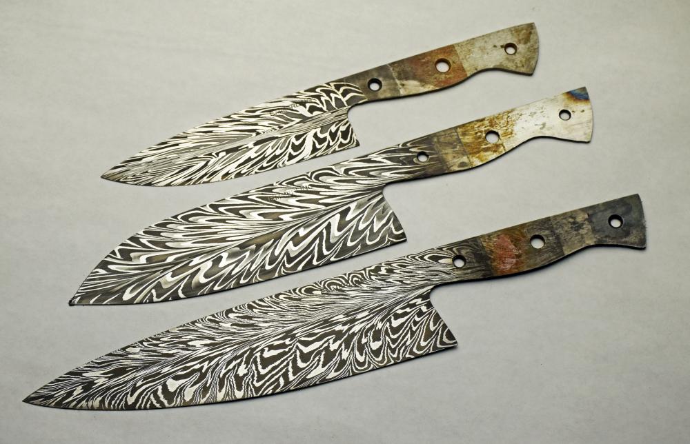

gearhartironwerks Posted March 7, 2016 Share Posted March 7, 2016 Here all 3 new blades out of the etch this week in need of furniture. I'm happy with the etch and overall look of them. Hope to have handles on this coming week. The top and bottom blades are 1095-L6. The middle is 1095-L6 plus several pieces of mild steel. I like seeing the 3 distinct colors. Thanks for looking. John Gearhart Ironwerks Quote Link to comment Share on other sites More sharing options...

gearhartironwerks Posted March 7, 2016 Author Share Posted March 7, 2016 40 minutes ago, Daswulf said: Wow what an awesome feather like pattern. All three are feathers with the top having another piece of damascus inserted between the halves before welding. In retrospect, a more active piece would've worked better visually. Oh well, next time... Quote Link to comment Share on other sites More sharing options...
natenaaron Posted March 7, 2016 Share Posted March 7, 2016 That is quite the pattern. Very Nice. Can't wait so what you dress them in. What steels did you use to get such a major contrast? Quote Link to comment Share on other sites More sharing options...
Daswulf Posted March 7, 2016 Share Posted March 7, 2016 24 minutes ago, gearhartironwerks said: All three are feathers with the top having another piece of damascus inserted between the halves before welding. In retrospect, a more active piece would've worked better visually. Oh well, next time... In my opinion they work out beautifully visually. No problem with working towards a more active pattern tho. Beautiful work. I'd love to see how you compliment the patterns with handles. Quote Link to comment Share on other sites More sharing options...

rhitee93 Posted March 8, 2016 Share Posted March 8, 2016 I have come back to look at these 4 times now. That feather pattern is mesmerizing. Maybe some day I'll grow up and be able to handle a billet large enough to try that pattern. Quote Link to comment Share on other sites More sharing options...
gearhartironwerks Posted March 9, 2016 Author Share Posted March 9, 2016 rhitee, feather patterns are not that difficult. go to www.kevincaseyknives.com for an excellent tutorial. you don't need a press, but a power hammer helps as you can split the billet with a top tool. after splitting, grind off the flash and flatten the faces with a belt grinder for a tight fit, then mig weld all around the billet for a dry weld. give it plenty of soak time. just remember that it's the ends you want so rotate 90 deg and draw out. please send some pics when you do it. john Quote Link to comment Share on other sites More sharing options...
