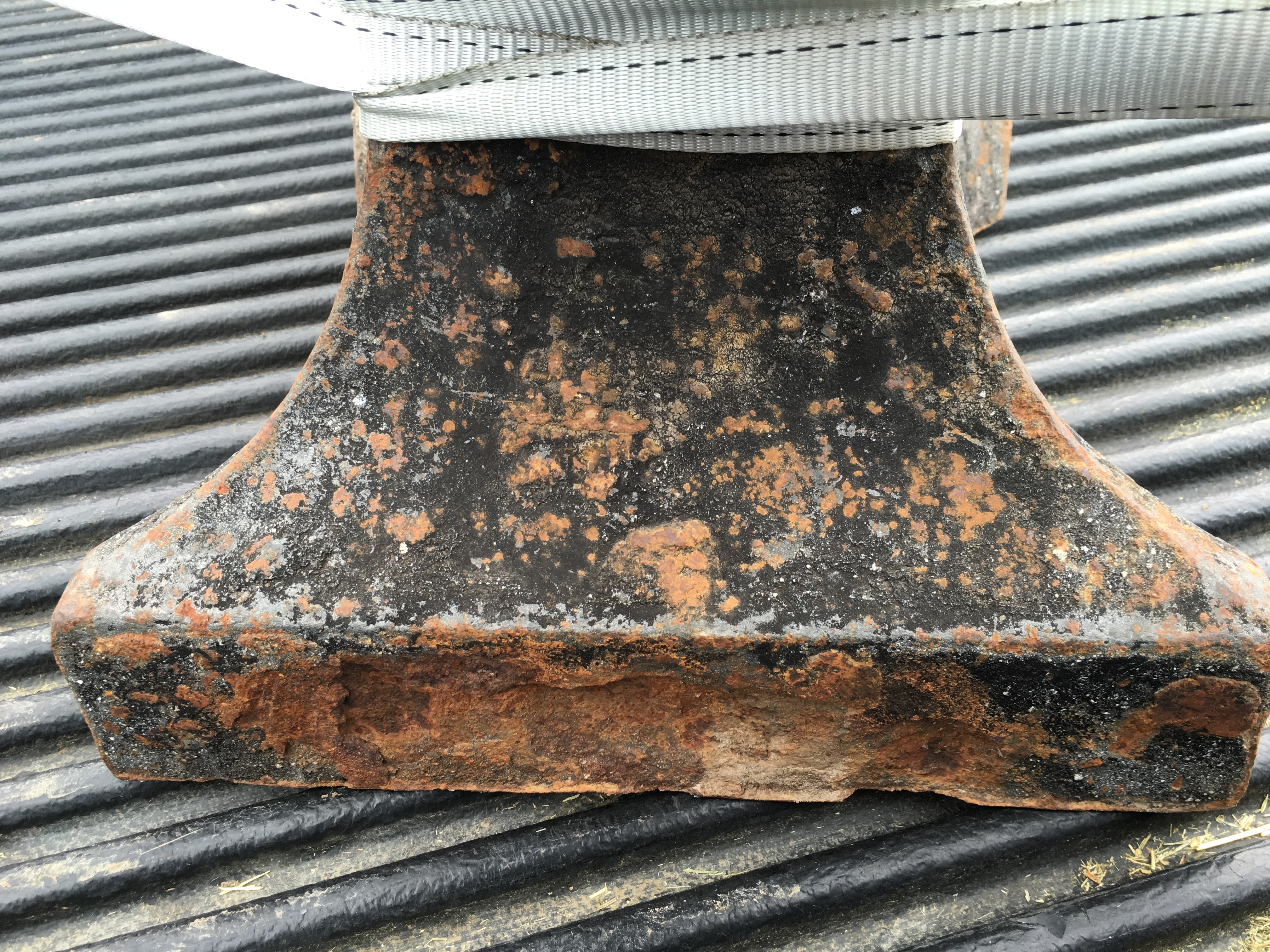

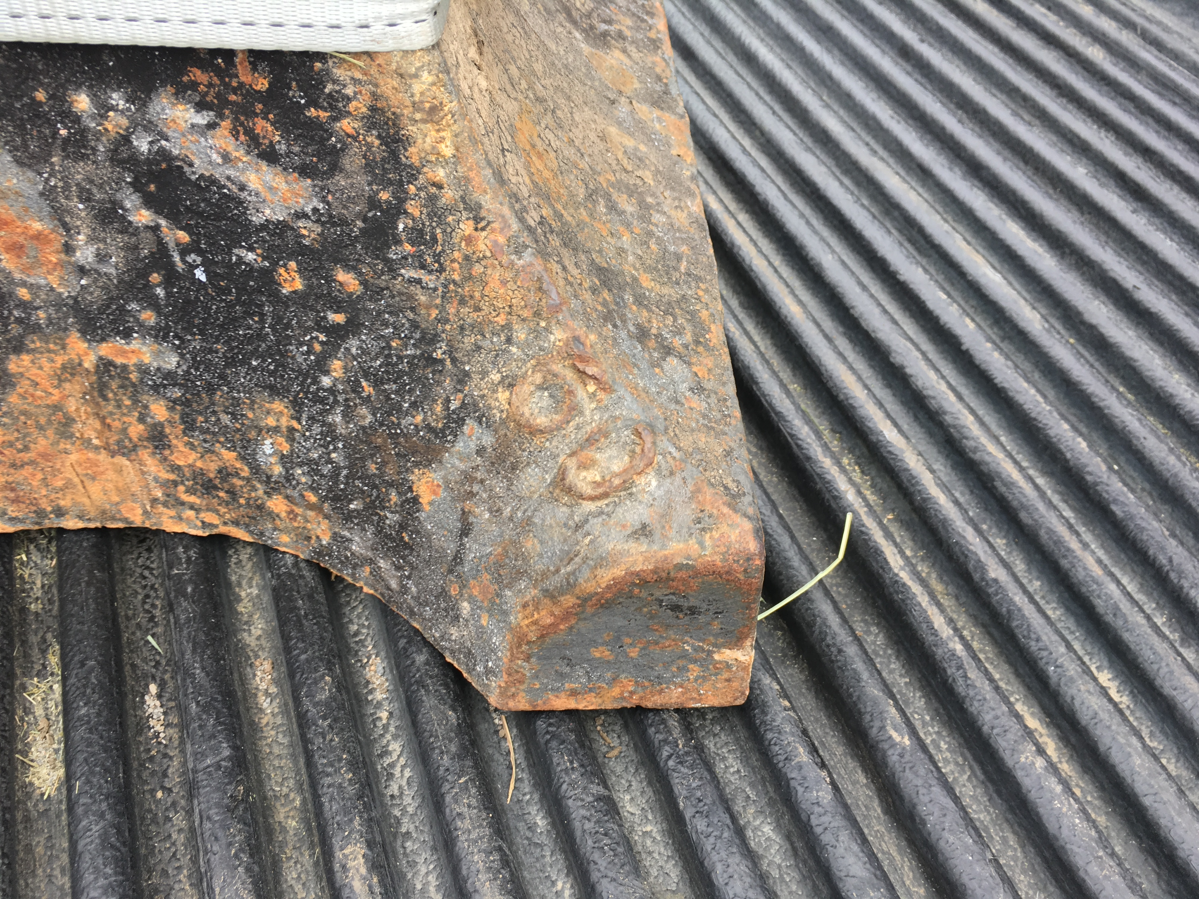

Deviant Nation Posted February 18, 2016 Share Posted February 18, 2016 I got my first Anvil last night. What do you think? Any ideas what brand it might be? All I know for sure is the rebound is easily 90% or a little more with a 1" steel ball and the surface looks to be in very good shape. But I don't see much for marks on it other than the weight and what looks like a spot where there used to be a mark or stamp on the end of the base on the square end. Quote Link to comment Share on other sites More sharing options...
FoxFire Posted February 18, 2016 Share Posted February 18, 2016 Fisher, that's my guess. The rust line on the horn, the feet, and overall proportions were bugging me until I saw the raised numbering. Does it ring or thud? Quote Link to comment Share on other sites More sharing options...
ThomasPowers Posted February 18, 2016 Share Posted February 18, 2016 600 pounds? Quote Link to comment Share on other sites More sharing options...
Deviant Nation Posted February 18, 2016 Author Share Posted February 18, 2016 The mark is 50 so I am saying 500 the guy I got it from had an old scale that weighed it at 520 but he said his scale could be a few pounds off. And no it doesn't ring loud it is pretty quiet. Quote Link to comment Share on other sites More sharing options...

FoxFire Posted February 19, 2016 Share Posted February 19, 2016 Fisher Quote Link to comment Share on other sites More sharing options...
Deviant Nation Posted February 19, 2016 Author Share Posted February 19, 2016 3 hours ago, FoxFire said: Fisher Sweet! That is what I was hoping it was. Thanks. 14 hours ago, otisdog said: Xxxx of a first anvil....one and done! It is in beautiful shape. Thanks yea I like the buy once cry once theory most of the time. Anybody have any recommendations to the best way to get it looking good? Just a wire wheel on a grinder? Do you use any cleaners or chemicals to clean them up? And should I paint the sides after I clean it up or just leave them? Or any other general need to knows about it that I should know? Quote Link to comment Share on other sites More sharing options...
Glenn Posted February 19, 2016 Share Posted February 19, 2016 Light wire brushing on the sides, followed by a protective coating. 8 hours of hammering hot metal on the face should make it shine. Lightly wipe the face with ATF after each use. Quote Link to comment Share on other sites More sharing options...
