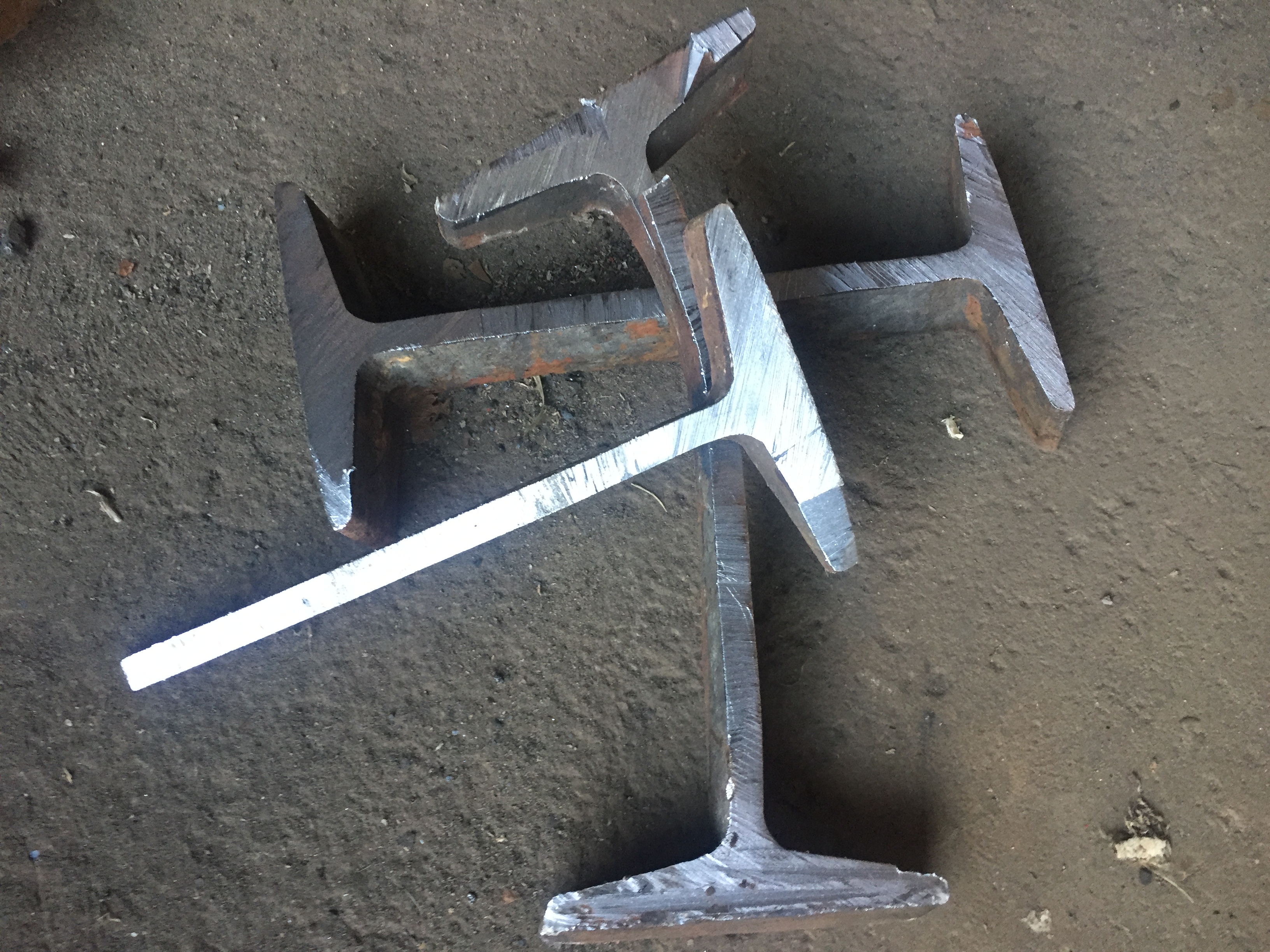

JHCC Posted October 31, 2017 Author Share Posted October 31, 2017 UPDATE: That slope I mentioned earlier became a LOT more obvious when I made the big shift from horn-on-the-left to horn-on-the-right. After muddling by with some heavy shims (chunks of rail plate and structural steel), it became clear that drastic action was needed. I shimmed up the feet until the anvil was (mostly) level, marked around the feet with a Sharpie and a wooden block, and cut off the excess with the PortaBand. (That thing is wonderful. Wish I'd had it when I first cut out the pieces for the stand -- it would have been so much easier!) Not a perfect job, but it's a LOT closer to level, and works very nicely. Here's the marking before cutting: And the stand leveled out: And the offcuts: Quote Link to comment Share on other sites More sharing options...
VaughnT Posted November 2, 2017 Share Posted November 2, 2017 On 10/31/2017 at 9:47 AM, JHCC said: And the stand leveled out: And the offcuts: I love the heavy industrial vibe of your stand. I'm thinking about redoing my stand and that's definitely a great model to keep in mind. The offcuts will make great hooks for the shop. Cut the full ones in half, draw them ends out an bit, and bammo, you've got some great pieces to hang your hat on! Quote Link to comment Share on other sites More sharing options...

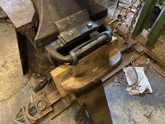

JHCC Posted September 10, 2020 Author Share Posted September 10, 2020 Update: as noted elsewhere, I’ve had some trouble with the silicone coming loose, so I added a couple of brackets to hold the anvil down more positively. I've also moved all my anvil tooling onto a separate rack, so I made a hook to hang my block brush from the loop on the front edge. This puts it right by my hammer hand when I bring a piece from the forge to the anvil, which should help reinforce the habit of brushing everything before forging -- plus I won't be constantly hunting for my brush! You can also see in these photos the base of the treadle hammer that's now set up with this anvil, but that's another story! Quote Link to comment Share on other sites More sharing options...
