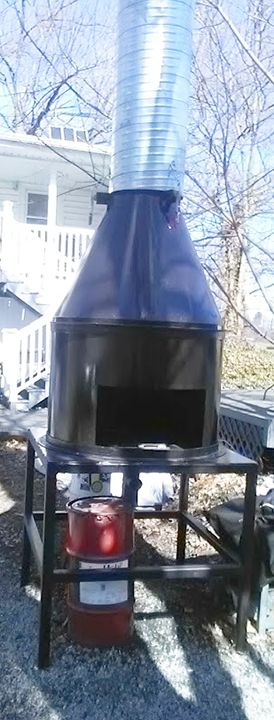

Stitch Posted March 11, 2018 Share Posted March 11, 2018 Well, I took advantage of the sunny day today and almost finished my new coal forge project. I bought another fire pot from Dave Custer and installed it. I really like those fire pots! I still have to mount my blower and the tabs for the small opening piece. The culvert stack is 16" diameter. The table size is 42" square. I bought this from my local industrial surplus store cheap. It was new and never used. It originally was a hopper made for the Philip Morris company. Now it's a forge/smokestack. How's that for irony! Thanks again for all of your input guys! Quote Link to comment Share on other sites More sharing options...
Daswulf Posted March 12, 2018 Share Posted March 12, 2018 That's a big one. Looking forward to hearing how it works out. My guess would be it works fine. No pass through? Could make a hinged and latched door. Quote Link to comment Share on other sites More sharing options...
Stitch Posted March 12, 2018 Share Posted March 12, 2018 Hey Das, It's a big boy for sure! I have a pass through planned. I have to draw up the cut template.. Quote Link to comment Share on other sites More sharing options...
Stitch Posted March 20, 2018 Share Posted March 20, 2018 First test of the new forge and Wow!! I can't believe how great it draws... I set some lump charcoal in it with a small wad of paper and it took off like a F-111 in full after burner. And that was without using the blower! My buddy and I forged for 4 hours Sunday and I've never had a better fire to work with. We hardly had to use the blower, only when we needed the extra heat. hat 36" tapered cone and 16" diameter stack must work like a super vortex. Very happy with this project. Now on to the surface grinder/belt grinder project... Video here Quote Link to comment Share on other sites More sharing options...
Stitch Posted March 20, 2018 Share Posted March 20, 2018 Really works great Das, Come over and try it! Quote Link to comment Share on other sites More sharing options...
Daswulf Posted March 20, 2018 Share Posted March 20, 2018 Thats a pretty crazy draw Stitch. Might take you up on that if the Gods allow it lol Quote Link to comment Share on other sites More sharing options...
JHCC Posted March 20, 2018 Share Posted March 20, 2018 I saw it this morning. It's basically a tornado in a can. Quote Link to comment Share on other sites More sharing options...
Daswulf Posted March 20, 2018 Share Posted March 20, 2018 looks like it in the video. Quote Link to comment Share on other sites More sharing options...
