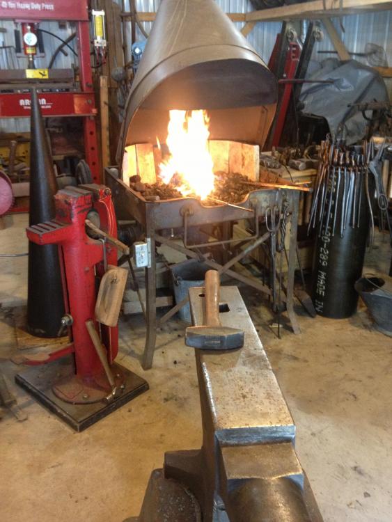

Picture Joey drew me for the design of extension.  The extension I fabricated.  And the students inside shop with the recently installed fly ash hood.

Since you will be doing mainly large scroll work for railings it had better be the wide one; oh wait; since you will be doing mainly bottle openers and knives the small opening will work better for you.  Or why not make the front hinged with the smaller section built in and then you can run it either way depending on what you are doing?
My set up starts with an 8" pipe with a slight bend, goes to a 90 degree and reduces down to a 6" pipe. (It's a 3-foot length of double wall metalbestos which passes through my shed wall.) It expands to an 8"  90-degree elbow and extends up to a 4-foot pipe which is 3 feet over the peak of the shed.
Crazy right! But it works because I built an enclosure around my tiny rivet forge and made a small opening. Less cool ambient air mixes with the hot air for the coals and I get a fantastic draft.

My hood (2/3rds of a 55 drum) hangs from the rafters on chains and goes to 10" pip going straight up. I have sheet steel inside the hood that I can slide up or down for what I need to do. Once the forge is going it has great draw and if needed I can slide the sheet steel up and have full access all around the forge.  It also makes it simple to move the forge for cleanup and maintenance. I really like that hopper as a good idea and think it will work great with 12" pipe.
