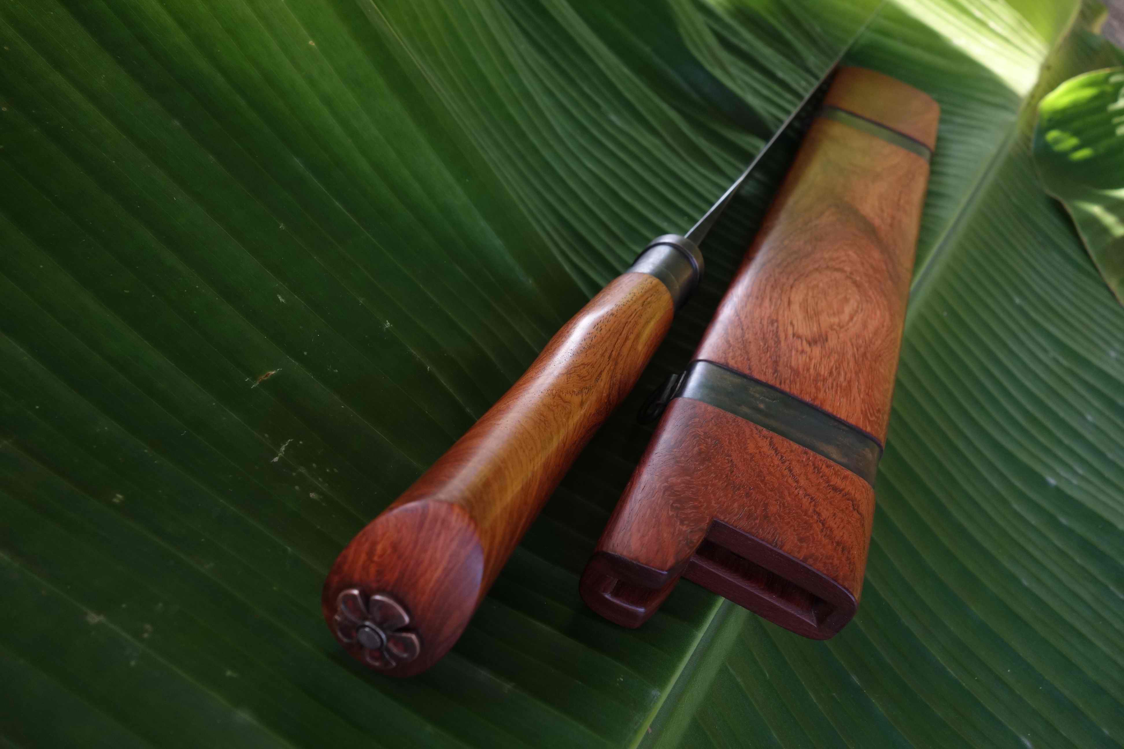

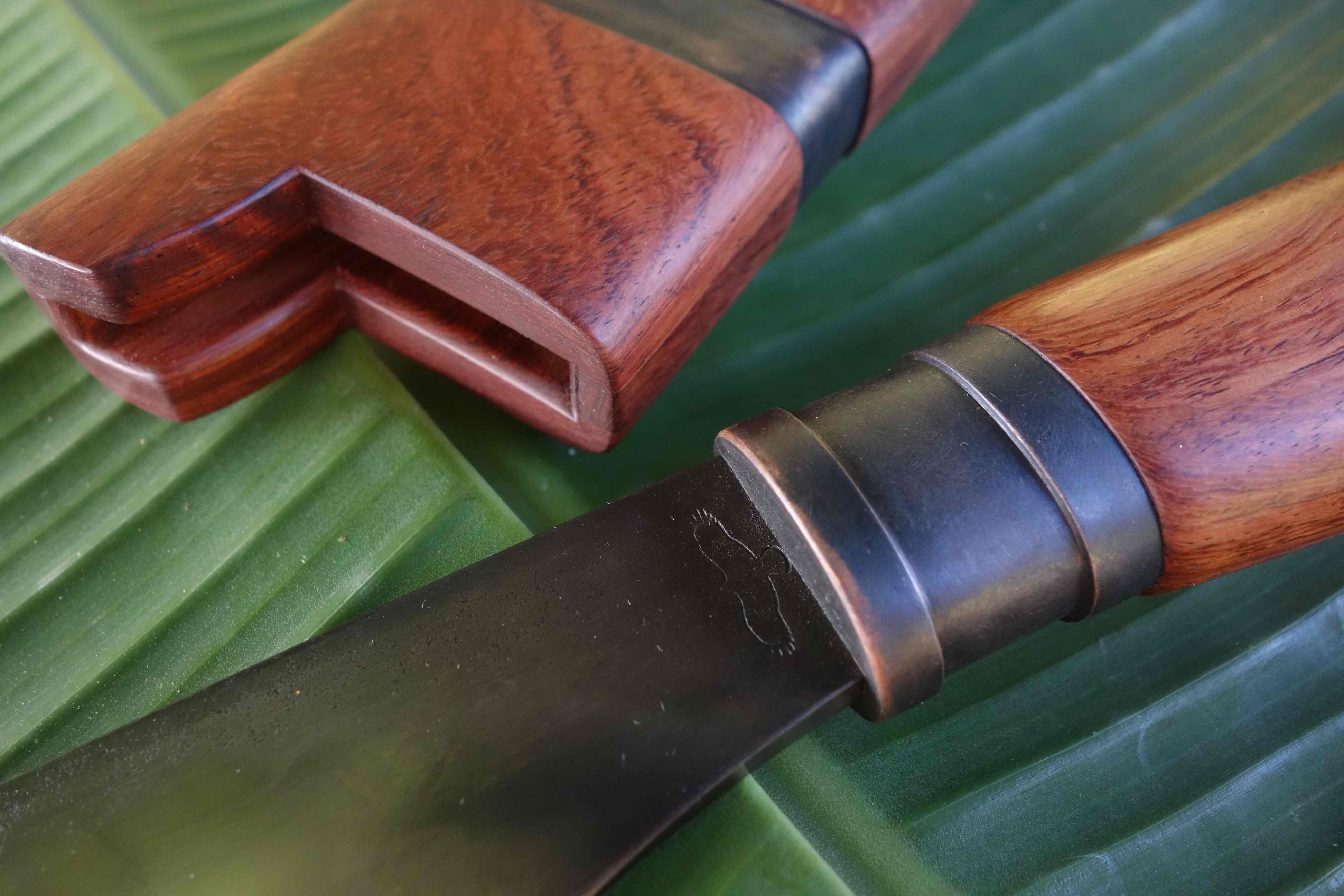

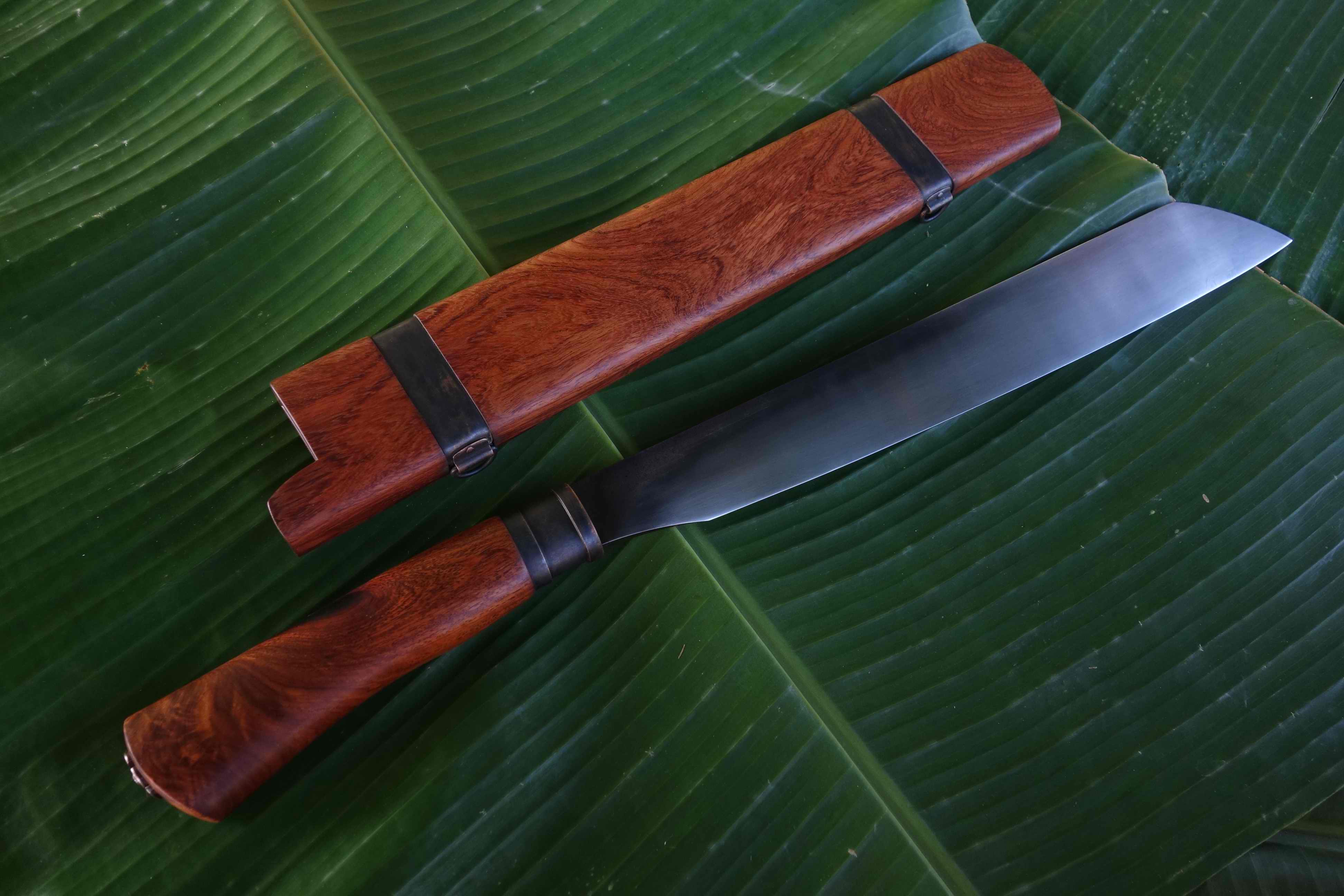

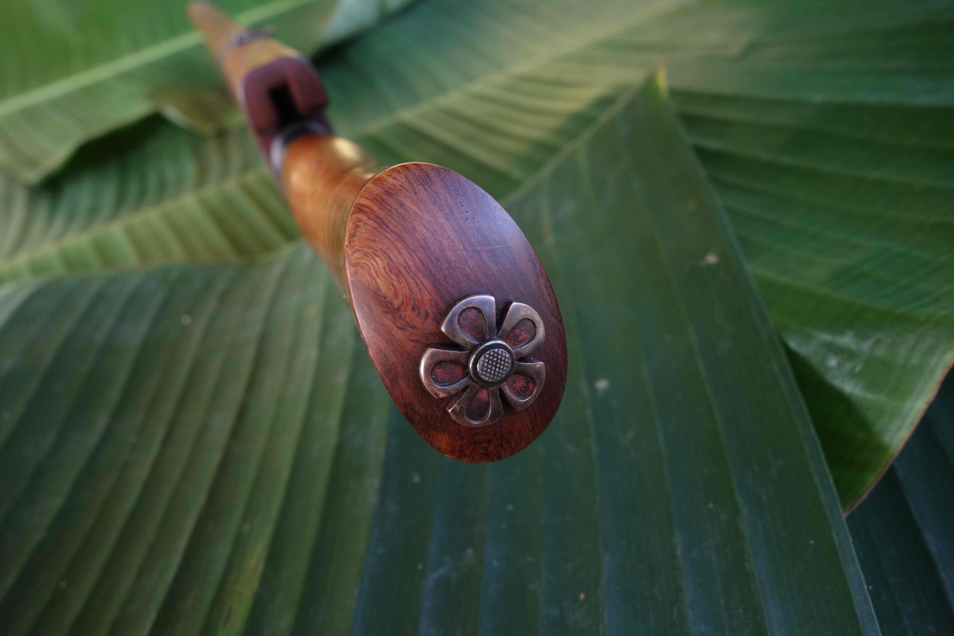

templehound Posted January 24, 2016 Share Posted January 24, 2016 The blade of this light parang, I forged from leaf spring of a bicycle-riksha. Handle and sheath are made from the same chunk of Indian Padouk (narra wood) and the fittings are made from copper. Center of the flower is the peened over tang. Blade measures 310mm and overall 460mm Quote Link to comment Share on other sites More sharing options...

BIGGUNDOCTOR Posted January 24, 2016 Share Posted January 24, 2016 Simply beautiful. How did you get the patina on the copper fittings? Quote Link to comment Share on other sites More sharing options...

templehound Posted January 26, 2016 Author Share Posted January 26, 2016 On 1/24/2016 at 4:30 AM, BIGGUNDOCTOR said: Simply beautiful. How did you get the patina on the copper fittings? I use Potassium Sulfide.If You polish the copper surface it will rub off to fast. Give it a 240 grit scratch finish like jewelers use to do then the patina remains better. Quote Link to comment Share on other sites More sharing options...
templehound Posted January 26, 2016 Author Share Posted January 26, 2016 7 hours ago, JHCC said: Lovely piece. Thanks for sharing it. I did a lot of work with padouk in my cabinetmaking days -- lovely wood to carve: just the right balance between hard and soft, takes good detail, smells nice as you carve it. The only issue I ever had with it was wishing it would keep the lovely reddish brown instead of darkening to a velvety chocolate. JHCC I agree with You, it is a very nice wood to work with, like You said not too soft not too hard.That fact makes it one of the most durable natural materials .On folders with those thin scales, padouk dont shrink, warp, or crack.This makes it a material with more endurance than Giraffe bone. With the color I have different experiences with Padouk.Some darken after, some darken a bit and some pieces do not.I guess it has much to do with the individual tree/piece of wood. the Indian Padouk (Pterocarpus Indicus) seems to darken more than the Burma Padouk (Pterocarpus Macrocarpus)from which I have some personal knives in use, that are not darken at all.But they are all from the same hughe root chunk. I finish it to grit 800 and then treat the wood with a very light touch of oil.If use too much, the oil will remain as blue-greyish ugly spots in the pores of the wood. Most of the wood treatments making it darker already It is like so often, the more You know the more questions You have Quote Link to comment Share on other sites More sharing options...
