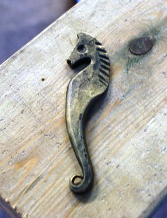

Small pendants/fobs/zipper charms about 1.25" tall, all hand carved.

little turtle forge, I really like the touch of the brass and the different mane texturing, I'm assuming that you used different chisels with different grinds?
Thanks!! thats exactly right, i use my old horse shoe fuller and a nice flat chisel for the mane. i love playing with copper and brass for a contrasting rivet, wish i had more on hand and was as good as i am now at rivets when i had it. did this one around the same time but not a keychain.

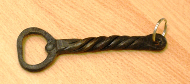

:) Frosty, They fought me. Honestly I would have liked them a lil more even but I do like them. funny enough I got the better twist on the first one.  I'm going to have to research more if I need to do any more of these.
One idea I had was to make several sized tapered square holes in a twisting bar (small to large) to use them to build up and work at a more even twist. more research will tell if there is a better idea already out there.
I like the one on the left but that's taste I think the twists are about equal. Not the same but equal.
I had luck doing tapered twists for screws by using the vise but pulling the stock back and tightening the jaws to match. I tried something similar with a pair of pliers I ground the teeth out of but didn't like it as much.
Doing a tapered cable twist like those might work with a twisting wrench that was a long acute V. clamp the work horizontally and slide the wrench out the taper as you twisted.
The trouble I had was the difference in force necessary to twist the taper on top of different temp loss. I swore I'd just use a torch after messing around for a while. However a screw has some pretty thin edges on a thicker center. Made heating them without burning them tough. An electric or better induction forge would've been nice, REALLY nice.
Thanks for the ideas Frosty. I'll try some different techniques and see what works best for me.  Yeah an induction forge would be nice but I have other tool needs first.
Thanks Aus. The whole time I was thinking of making a unicorn sculpture :). Another day...
Aric - on your chiseling for the unicorn horns - set the chisel lines good then go over them a couple times overlapping the ends of the chisel marks from the previous chiseling to smooth out the lines - this will help to keep the "kinking" down to a minimum during twisting. Keeping the metal uniform, even heating, and consistent twisting is the key for good looking twists.
Thank you Jeremy.  Other then looks I didn't know that not having it as smooth of a chisel line could affect the twisting.
I will also dress up the chisel I used to soften the edges a bit so the start and stop are softer, then I'll use your advice and go back over the lines.
Mainly the kinking on this was me fidgeting with the wrong tools trying to twist in different areas "trying" to keep it as even as I could.
Also very smooth consistent tappers provide even twisting, its the combination of many variables that make for clean looking twists, practice, practice, practice. Attention to detail is key, as small variables combined - compound the looks greatly, whether good or bad.
