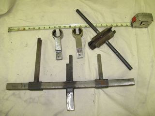

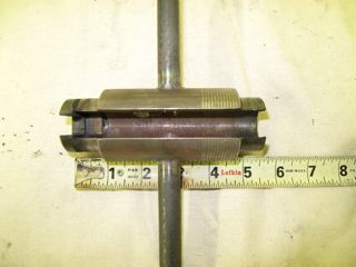

John McPherson Posted January 16, 2016 Share Posted January 16, 2016 Found this one online in 2010. Don't know who to credit. Link to comment Share on other sites More sharing options...

John McPherson Posted January 18, 2016 Share Posted January 18, 2016 Link to comment Share on other sites More sharing options...
griffinforge Posted January 19, 2016 Author Share Posted January 19, 2016 I'd like to build some thing essentially like a pipe threading machine with a gear reducer, mounting to a beam sounds reasonable..I have an acorn table I could mount it to as well. And yes I do have a 14 x 40 lathe that I was contemplating for this application. Thanks all for the input! Link to comment Share on other sites More sharing options...

671jungle Posted October 11, 2020 Share Posted October 11, 2020 On 10/8/2020 at 7:25 AM, Gazz said: Did Griffin Forge ever get a twisting machine going? I don't know. The stock I plan on using most for twisting will be for gates and rails once I get there. It doesn't get any simpler then the machine John posted above. I am sucker for simple but overthink quite often. I had plans all drawn out in my head that would require excessive welding and heavy duty blah,blah,blah, until I understood what i was looking at in the pictures above. Sometimes my brain is slow to interpret what it thinks my eyes see. Link to comment Share on other sites More sharing options...
