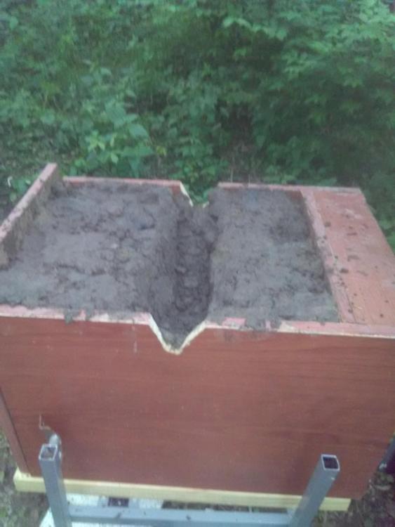

pnut Posted May 8, 2019 Share Posted May 8, 2019 (edited) Finally rebuilt the jabod. The first one was wrecked after a long period of rain. The stand sunk in the mud and dumped it splitting two boards. I still need to make the firepot a little wider and see how much it's going to shrink check but otherwise I'm back to work after putting it off too long. Pnut(Mike) Edited May 8, 2019 by pnut Quote Link to comment Share on other sites More sharing options...
