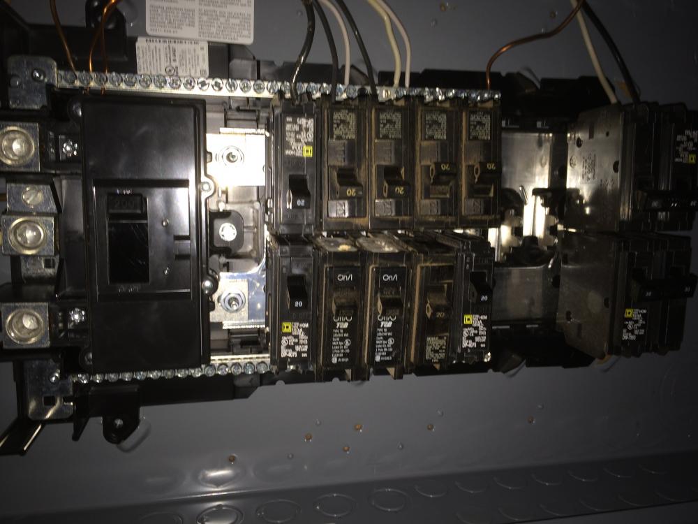

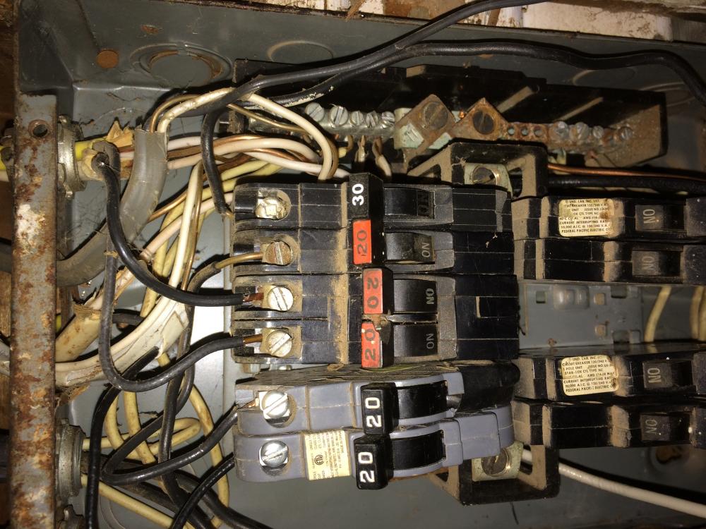

I would first investigate the type of service panel, and type of breakers you have. Some of the older panels are patently unsafe.
The first is a type that has been condemned as the breakers were known not to trip, while the second is a modern "double D" type box
basic house wiring isn't exactly rocket science but if you don't do your research and do so correctly and to code it can be costly and dangerous.
