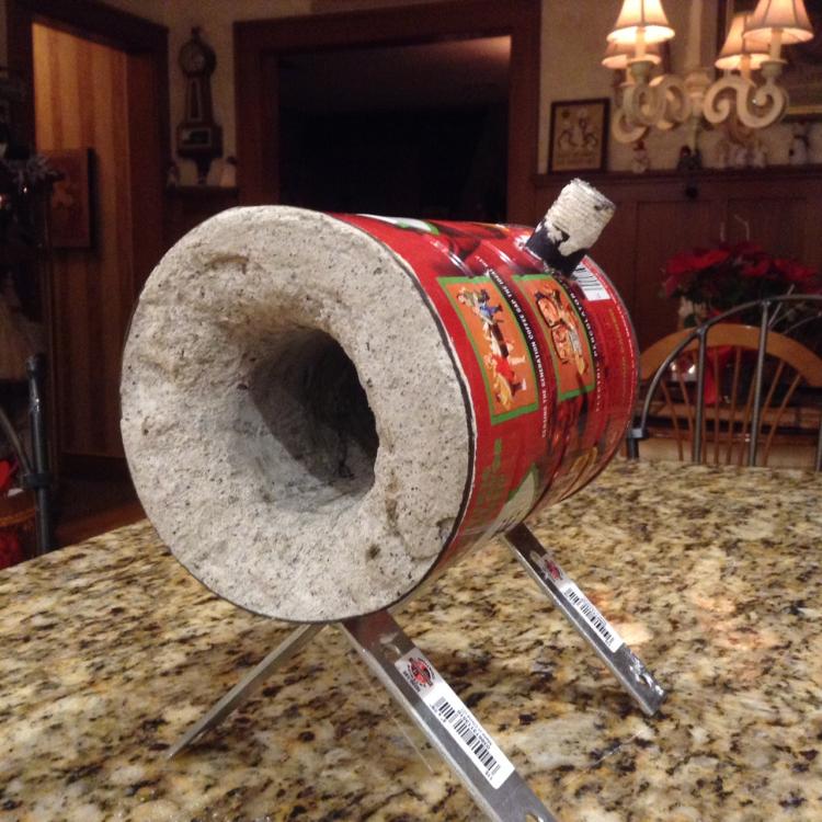

Forging Carver Posted December 17, 2015 Author Share Posted December 17, 2015 Alright so the thing is made but I used a kitchen oil spray container as a form for the center. Only issue is that the mix hardened and now I can't get it out. Is mayo not option to melt the can out? Thanks Quote Link to comment Share on other sites More sharing options...

Latticino Posted December 17, 2015 Share Posted December 17, 2015 What mix did you use to insulate the inside of your soup can? Unless high temperature castable insulation of some sort be careful what you mount the forge on and how close you set your burner to the forge port. Quote Link to comment Share on other sites More sharing options...

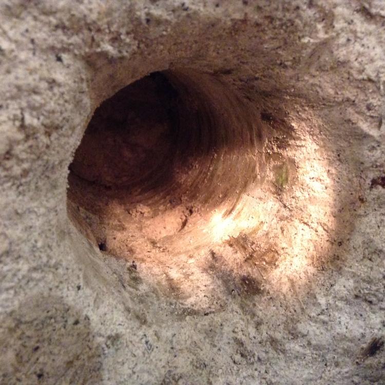

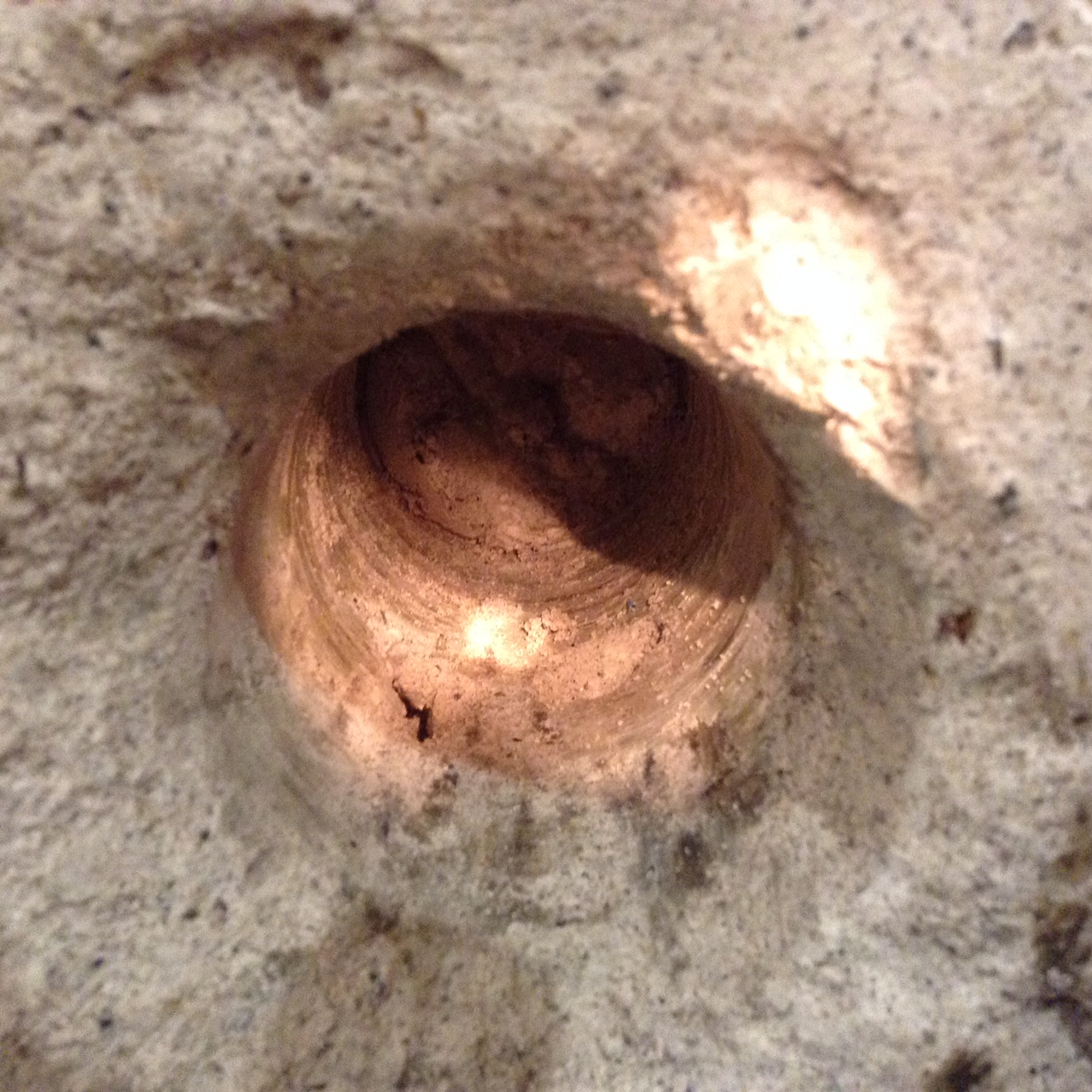

Forging Carver Posted December 17, 2015 Author Share Posted December 17, 2015 alright it is finished!!! I am so thrilled I got the thing out. It is made from a 2 pound soup can and the insulator is one part plaster of paris, one part sand, and enough water to five it a clay like consistancy. The area where the propane will enter is a 1/2in pipe nipple. There are two holes that may have been from me trying to pry the container out, so is it fine how it is, or should I make a small batch of the mix and patch it up? Lastly, is the entrance for the propane too far back? It is literally at the back of the forge. I think this will work how I want it pretty good! Thanks Quote Link to comment Share on other sites More sharing options...
ThomasPowers Posted December 18, 2015 Share Posted December 18, 2015 CURMUDGEONLY RANT ON! (You have been warned!) IMNSHO you should break it out and rebuild it with a real, insulative refractory and not waste money on gas using plaster of paris and sand! Whoever posted that recipe on the net should have been horsewhipped. (People keep telling me that they couldn't afford to buy kaowool and so used plaster of paris and sand or in other words "I couldn't afford to spend $20 so I'm going to spend $100 extra in fuel instead and so save money!) Everybody I know who has actually tried to use the PoP&S has found that it doesn't work worth a hood---you loose too much heat and plaster of paris doesn't last at forge temperatures it converts back to its original form. (in fact a campfire will do it, as shown out here at White Sands) Quote Link to comment Share on other sites More sharing options...
Forging Carver Posted December 18, 2015 Author Share Posted December 18, 2015 Ah darn I wish I would have known. Every video on the soup can forge used this pasted and Paris and sand mix. Oh well, you live and you learn. At least I know for next time. So what exact stuff should I use instead? They are fairly simple to make anyways. I made mine through a video by a guy named nighthawknlight on YouTube. https://m.youtube.com/watch?v=jBVa2bw3r_k it wasn't until after I finished the forge when I found this. http://www.zoellerforge.com/coffee.html. Should I follow this instead? Sorry if this was answered, but I could not find the answer. Sorry if this was a little choppy and didn't make sense but something is going on and I am kind of worried about my brother. Thanks for the help. Quote Link to comment Share on other sites More sharing options...

Frosty Posted December 18, 2015 Share Posted December 18, 2015 While there are good things to see on Youtube it's NOT the place for a beginner to break into any craft. Anyone with a camera and a connection can "publish" what they've done. Searching the web has become harder over the years with advertisers "suggesting" things you MIGHT be interested in, the folk who make our browser software get paid by advertisers to subvert our efforts at finding what we actually need. For example I just searched "insulating refractory" and got several pages of hits most of which were companies selling insulation, services insulating houses, walk in refrigerators, fish packing facilities, etc. I was pleasantly surprised to see half a dozen at least mention refractories on the first page and a few makers I recognized. Search youtube for bean can forge and what you get are pages and pages of folk trying to figure out how to make one and posting what they did as if it were a success. I didn't do more than read titles so in all honesty I don't know if any of these intrepid "inventors" posted what happened IF they got a PoP&S forge liner even close to forging temperature. They almost undoubtedly couldn't build a burner that'd do it anyway. Not only is it a fail as an efficient liner it wont take the heat you'll be lucky if it doesn't fail explosively and only spalls unpleasantly. Don't wear open top shoes or boots, you won't enjoy the HOT chips and flakes in your shoes. If a person insists on making their own refractory, castable or rammable research it and ignore Youtube, Wiki, etc. try the library. There are GOOD books out there with specific formula and methods to make proper high temp refractory liners for furnaces, kilns and forges. One of my first attempts before I discovered I could buy high end refractory just a few miles from home was what I learned from a potter. Fire clay, grog and sawdust. Dampen the sawdust and mix it with the clay, sand mixture till it's reasonably evenly mixed, seal in an airtight container over night and test in the morning. If it clumps in your hand and breaks cleanly it's tempered and ready to ram in forms. The saw dust burns out during firing and you're left with a brick full of air voids. The practical problem is firing the things. Light insulating fire brick costs around 2x as much as hard brick because it takes a LOT longer to fire and it takes a number of hours at temp to vitrify it at all. And NO your propane forge isn't going to do it unless you want to keep it burning over night and SLOWLY turn it down and let it cool. So much for saving anything by making it rather than buying it. My parents called that kind of thinking, "Penny wise dollar foolish." I don't know how many pages there are on Iforge about building and lining propane forges, I'd be surprised if there weren't a sub section dedicated to bean can forges themselves. Think of searching Iforge? You k now the largest most active blacksmithing site on the internet? The one with an entire section about gas forges? Judge Milian of People's Court fame often relates an old Cuban sayings, "The easy comes out hard," and "The cheap comes out expensive." Truer words were never spoken. Frosty The Lucky. Quote Link to comment Share on other sites More sharing options...

Frosty Posted December 18, 2015 Share Posted December 18, 2015 1 minute ago, mutant said: Well, I say you did a great job. Use it and have fun. I'm sure it has benefits and short comings. No biggie, it's not going to be the last furnace you ever build. Make, learn improve! Keep us informed, I live for this kind of stuff. -m You're trying to make our point about just anyone saying whatever they want regardless of knowledge or experience for us? Let me summarize for you. That liner is not only inefficient it's DANGEROUS. Frosty The Lucky. Quote Link to comment Share on other sites More sharing options...

Frosty Posted December 18, 2015 Share Posted December 18, 2015 The real part of this section of the learning curve is figuring out who to ignore. There is NOTHING "great job" about that forge. Your comment is part of the problem and you're rationalizing now. <Ph> Quote Link to comment Share on other sites More sharing options...

Frosty Posted December 18, 2015 Share Posted December 18, 2015 Look through the yellow pages and call a local HVAC company. Modern boilers and furnaces commonly use ceramic blanket, various types of fire brick and kiln washes. If the one you call (on the phone) doesn't carry or sell what you're looking for they will know who does. The outfit we get most of our refractories from is in Anchorage and gives the Association a great discount and it's actually hard to get away without them loading you up with rems from furnace jobs. Legally they can't use rems on a client's job so it's trash. Most furnace guys LIKE fire and are willing to talk fire just be polite and don't waste too much of their time. Frosty The Lucky. Quote Link to comment Share on other sites More sharing options...
