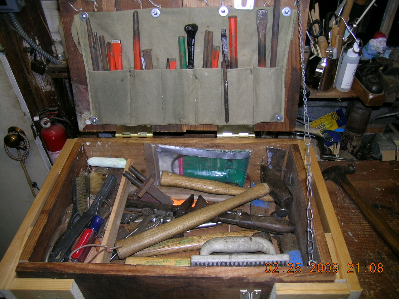

Michael Posted March 13, 2017 Share Posted March 13, 2017 I made a punch block out of sections of 2x4, held together with glue and a scrap of sheet metal bent around the bottom and nailed in place. Keeps getting filled up. in the portable tool box that goes to hammer ins and demos, a cloth roll screwed to the lid of the toolbox works. Quote Link to comment Share on other sites More sharing options...

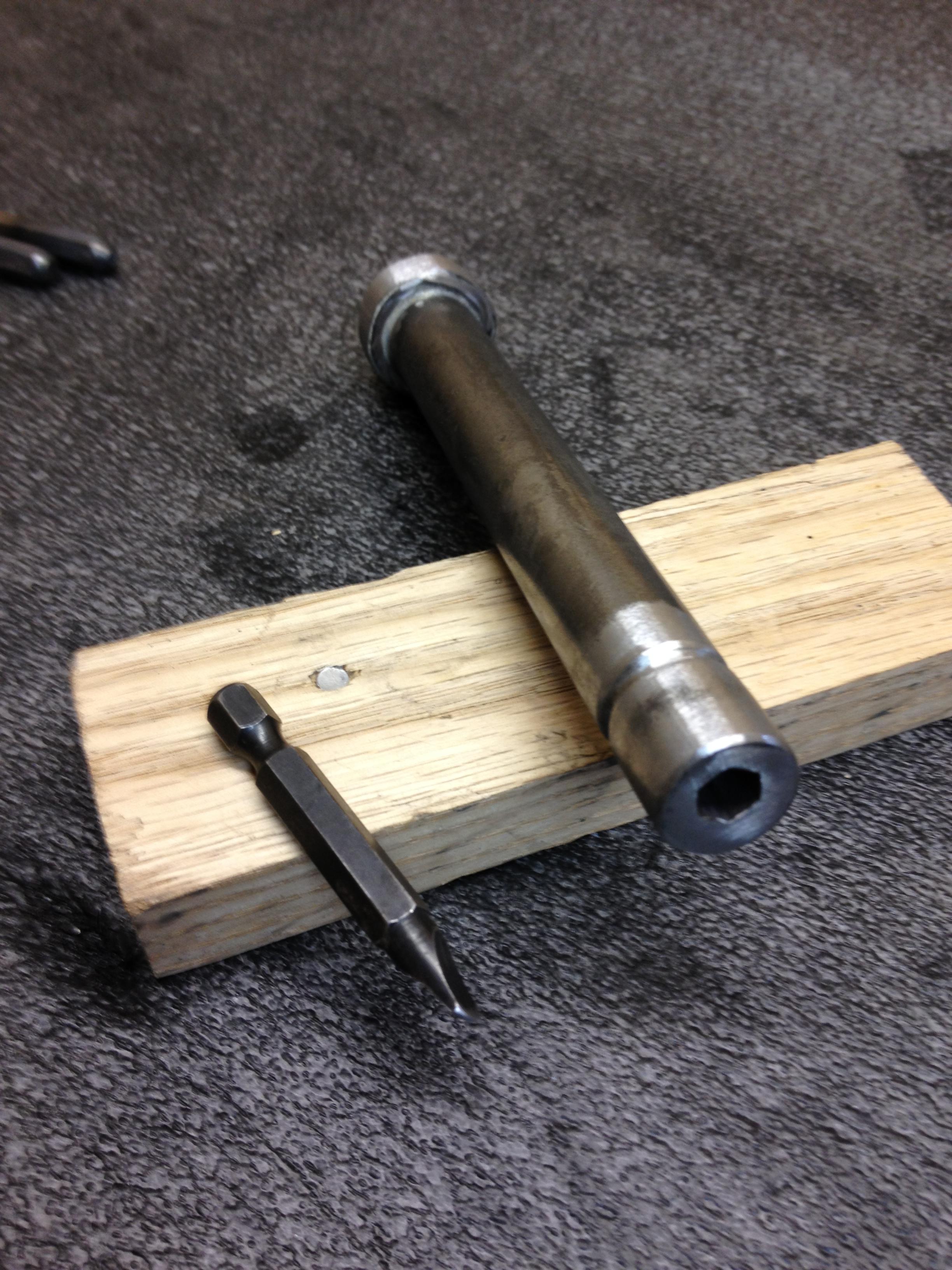

Jim Coke Posted March 14, 2017 Share Posted March 14, 2017 Greetings Vaugn/Frosty No trump card intended... I have been at it a tad longer than most and just try to pass on ideas . For small detail chisels and drifts I made up these tools that use old or new screw driver bits . Most are already hard and only require a small amount of grinding. Saves a lot of storage space and is convient at the treadle hammer., Forge on and make beautiful things Jim Quote Link to comment Share on other sites More sharing options...

Jim Coke Posted March 15, 2017 Share Posted March 15, 2017 Greetings Das/Papy. Just thought I would give you a suggestion on how I made the internal hex . I call it the Blacksmith broach. 1st. Drill a 7/32 hole in the repurposed welding hammer or the 5/8 bolt about 1/2 deep.. 2nd heat the end and drive a scrap bit into the whole with some anti-seeze lube 3rd Remove the bit ... reheat to yellow and reinstall the bit.. Quickly reform the tool around the bit... You now have an internal hex blacksmith broach.. I also weld a rounded top on the welding hammer and crown the top.. Just a little grinding to the bolt top works well.. I have tried several ways to hold the bit into the tool and found that a rubber band works best. Handy little set up. Have fun Forge on and make beautiful things Jim Quote Link to comment Share on other sites More sharing options...
