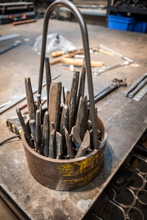

As that holder is on the bench to hold all my little chisels and sundry, I thought I might make something a little different for larger pieces used at the anvil.
I found a picture online and kind of fell in love with the idea, so it'll be built just as soon as I get a round to it....
I have some 8" pipe that would make a dandy "basket" and plenty of scrap expanded metal to make the grate inside.  I like the simplicity of the design -- almost thought about dressing it up with some decorative forging, but then I got the notion that the reason the think is so attractive is because of its rugged industrial-ness.  Everything about it looks "right" and I'm sure if you had a few of these hanging around at a demo that people would remark positively on them.
Can you imagine her all filled up with a nice selection of hot-work tools like Jim's block of wood?  Maybe even do a wooden insert like Jim's to keep the tools from tilting one way or another as the expanded metal will allow?!?
