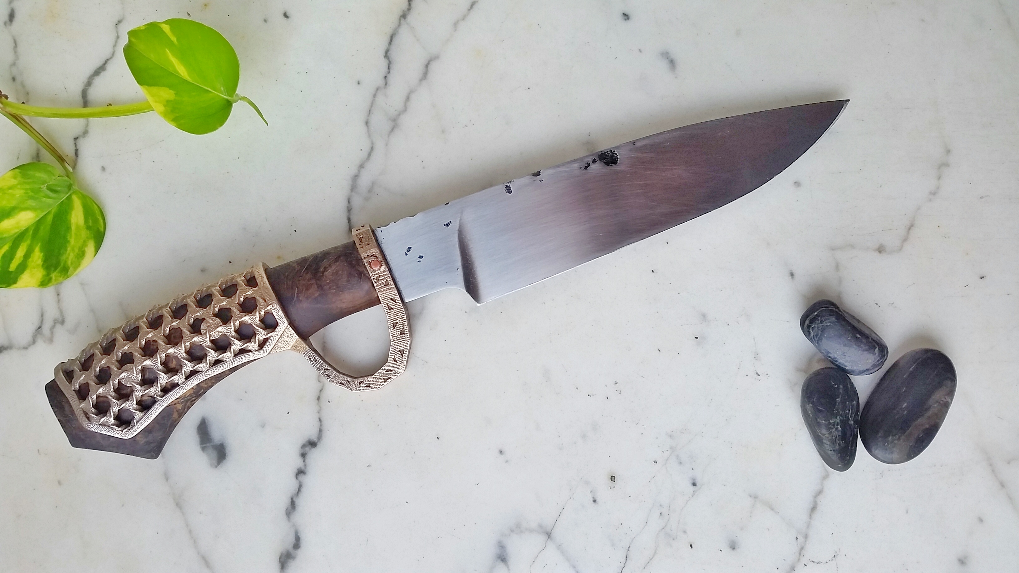

TheoRockNazz Posted October 27, 2015 Share Posted October 27, 2015 Hello again,Here is the piece I've been working on for several months, and even have a patent pending for aspects of. The honeycomb mesh is lofted 1mm-2mm, and allows for air flow under the palm in an attempt to maintain a solid grip through sweat/blood/etc. Swinging it around you feel a slight breeze under your hand. Here it is with the folder version (that I've been using heavily):The blade is W2 with a random hamon. After polishing to 1200 I gave it a quick hot blue, something I want to start doing for all my blades... however I then made the mistake of wiping it down after with 1200 grit in random directions, fudging up the satin finish a bit. Wood's stabilized burl for easy cleanup when it does get dirty, which it will; I plan on putting this design through it's paces after some more glamour shots. This'll probably be the first knife I send off to Sharp's or Point Seven... then I'll beat the living snot outta it. This is a prototype, and I can already see there are areas that can be improved. Where the ring join in the subhilt area needs to be perpendicular. I have to print and cast a thinner mesh to reduce weight and reduce the offset of the lofted mesh. The flow from the blade to handle could be smoother. While the edges of the printed components are rounded off and comfortable to hold, only once I start using it will I know for sure if they will need to be rounded off more.Let me know what ya'll think,Theo Quote Link to comment Share on other sites More sharing options...

Frosty Posted October 28, 2015 Share Posted October 28, 2015 Did someone tell you to get a grip Theo? Nice grips though I'd have to give them a working to decide if the pattern is so large as to be too rough.A friend of mine in Boyscouts hand checkered the handle on his knife and it was such a great improvement one of the other kids checkered his but made it "better." Really large cuts and it wouldn't slip but it would wear a kid's hand raw after a little while.As much as I like that handle it brings the memory of a fellow scout's knife. Just remembering and thinking.Frosty The Lucky. Quote Link to comment Share on other sites More sharing options...
TheoRockNazz Posted October 28, 2015 Author Share Posted October 28, 2015 Sorry Theo, Can't tell a thing from the pics. Please send it to me for further inspection, postage paid of course...... DaveHaha, yeah, I'll ship it tomorrowDid someone tell you to get a grip Theo? Nice grips though I'd have to give them a working to decide if the pattern is so large as to be too rough.A friend of mine in Boyscouts hand checkered the handle on his knife and it was such a great improvement one of the other kids checkered his but made it "better." Really large cuts and it wouldn't slip but it would wear a kid's hand raw after a little while.As much as I like that handle it brings the memory of a fellow scout's knife. Just remembering and thinking.Frosty The Lucky.Just gotta beat the snot outta it see how it holds up and feels. A finer pattern would probably be better, but the printers that can achieve that level of detail are out of my budget Quote Link to comment Share on other sites More sharing options...

ThomasPowers Posted October 29, 2015 Share Posted October 29, 2015 Ok looks like I got gigged by the disappearing post gremlin: I like the idea of the air flow and the positive grip aspects but I think cleaning it after a messy job will be an issue---especially as soaking it is probably not a good idea with that blade...As a display piece it's beautiful! Quote Link to comment Share on other sites More sharing options...
TheoRockNazz Posted October 29, 2015 Author Share Posted October 29, 2015 Ok looks like I got gigged by the disappearing post gremlin: I like the idea of the air flow and the positive grip aspects but I think cleaning it after a messy job will be an issue---especially as soaking it is probably not a good idea with that blade...As a display piece it's beautiful! Yeah, I'm still working on that aspect. I would like to evolve the design into one that can be disassembled for cleaning without sacrificing structural integrity. The blade is hot blued, so for a little while cleaning would be easy, but as that blue wears off it'd get ugly. Just got some great critique from Bill at Mastersmiths; the blade needs to have more consistent spotting/hammer marks, or be completely clean, or patternwelded. I agree Quote Link to comment Share on other sites More sharing options...
ThomasPowers Posted October 29, 2015 Share Posted October 29, 2015 think it would work well with a mustard patina with the random "spotting" looking like pitting on an old piece, probably need to "age" the grip as well... Quote Link to comment Share on other sites More sharing options...

Frozenthunderbolt Posted November 5, 2015 Share Posted November 5, 2015 Hey Theo, I can finally comment! Great knife - if you want to make the printed part demountable for cleaning then what about replacing the pins with grub screws on either side, and put a minor depression into the spine of the blade beneath to locate them. Easy to remove with a hex key then. Quote Link to comment Share on other sites More sharing options...
