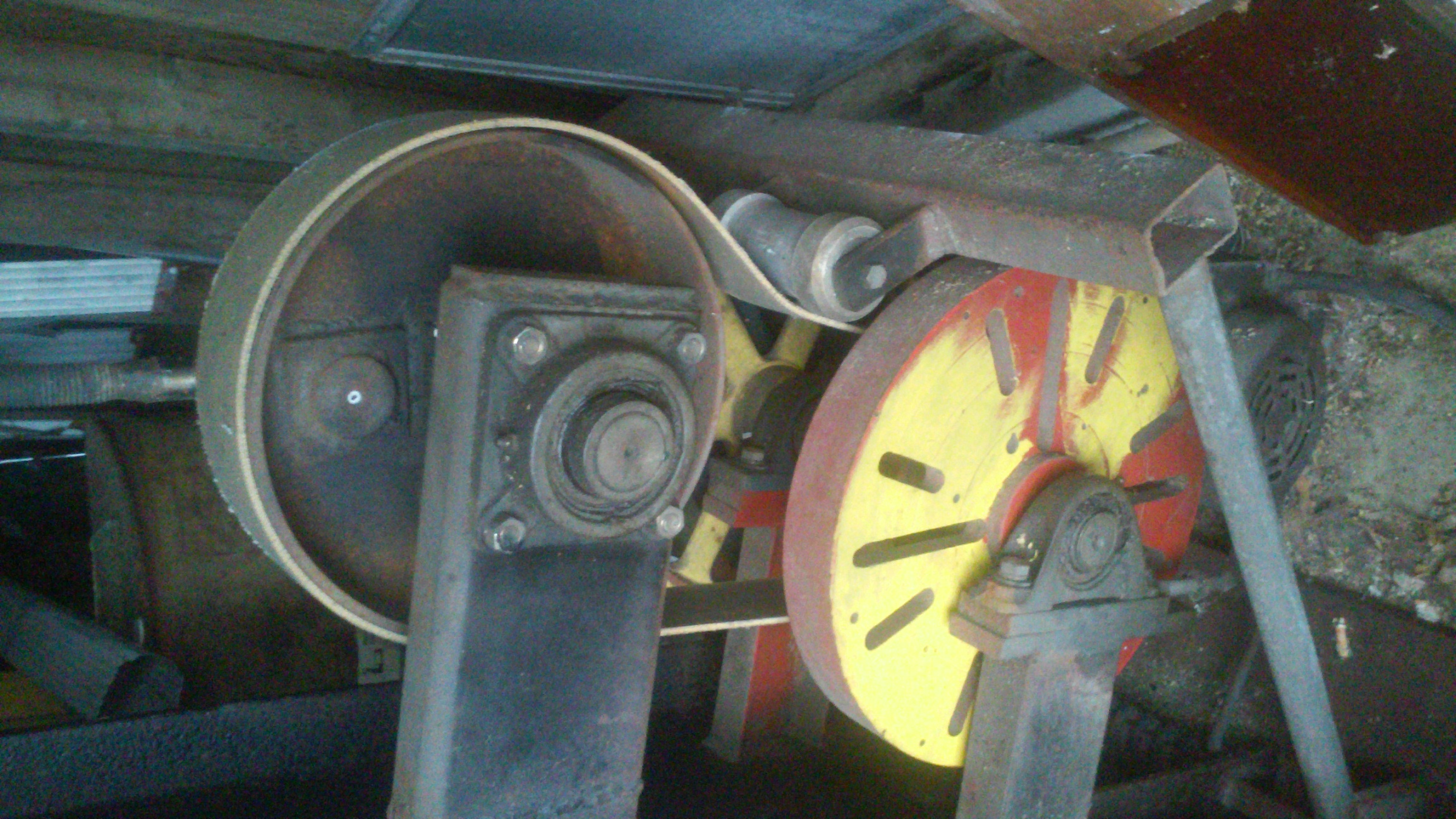

arftist Posted April 4, 2016 Share Posted April 4, 2016 I would build a guided spring helve hammer if it were me. The problem with the rusty design is that there is no intermediate flywheel. The slack belt clutch works directly between the motor and the pitman shaft. This leads to slow jerky starts and excess belt wear. I solved this issue by installing an intermediate jackshaft with flywheels. The motor spins the jackshaft with 2 tight vee belts. Then a flat belt pulley in the middlde of the jackshaft transfers the power through a wide flat power transmission belt. This belt is run slack and tensioned by a ball bearing equipped idler pulley actuated via a foot petal. This has resulted in very powerful smooth blows and belts are still in service after 11 years. The spare tire drive is nothing more than a clutch; a slack belt clutch is actaully far superior and much simpler. In fact the tire drive is really no improvement since one is attempting to spin the entire hammer mechanism from the tourque of the motor alone. The weight of the tire agravates the strain it doesn't aid anything until high blows per minute when it does start acting as crude flywheel but rather unneeded at that point. In the long run a proper slack belt drive is far preferable. Remember even a little giant has a flywheel BEFORE the clutch rather than after it. It is every difference in the world. I ran a dupont linkage hammer that was rigged up without the flywheel. It required a heavy foot on the petal then a herd blow or two before settling into a usable controllable speed. That was the experience that made me design the flywheel drive. Link to comment Share on other sites More sharing options...

Furnace1 Posted April 6, 2016 Share Posted April 6, 2016 On 4/4/2016 at 5:02 PM, VaughnT said: I'm having a real hard time understanding what you're describing. I agree that the spare tire design is less than optimal, but it seems to me that it's a compromise to allow for a very small footprint and easy parts to source. Like JHCC, I'd love to see some photos or diagrams of your hammer design. I would like to see more of this also....I'm in the middle of a helve hammer build myself and have never been too enamored with the pulleys and belts flapping around on a rusty style hammer. That's why I have decided on the tire drive for mine where I can make a braking system as well, but this sounds interesting!...looking forward hopefully to pictures or diagrams. Link to comment Share on other sites More sharing options...
arftist Posted April 7, 2016 Share Posted April 7, 2016 On 4/4/2016 at 3:43 PM, JHCC said: arftist, do you have pictures/drawings of your hammer? Link to comment Share on other sites More sharing options...
JHCC Posted April 7, 2016 Share Posted April 7, 2016 8 minutes ago, arftist said: [picture] Let me rephrase: do you have pictures or drawings that show the intermediate jackshafts and flywheels? And the slack belt clutch? Your system sounds very interesting, but more information (especially a video!) would be extremely helpful. Link to comment Share on other sites More sharing options...

arftist Posted April 7, 2016 Share Posted April 7, 2016 Ok the last 3pics are sideways. This is the flywheel. It is an old 16" lathe faceplate. On the opposite end is a 16" double vee groove pulley. The motor (2hp Baldor 1750 rpm) drives the flywheel assembly via 2 vee belts (Gates power rated.) Betweeen the face plate and the vee belt pulley is a cast iron flatbelt pulley. The jackshaft runs on pillowblock bearings one of which is visible. When the motor is switched on this entire assembly spins. The idler is the aluminum pulley. This is connected to the foot petal. The idler pulley is fitted with sealed ball bearings. Above the idler is the pitman crank. The pitman is a slice of 14" pipe wich I crowned. The belt is 4 ply power transmission belt. The belts are all original. I showed the top of the machine to aid the visualuzation process. All of this running gear is behind the hammer and below the anvil. The base plateis 28x40"x 1.5"thick. The base plate could easily be smaller but I wouldn't go thinner purposely. This machine is markedly NOT top heavy. This hammer strikes at 220 b.p.m. The ratio is easy to acheive due to the two seperate beltdrives so there is no need to compromise and use a supper small motor pulley for the sake of achieving a significant speed reduction. Link to comment Share on other sites More sharing options...

JHCC Posted April 7, 2016 Share Posted April 7, 2016 Thanks for the photos, arftist. Much to think about. Could you give us a shot of the whole machine? Thanks! Link to comment Share on other sites More sharing options...
arftist Posted April 7, 2016 Share Posted April 7, 2016 1 minute ago, JHCC said: Thanks for the photos, arftist. Much to think about. Could you give us a shot of the whole machine? Thanks! Yeah not for a while. I am opening a new shop shortly. In the mean time I showed what I could get to. Do you understand the drive system clearly? Link to comment Share on other sites More sharing options...
JHCC Posted April 7, 2016 Share Posted April 7, 2016 Just now, arftist said: Yeah not for a while. I am opening a new shop shortly. In the mean time I showed what I could get to. Do you understand the drive system clearly? Yes, that makes much more sense now. Thanks. Let me know when the new shop is finished; I travel all over New England for business and would love to see it in person. Link to comment Share on other sites More sharing options...
arftist Posted April 7, 2016 Share Posted April 7, 2016 2 minutes ago, JHCC said: Yes, that makes much more sense now. Thanks. Let me know when the new shop is finished; I travel all over New England for business and would love to see it in person. That would be great. Sometime in June hopefully. Link to comment Share on other sites More sharing options...
arftist Posted April 7, 2016 Share Posted April 7, 2016 38 minutes ago, basher said: Arftist, I would have agreed with you on the fly wheel before clutch being of prime importance, however i have used a few very good hammers that omit this and still run very well. so it is not essential. Correct, it is not essential. It is however preferable and I daresay the hammers not so equipped would be improved for it. Smoother starts, better control and faster acceleration would clearly result due to the energy stored in the flywheel assembly. This is especially true in the case of tire cluthes where the mass of the tire resists movement in addition to the weight of the tup and associated moving parts. Link to comment Share on other sites More sharing options...

VaughnT Posted April 11, 2016 Share Posted April 11, 2016 On April 7, 2016 at 5:22 PM, arftist said: Ok.... Thanks, Arf. The photos clear up the confusion. You don't appear to have any kind of braking system on the pitman crank, correct? Also, I noticed your use of the turnbuckle and was curious to know how much practical adjustment this allows for. I was thinking about going the same route, but wasn't sure if it was worth it if it means having to build a second larger hammer if I want to get into larger work. The Preston tire hammer caught my eye because it can be adjusted very quickly. Coil springs are very common and can be found in a lot of machines, but most leaf springs have to be custom made because the ones you find on cars are stacked upside down and are too long between the eyes. From a corporation's standpoint, it would have been a lot cheaper to buy a standard COTS coil spring from the spring maker or wholesaler rather than have custom leaf springs engineered and made just for your hammer style. Even today, the average joe-in-the-garage can look up coil springs on the internet and find one from any of a dozen sources that will work well for his home-built hammer. Leaf springs, as beautiful as they are, would have to be custom made. Link to comment Share on other sites More sharing options...
arftist Posted April 11, 2016 Share Posted April 11, 2016 41 minutes ago, VaughnT said: Thanks, Arf. The photos clear up the confusion. You don't appear to have any kind of braking system on the pitman crank, correct? Also, I noticed your use of the turnbuckle and was curious to know how much practical adjustment this allows for. I was thinking about going the same route, but wasn't sure if it was worth it if it means having to build a second larger hammer if I want to get into larger work. The Preston tire hammer caught my eye because it can be adjusted very quickly. Coil springs are very common and can be found in a lot of machines, but most leaf springs have to be custom made because the ones you find on cars are stacked upside down and are too long between the eyes. From a corporation's standpoint, it would have been a lot cheaper to buy a standard COTS coil spring from the spring maker or wholesaler rather than have custom leaf springs engineered and made just for your hammer style. Even today, the average joe-in-the-garage can look up coil springs on the internet and find one from any of a dozen sources that will work well for his home-built hammer. Leaf springs, as beautiful as they are, would have to be custom made. My spring pack cost $60. The leaves were cut and straightened while I waited. Most of the hammer was custom made. The turnbuckle gives plenty of adjustment but I wouldn't use one again. A round rod running in a tube. A split clamp on the end of the tube tightened with one bolt. Much faster than a turnbuckle. Really not sure what your point is about the coil springs. These are one off hammers mostly made by their owners. When engineering for ones own use one can place more enthesis on performance/longevity and less upon widget cost. Link to comment Share on other sites More sharing options...
