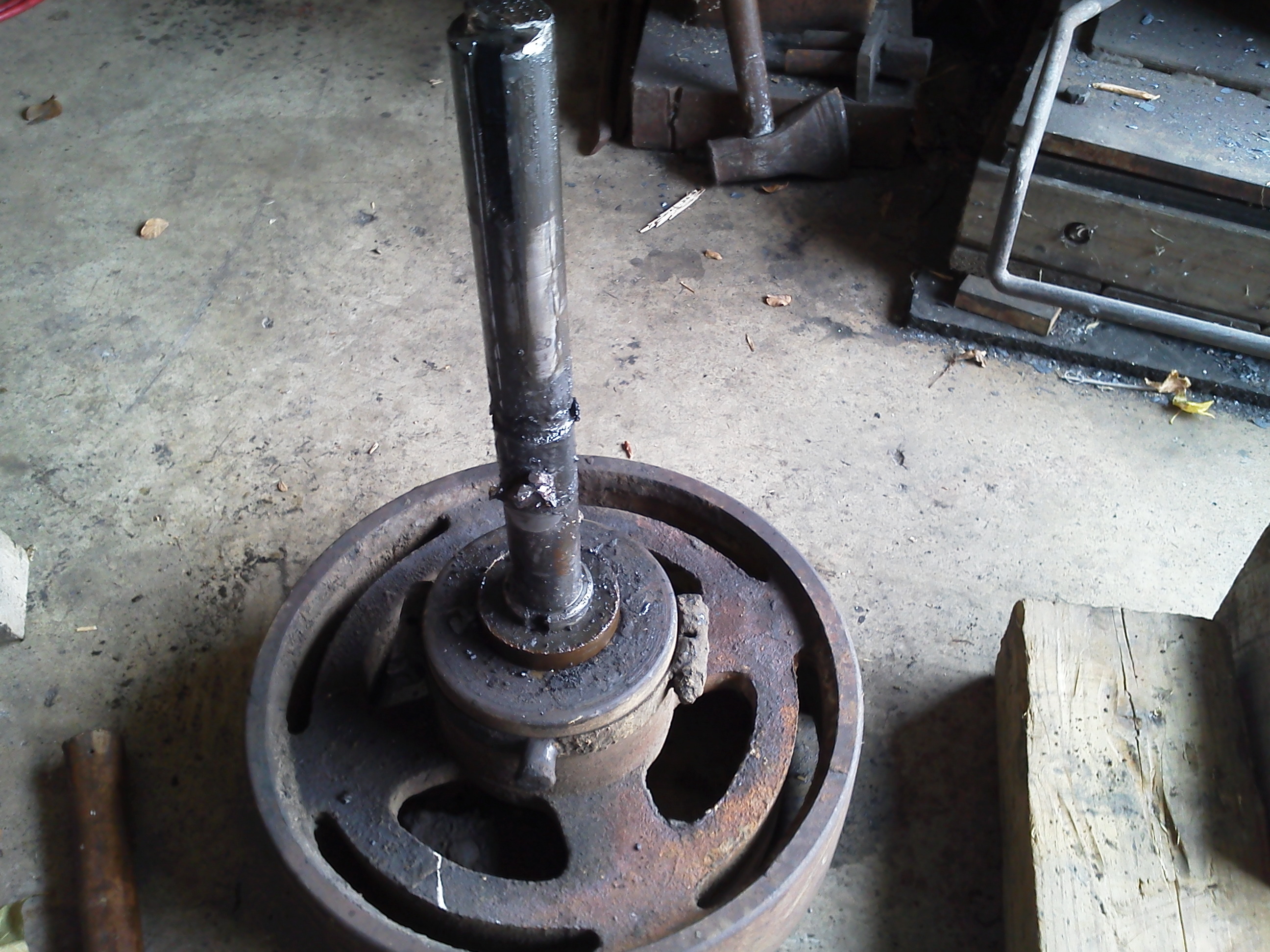

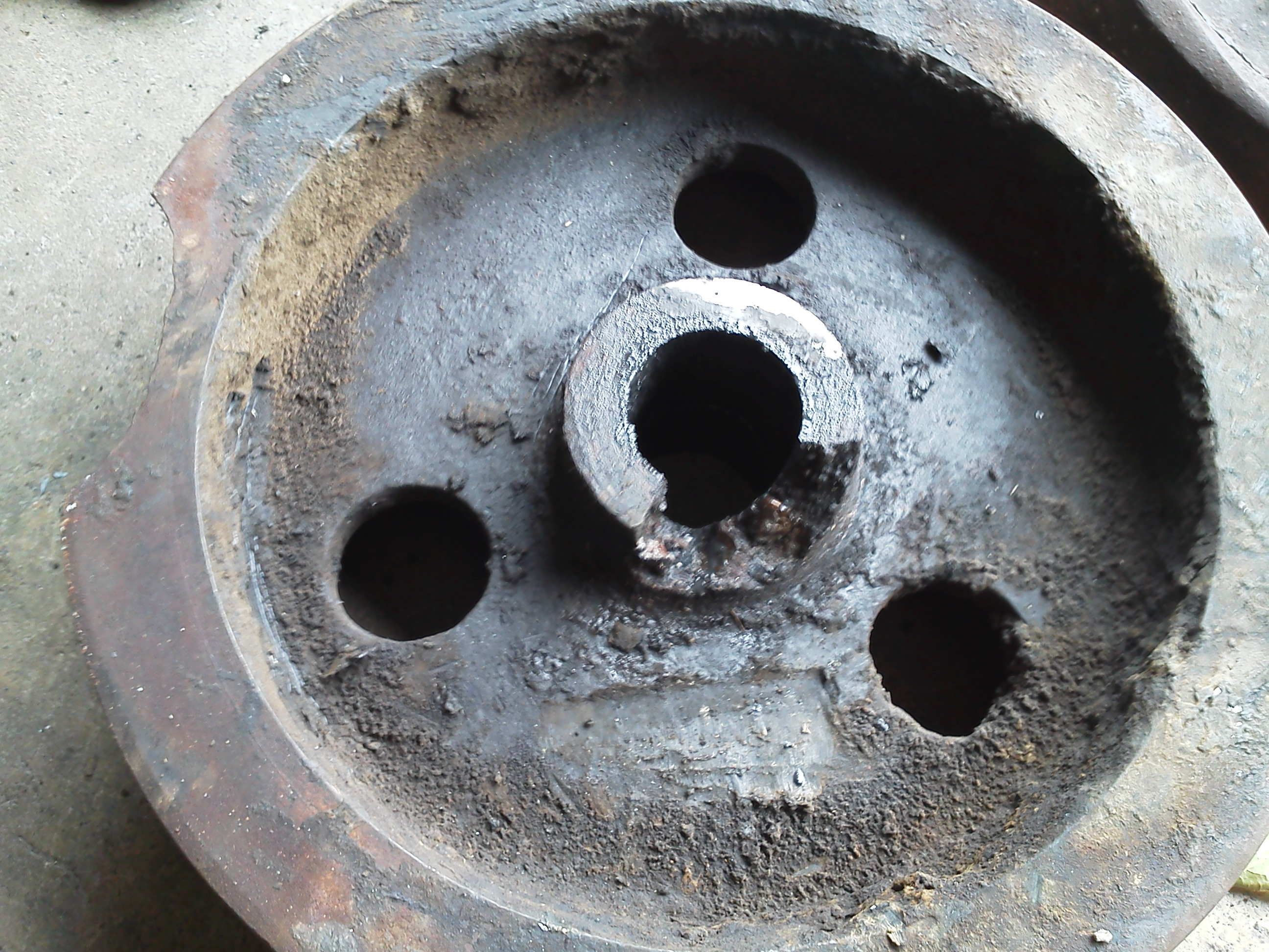

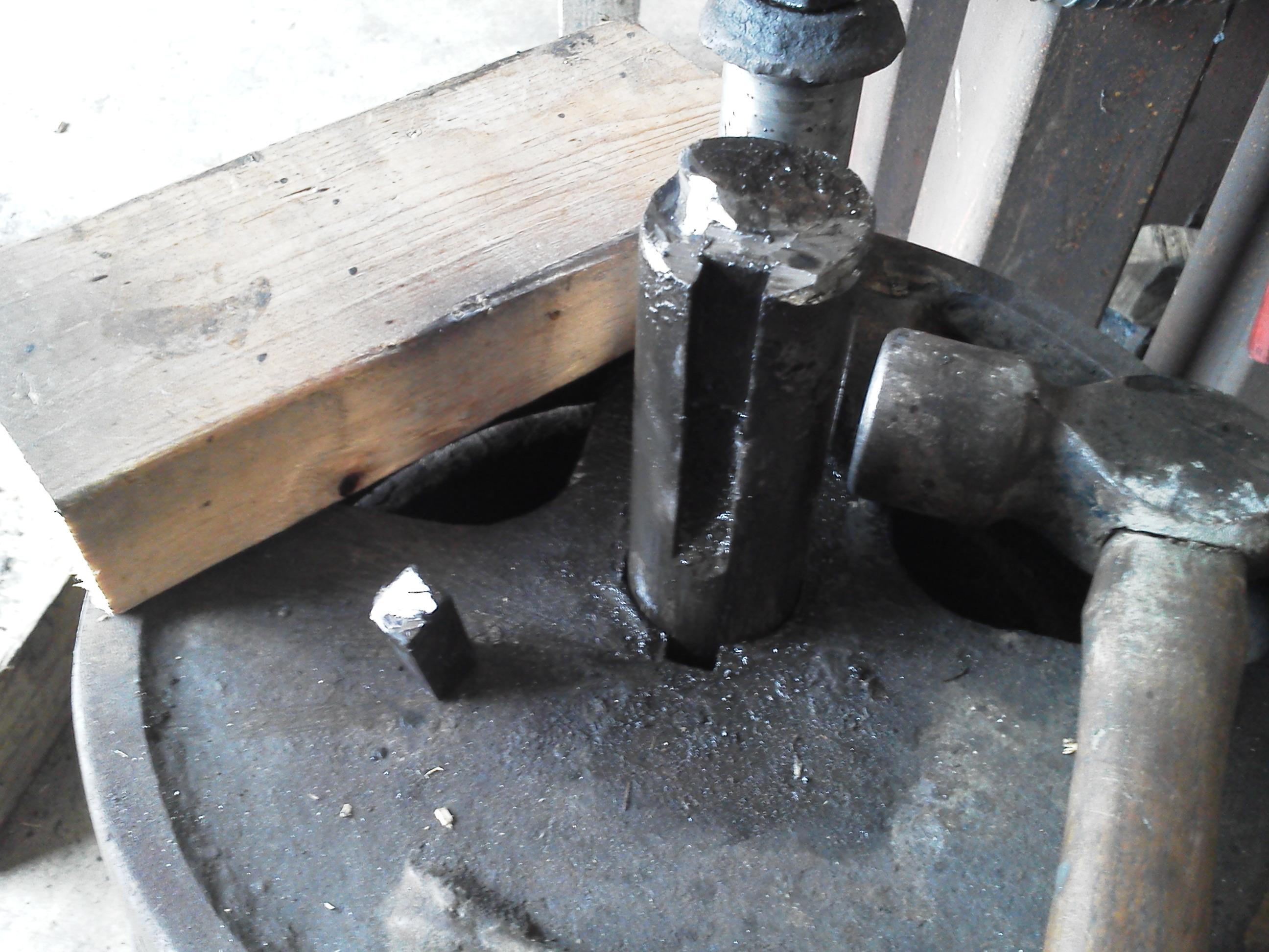

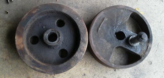

Joel Worley Posted October 9, 2015 Author Share Posted October 9, 2015 Today I got the crank plate and pulley off of the shaft. It was no easy task. The shaft was from a Little Giant and was slightly smaller than the original and someone had attempted to weld the pulley in place and had peened the end to hold the crank plate in place. At last the LG parts are not a part of the Champion Hammer. The pulley has a very old break on the hub and a small chunk missing from the flange but I think it can still be used. Quote Link to comment Share on other sites More sharing options...

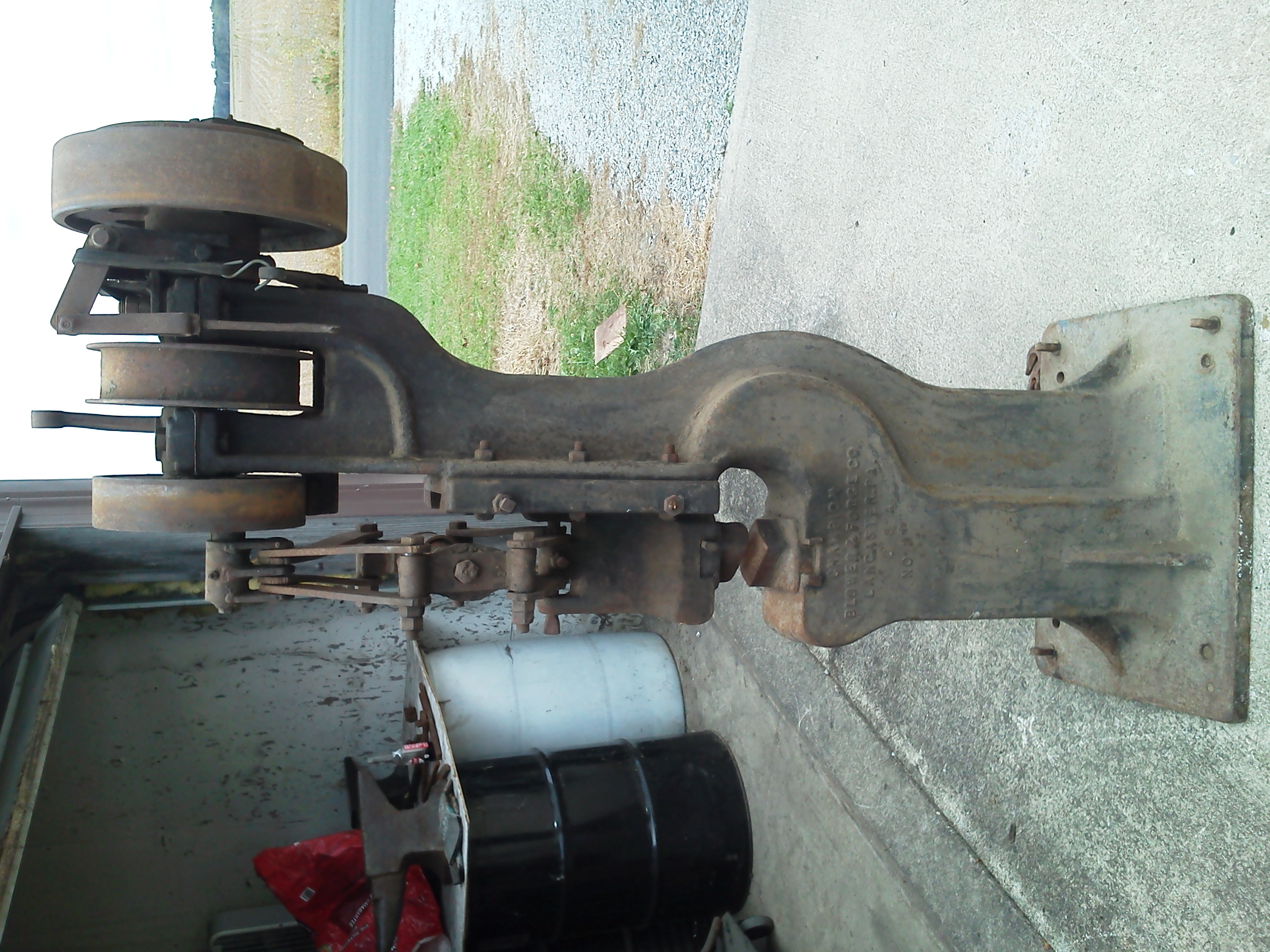

Joel Worley Posted October 11, 2015 Author Share Posted October 11, 2015 After a some consideration, I think it would be best to move the original pulley to the rear of the hammer, relocate the idler pulley and mount the motor near the floor as on the E- models. This decision is mostly due to the fact that I have a low ceiling in my shop and the spot I am planning to put the hammer is even more limited on head room as it sits between the tracks of two over head doors. If I mount the motor or even a jack shaft above the hammer, it will have to sit tight between the tracks, limiting even further how I can position the hammer. Since I am making a new shaft it won't be a big deal to set it up with the pulley on the back. Does anyone have this set up on their Champion? If so I'd love to hear some thoughts on motor mounting options. Quote Link to comment Share on other sites More sharing options...

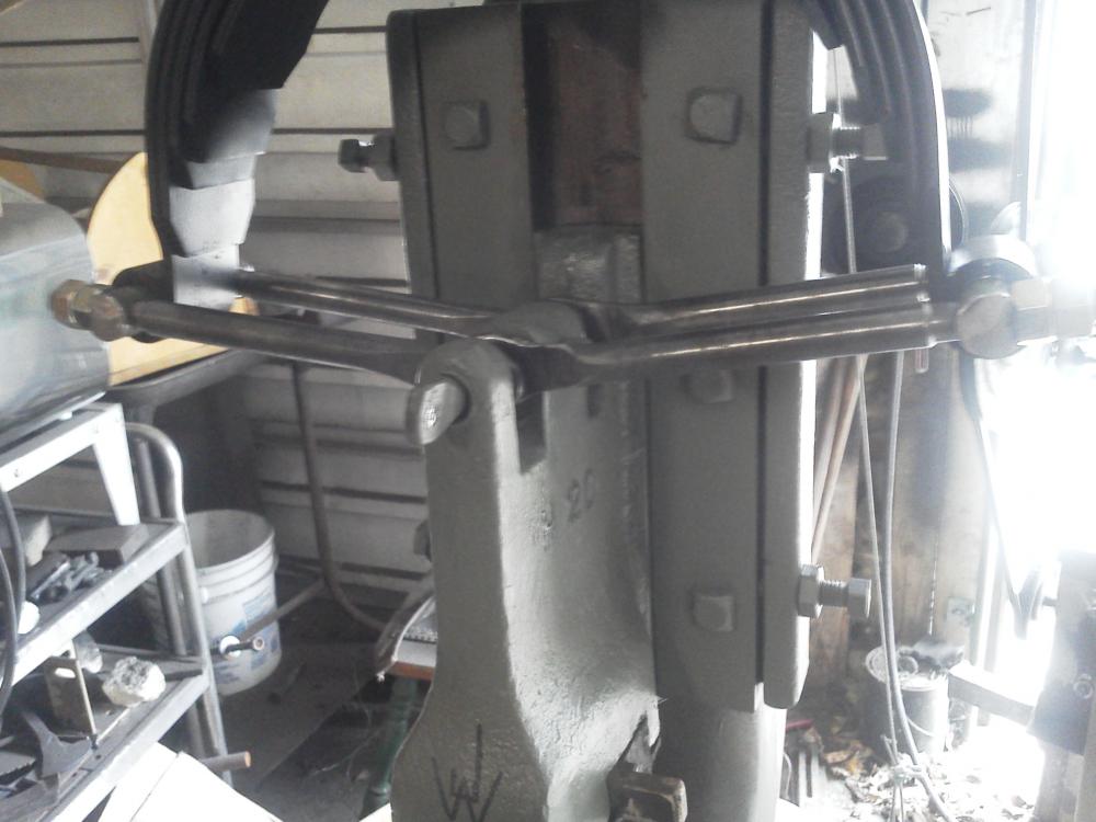

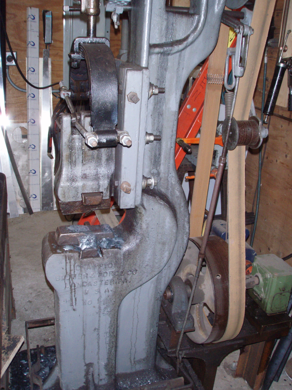

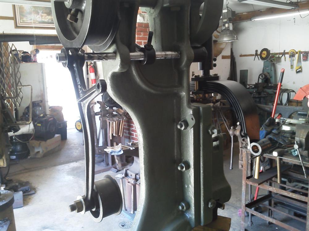

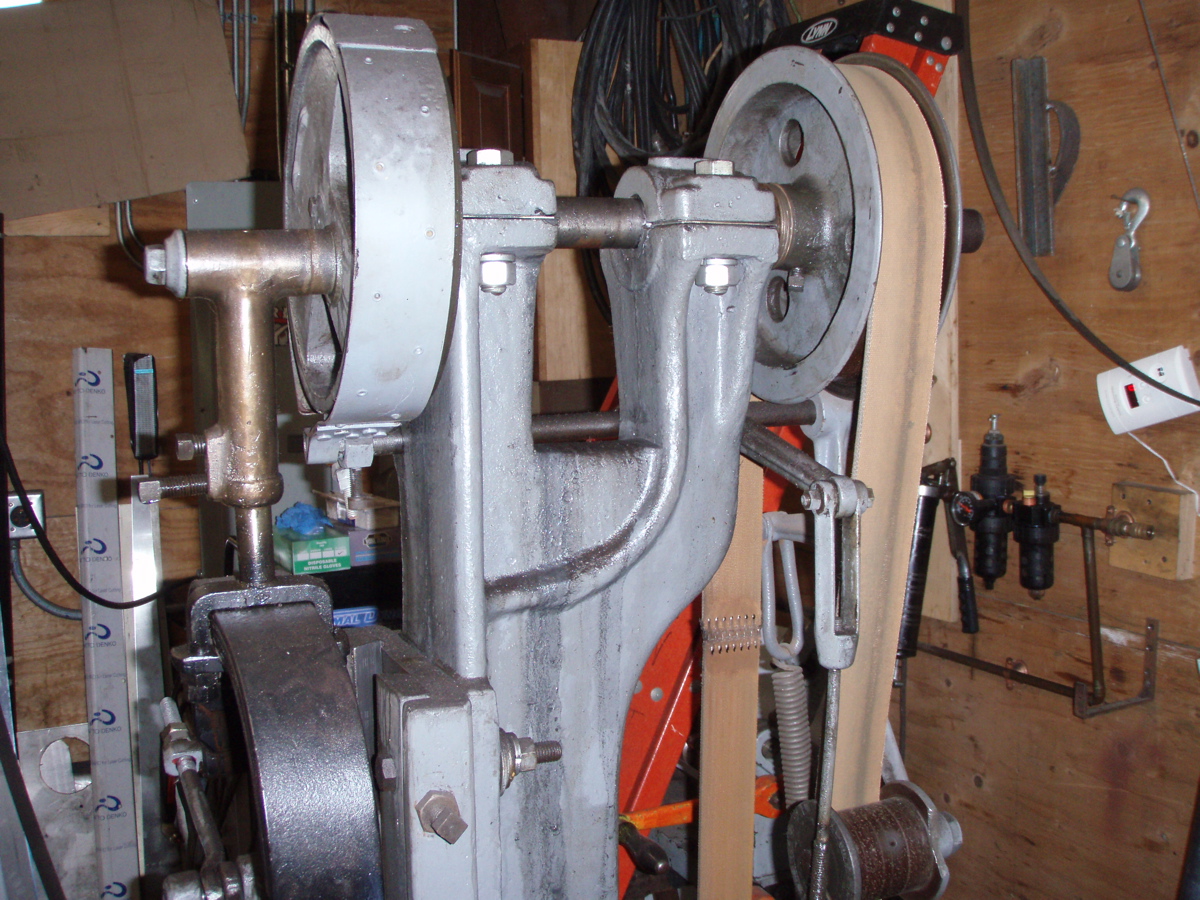

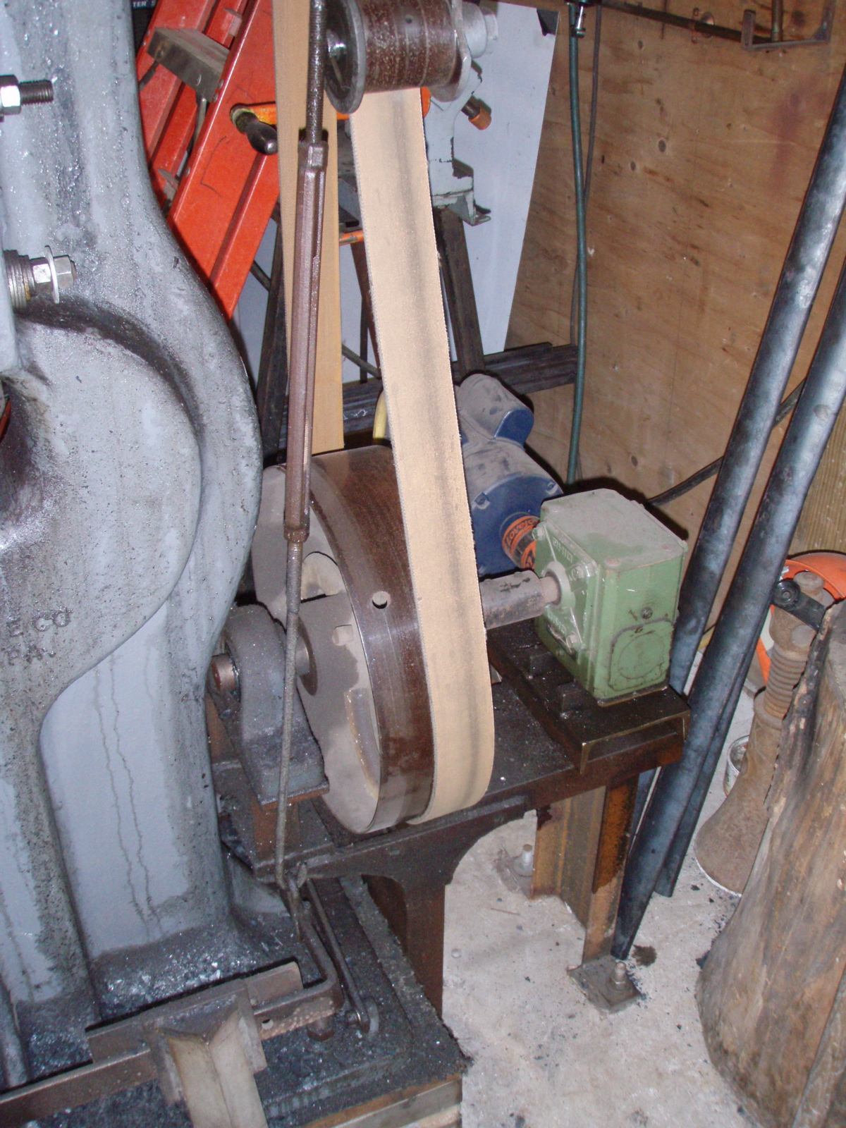

Judson Yaggy Posted October 11, 2015 Share Posted October 11, 2015 Here you go. This is a friend's hammer we have installed at work. Runs like a dream and start and stops on a dime thanks to the break. Quote Link to comment Share on other sites More sharing options...
Joel Worley Posted October 11, 2015 Author Share Posted October 11, 2015 Thanks for the pictures Judson. That helps a lot. Can't wait to get mine running. Quote Link to comment Share on other sites More sharing options...
ThomasPowers Posted October 11, 2015 Share Posted October 11, 2015 I have one with the original cast iron motor mount at has a U shaped piece that goes around the hammer frame with a bolt through it. no jackshaft. Quote Link to comment Share on other sites More sharing options...
Joel Worley Posted October 12, 2015 Author Share Posted October 12, 2015 I'll probably run mine directly from the motor. I like how the original idler pulley arm is still used on a longer shaft in the pictures Judson posted. Quote Link to comment Share on other sites More sharing options...
