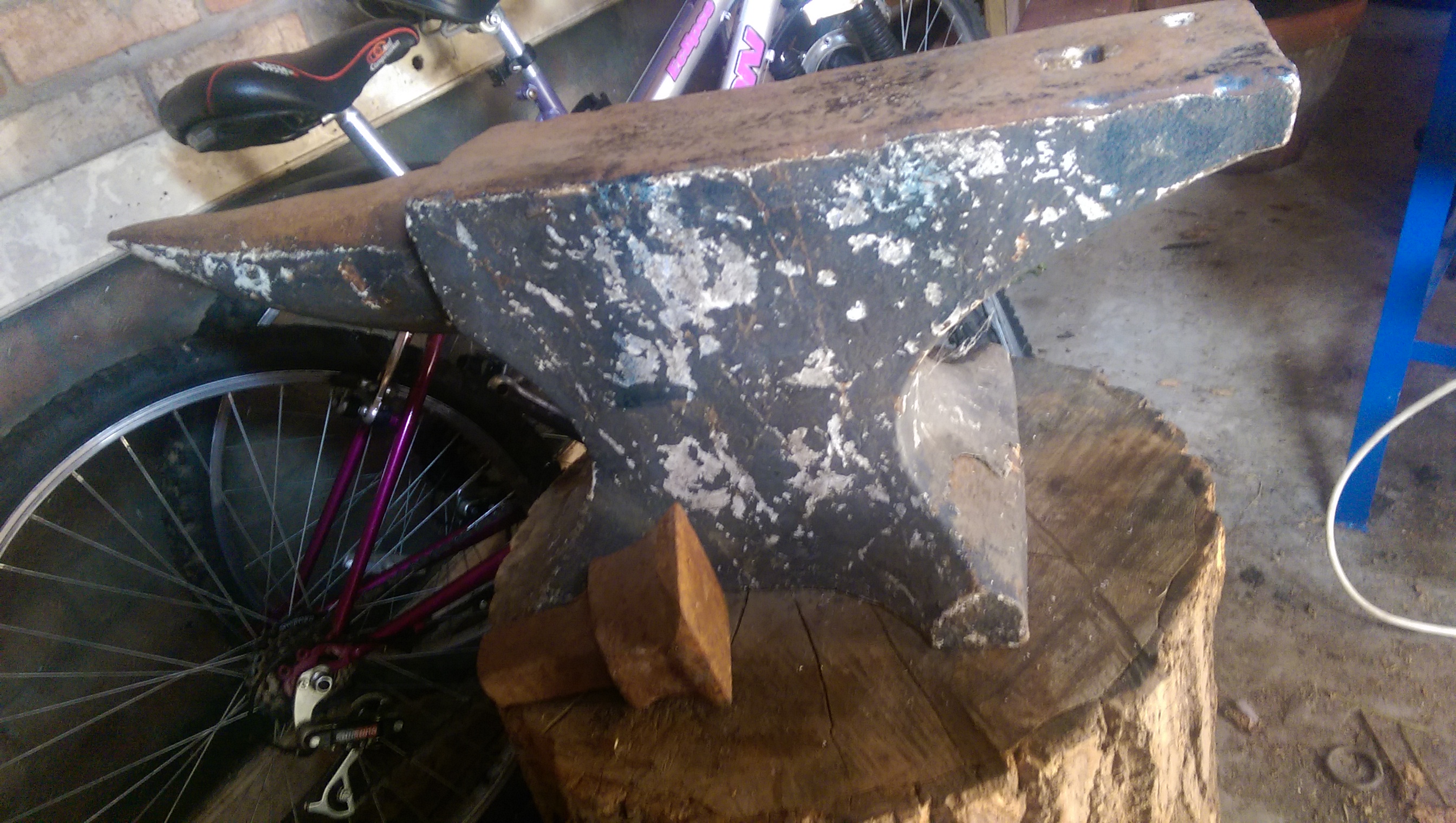

JamesH Posted October 4, 2015 Share Posted October 4, 2015 (edited) Title said it all, just lookign to learn something before I start using it. Bought off a farmer who used to do some forgework but then left it to their farrier, you can see on the face the distinct imprints in places from the shoes. This is in Warwickshire, England if that help the identification, and by my estimates weighs easilly over 100kg. It has been painted black but theres also evidence of blue too.Very new to this so any advice is very welcomeThe photo with the ruler is just the square face. Including the horn it extended past the ruler. Edited October 4, 2015 by JamesH aditional indo Quote Link to comment Share on other sites More sharing options...

Nobody Special Posted October 6, 2015 Share Posted October 6, 2015 Best reccomendation, clean off the paint. with a stripper, something similar, or a light go with the wire brush. (Can always repaint later if that's the look you want.) Then if you still don't see markings, try rubbing flour or baby powder or some such into the sides to bring faint markings into better contrast. Look for markings on both sides, and usually around the feet at the front and back.If that doesn't do it, post pics of the sides, front and back, and the bottom (sometimes there's a depression, and the shape may give a clue). You'd be surprised what some of the people on here can do with the faintest of marks.By shape, english anvil, vaguely shaped like a mousehole or a foster, but then there were literally hundreds of English makers. Pritchell holes became prevalent post-1820-ish, but many were drilled in later. It almost looks like it's messing the step on the horn?Either way, the most important part is it's a large piece of wrought iron and steel that you can perform topological reformation of ferrous metals while in a thermally excited plastic state. Looks like it's in decent shape. Quote Link to comment Share on other sites More sharing options...

Frosty Posted October 6, 2015 Share Posted October 6, 2015 (edited) Welcome aboard James, glad to have you.I've never seen an anvil with a tapered face like that, IF it isn't an illusion from camera angle, lighting or some such.Another trick for bringing out details in photos is to use oblique lighting, a flash will reflect straight back and glare out the details. If you lay the light to shine across the face and shoot straight on, details will really stand out. . . Well, much better anyway.Other than photo tips I'm with Thomas, put her to work, even a cast iron junk anvil shaped object will work under steel that's hot enough. Long enough to buy a good anvil that is.Frosty The Lucky. Edited October 6, 2015 by Frosty Quote Link to comment Share on other sites More sharing options...

JamesH Posted October 8, 2015 Author Share Posted October 8, 2015 Pictures are here!I can make out 3 numbers on one side, which are; "2 2 19" and on the other I can just make out a circle nearer the top. but it's very hard to see in person let alone on camera.Frosty using daylight and shinging it at an angle worked a treat!Also took photo of the base, feet, and different angles. Quote Link to comment Share on other sites More sharing options...

ThomasPowers Posted October 9, 2015 Share Posted October 9, 2015 Postman has documented over 200 English anvil makers so far IIRC. Not knowing the maker won't change it's usability at all!2 2 11 is a weight in the CWT system: 2 x 112 + 2 x 28 + 11 so a stout lad! Quote Link to comment Share on other sites More sharing options...
