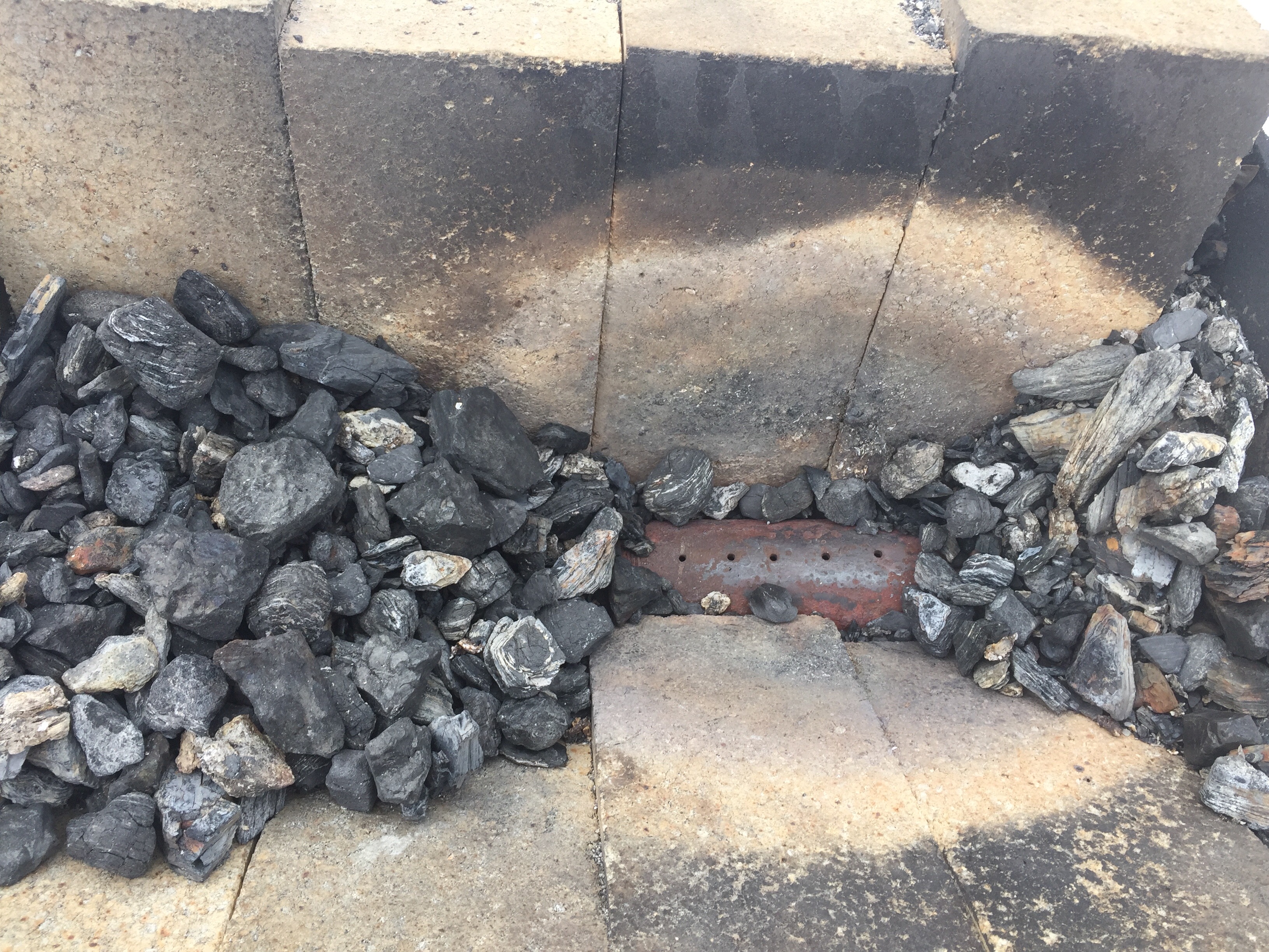

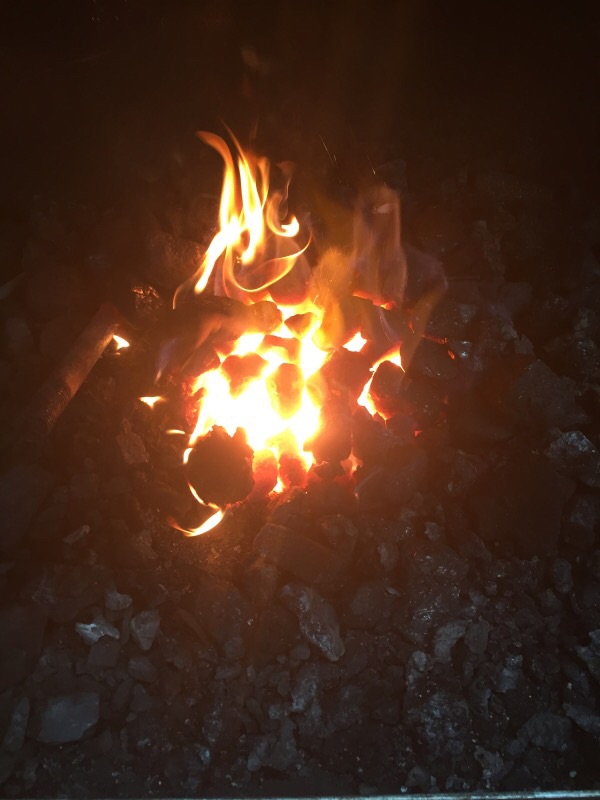

Elemental Metal Creations Posted November 14, 2015 Share Posted November 14, 2015 I actually prefer soft coal over hard coal but for the price difference, $6 for 40lb vs $19 for 50lb I can suffer a bit. For me a mix of 2/3 rice and 1/3 nut size seems to work best. A couple of fire pics that my wife took, the flames didn't show in the pics. Quote Link to comment Share on other sites More sharing options...

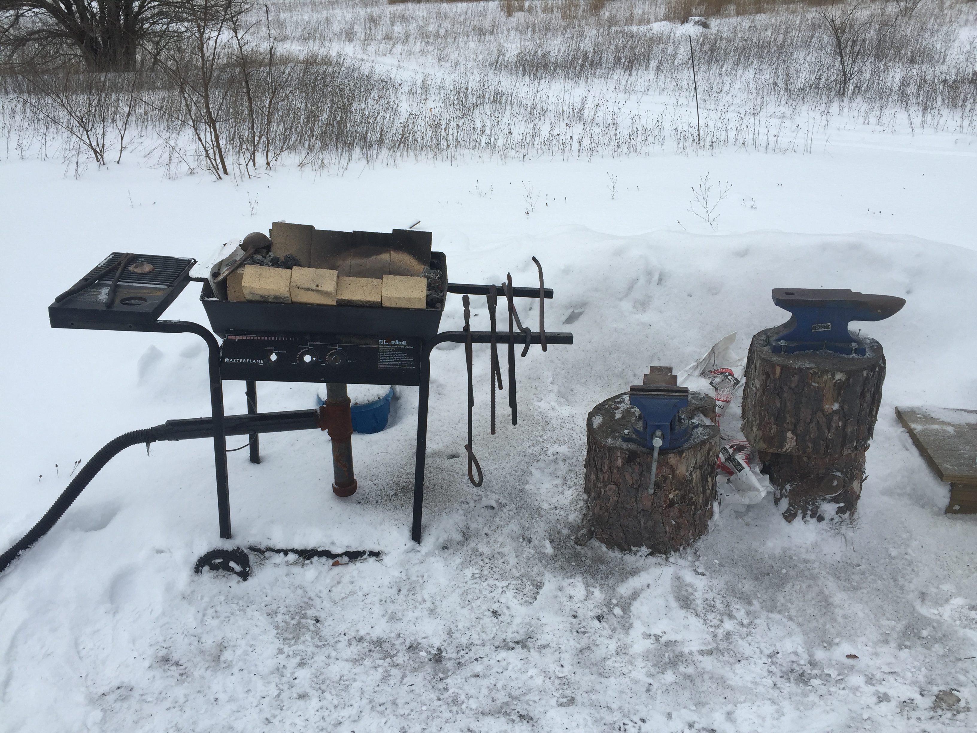

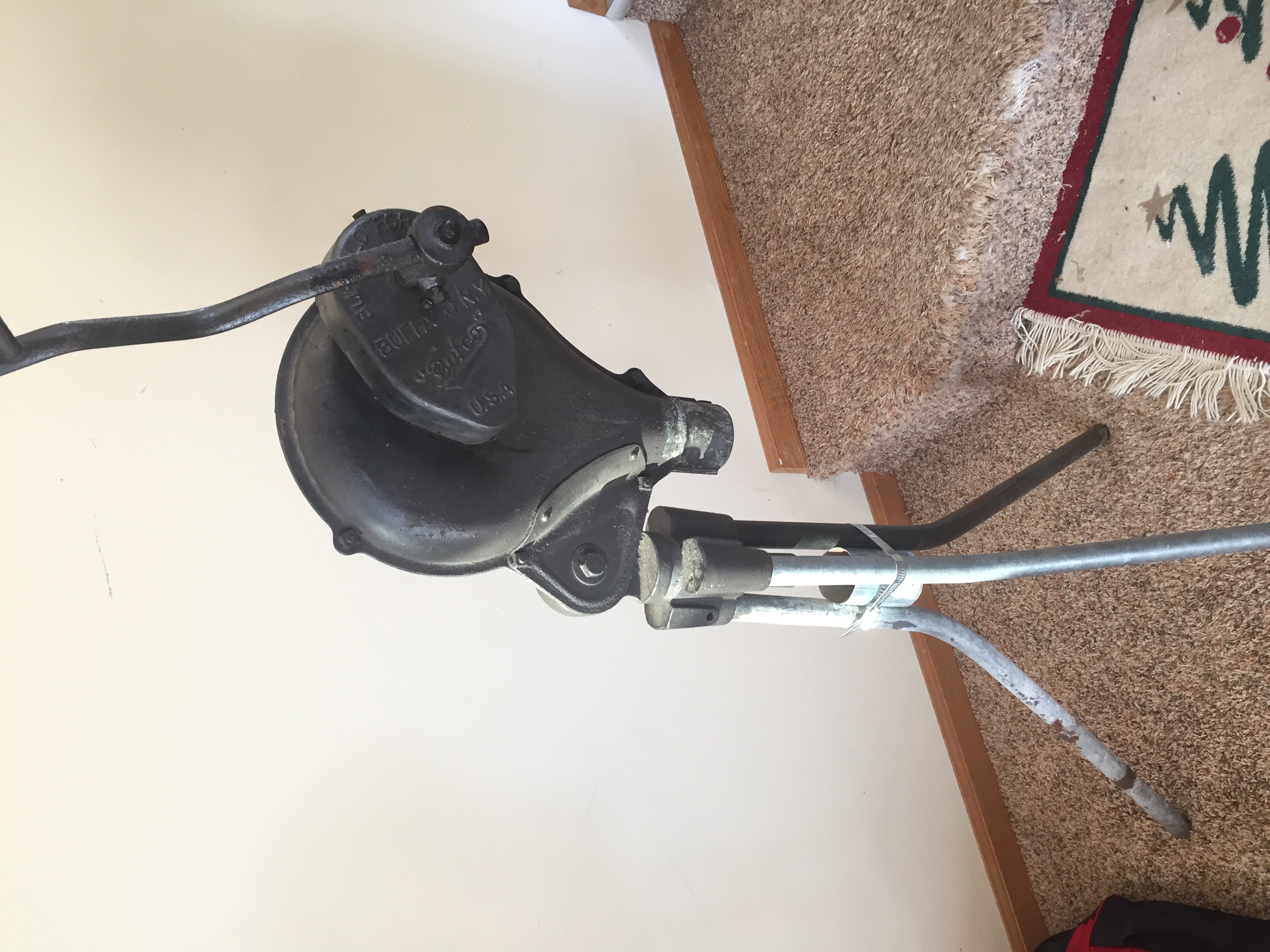

Bayshore Forge Posted January 13, 2016 Share Posted January 13, 2016 Originally I had designed my forge with a shop vac blowing the air. With this, the nut sized anthracite from TSC was pretty good. Nice and hot, but hard to start. Then I got a hand crank blower...it is very difficult to maintain forging heat with this hand crank blower. From what I can tell this anthracite likes constant air. I will try to enlarge the holes that air comes through and see if I can get the hand crank blower to work with the anthracite this way when I get a chance. PS pics of large flame is with shop vac powering, not hand crank blower. I know my anvil in the pic is a POS ASO, I have a Trenton now. Quote Link to comment Share on other sites More sharing options...
phabib Posted January 13, 2016 Share Posted January 13, 2016 Can you explain the white stuff on the ground for us California people? Lazzari Fuel in just South of SF sells coal here. Haven't bought any in a long time but I'm sure it isn't cheap. Quote Link to comment Share on other sites More sharing options...
ThomasPowers Posted January 13, 2016 Share Posted January 13, 2016 Just google "Donner Party" for the skinny on the white stuff for Californians! Yes anthracite likes constant air flow it's more like coke that way Quote Link to comment Share on other sites More sharing options...
