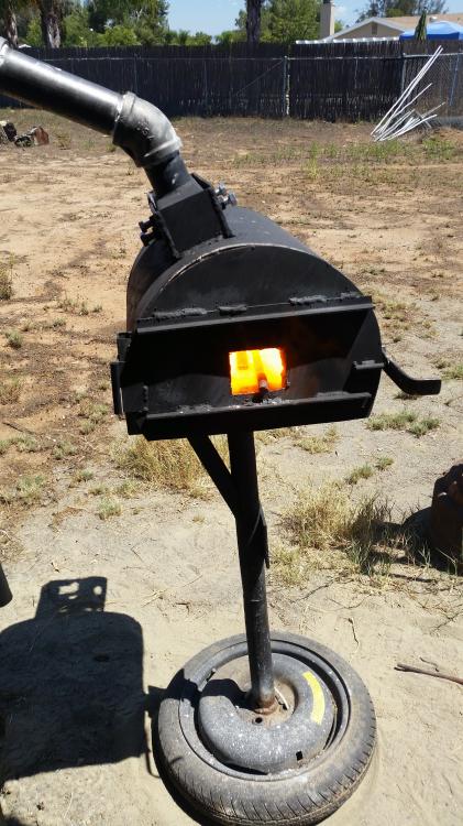

First run with the ribbon burner forge
78sharpshooter
I wish I started off with a ribbon burner forge because this forge gets incredibly hot very quick (I have never had a propane forge that you had to keep an eye on because it could burn half inch bar pretty quick). I used a 100 lbs propane tank to make this forge, 2 layers of 1" kaowool, then about 7/16" of mizzou, then shot a 1 to 2mm thick layer of 70% Zircon 30% Kaolin. I previously had 2 one inch pipe venturi burners in this forge and it got hot enough to use but simply lacked the ability to get to the upper range of forging temp. The ribbon burner works so well that I had to keep my sunglasses on to be able to look inside the forge. The soft firebrick I use, that has lasted over a year, to take up space in the back of the forge broke apart from the heat of the ribbon burner. So the point of this post is to hopefully inform those who are building a forge that the ribbon burner is hands down the way to go in terms of 1) time it takes to get the forge to temp, 2) workpiece heating time,  and 3) forge welding. (at least this is just like my opinion, dude).

Yup, Ribbon Burners are the way to go.  You on the left coast are where they got started going because of John Emmerling in Oregon.  I am doing what I can on the right coast to get the word out.  Come see my forge at the Alabama Blacksmithing Conference in early September (www.alaforge.org) or/and at the Quad State Roundup the 4th weekend in September.
Let me know if I can help you.
