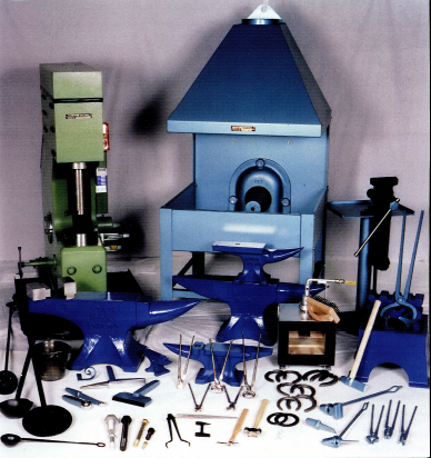

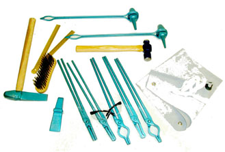

The colour makes me think it is made by Vaughans though they haven't trademarked the colour si I couldn't be sure.
I think theirs is a bit more of a blue colour ….but then I do have a green-blue memory glitch,  the cause of many arguments with my mum about a greeny blue drying up cloth we had. Her memory was invariably proved correct when it was actually in front of us… :)
Maybe it is their export colour.
Alan
p.s. Just had a look at Vaughans' website and what do you know? The colour of those images is much greener than I remember! Not quite as green as the OP image but definitely not the navy blue I was thinking of!
Didn't see an equivalent tool there though.
p.p.s. Should anybody be remotely interested in my ramblings but….further exploration on Vaughans' site and I think their web designer has managed to get a green colour cast on some of their images (the tongs in the bottom right of the main picture vs those in the tong picture) and that they unsportingly do use a few different colours...
main_picture.thumb.png.24a80ceca87df08b2KIT-BSMITH_BLACKSMITHS_STARTER_KIT.thumb

A lot of the steel handles on the Vaughans' tools have the loop for twist control on the handle so I think it probably isn't one of theirs.
