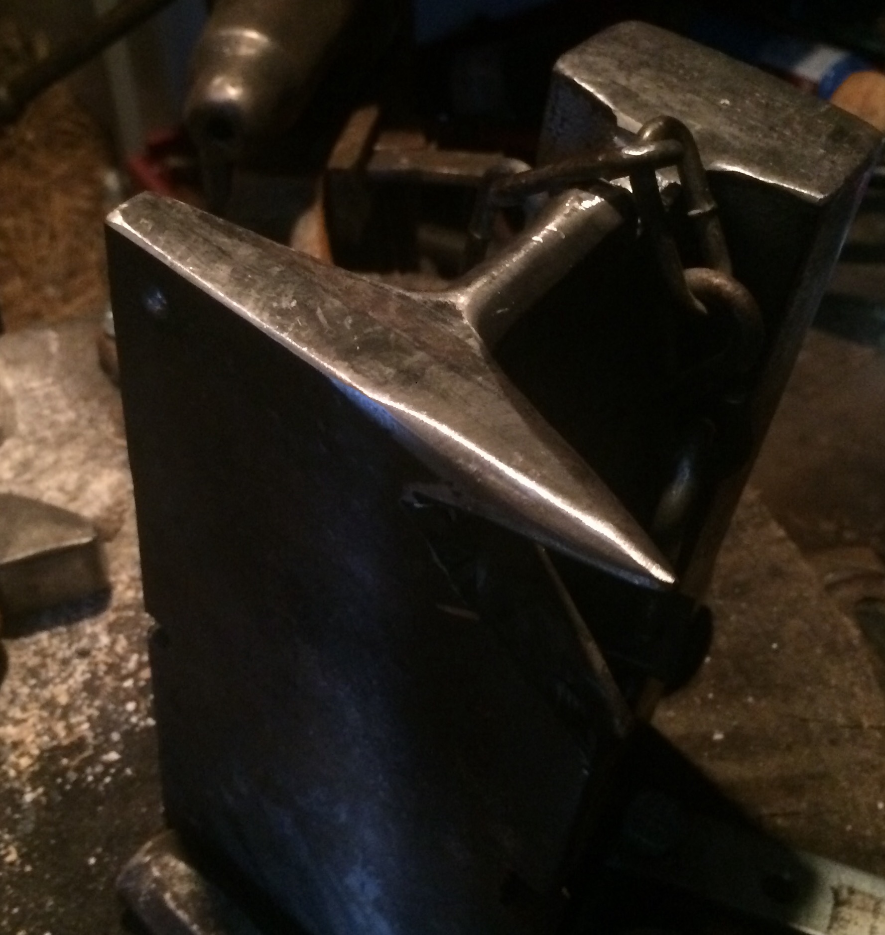

Well I was inspired by this thread. Un bolted my rail and flipped it up on end. Cut out a small horn, made the web in to a fuller. I'm loving it. Much better than before!!!  Haven't decided what to do with the other edge. May go with a hot cut tho idk if I like having a permenant sharp spot on the anvil. My post vise holds my hot cut just fine so I my go with a slightly sharper fuller.

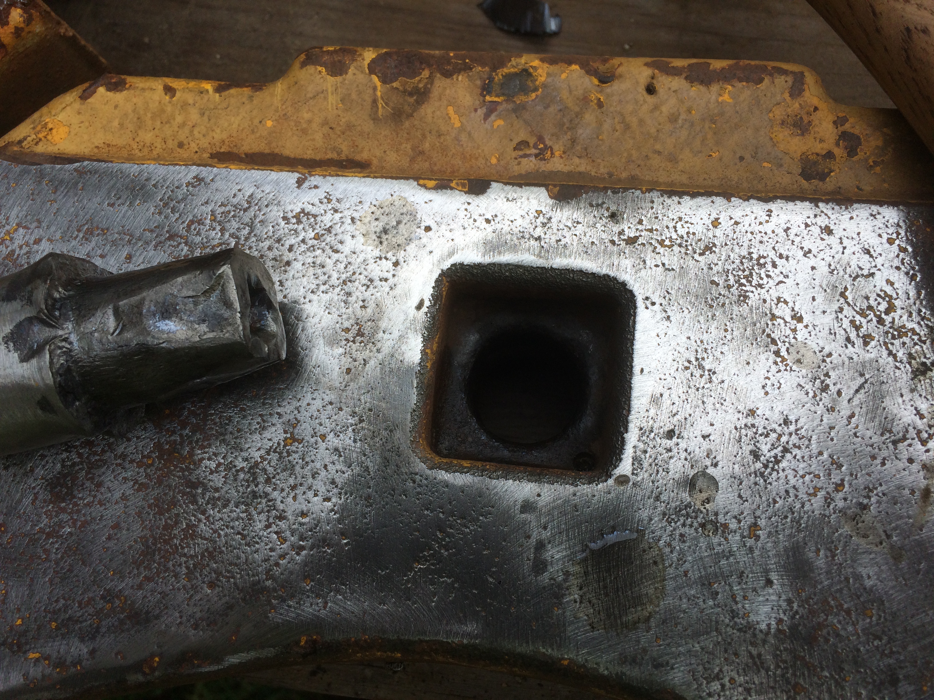

i been using the post vice as a hardy and it works great. Loving this setup. I'm planing a swage block with the weight in the pic and may put a hardy in that since it's half way there already.
Don't bother modifying that square-to-round hole; just make hardies with a short, square shank just below the shoulder and a longer round shank extending beyond that. As an added bonus, you won't have to worry about visitors nicking your hardies!
Tapering the shank is a good idea, especially if you don't have access to the bottom of the hardy hole, to drift out a stuck tool from below (don't ask me how I know this).
If you look at Mark Aspery's video about making a bottom swage, you can see that he tapers the shank pretty dramatically. Yours will be round, of course, rather than square, but the same principle applies.

On Friday, May 22, 2015 at 8:20 PM, Charles R. Stevens said:
All the new guys on the rail road anvil band wagon got me to thinking (I can hear Frosty and TP's keyboards smoking as I hit post) why not build a few for demo perposes? I coned TJ Watts into dicing up a 24" peice  of heavy guage for me, 1 peice 12", 2 at 6" and few bits (I'll post the prjects for the rest of the rail later). Every one has seen london paterns carbed out of rail, and most have seen them on end as "post anvils" but this is my take.
Now I'm solisiting ideas for the other end
