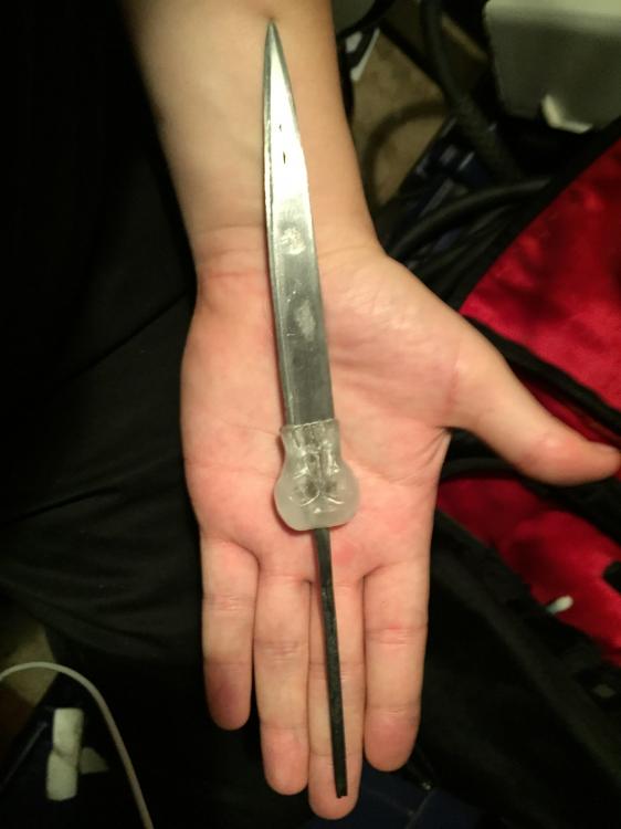

Ok, so Its a bit more like a letter opener, but I forged it out all the same. My only regret is I didn't take more process shots.

Forged and hardened in motor oil, tempered in my oven, and then polished a little.  I was pleased at how significantly stronger it became after the whole process. I was able to bend the original piece of metal, but not now. along side are pewter ingots and a sample of the wood for my handle. The wood is a hardwood flooring sample I got for free at Lowes.
IMG_2734.thumb.JPG.30af792b5a5b7c7e5a64aWax skull molded onto the blade for a quillon. or fitting maybe? cross guard? Terminology help would be appreciated here.
IMG_2732.thumb.JPG.e2a538e271818c4ac7ccb

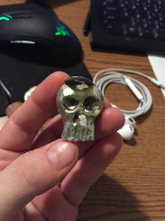

Pewter skull fresh from the mold

And here is either side of the knife in its current state. I get pewter cups from thrift shops for my casting purposes.IMG_2753.thumb.JPG.f23919724518912c6ff12IMG_2754.thumb.JPG.7ce73cda7584c2c0cd45a
I'm still working on the pommel, but here are 2 looks I've been playing with in wax. I had one failed casting (second photo). Who knew a marble would float in molten pewter. IMG_2745.thumb.JPG.8427821e02cf2f04197b5IMG_2748.thumb.JPG.d9fcb1d02ef0fa3fa04f5
I would love any feedback.  I'm using a coffee can propane forge, the anvil on the back of a vise, and whatever hammers I have at hand. Steel too for that matter (hence the chair parts).

I'm not a bladesmith so I can't tell you anything about the recliner guts but I tend to think it's too low carbon for good edge holding.
No No NO! The back of your vise is NOT an anvil suitable for work heavier than straightening nails. It is NOT for forging, you'll damage your vise. While it gets a lot of bad press RR rail is just fine as an anvil but keep looking for one anyway.
Not a bad first effort though. Keep at it.
Leaf springs work for getting started but are not god idea in the long run, because there is no way of knowing about any micro fractures until you spent way too much time on it. So its better to try to get 'drops' from the places the work on truck springs, some will let you have sections of the cut offs for free, others uo to 40cents a pound which is scrap price.  You can buy a 5ft long bar of good knife steel 1/4 x 1.5 inch for about $15, not only will that make a great blade, but you dont have to crawl threw a junk yard to get it.  Read in the anvil section about finding good anvils and substitutes. I fear your vise is not made for taking a beating and wont last long.  knife makers always have uses for a working vise.
