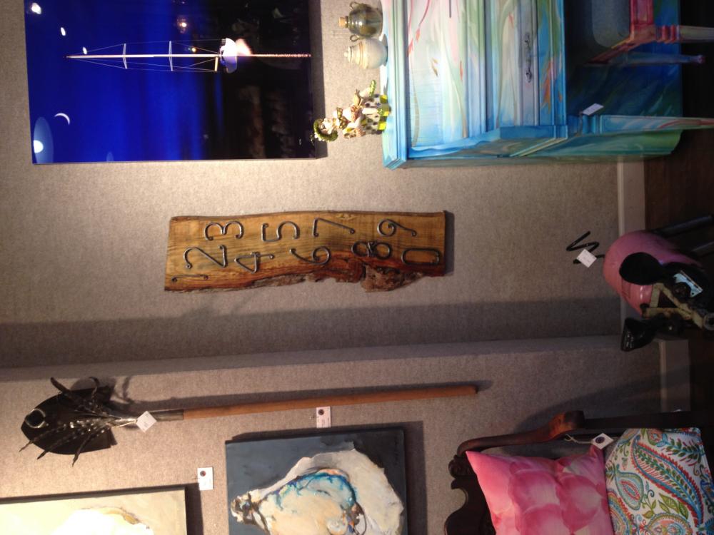

It is awesome that you were so consistent without jigs or anything, i'm impressed! i got contacted by a consignment gallery to make house numbers for them to sell, not what i would have done of my own accord, but it is what they asked for! Sorry that it is so far away, i know it will be difficult to see any detail.
Kegan, zoom makes it very viewable, nice embellishment on the #8 especially.
