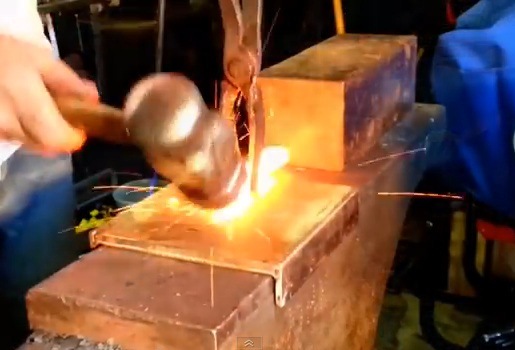

Everything Mac Posted August 28, 2014 Author Share Posted August 28, 2014 Perhaps it's just me, I'm very much a function over form kind of guy in general. If it does it's job then I don't need to pay the extra cash just to have it looking shiny. Here's a picture I took from Facebook. You can see a great example of different edges... The anvil on the right is rather badly beaten up. The face does seem to be flat on the whole so it's still a useable tool. It would indeed be a good candidate for a repair if the price was right. If the seller was asking $500 I'd pass. (It's very relative) That said, if I could get that for dirt cheap and I was looking for my first anvil there's no reason why you should pass it up. There is still enough of the face to be able to do useful work. You could easily make enough items to sell on to pay for a better anvil or for the repair of this one. Add in a hardy tool and you're sorted. The saw doctors anvil is pristine as they often are, but take the two other large anvils on the left hand side. They are in generally good condition - They're flat, not missing any significant parts of the face plate and assuming there's no obvious cracks anywhere then any smith should be happy to own and work on them. - however this is the kind of condition that people deem as inferior and require welding up immediately before any use. This to me is just plain wrong. Those anvils are fine and in much better condition than the anvil I learnt on, let alone the first anvil I had for many years. I can understand the idea that better tools yield better results and to a certain extent this is true. - a lesson I am learning right now with a cheap screw driver set I bought recently. But let's say you owned that saw doctors anvil - would a brand new anvil give you better results than that? (Ignoring the horn/ hardy hole etc) the face is still in mint condition, the edges are the same? You could indeed buy a brand new anvil, and I think if we could afford it many of us would. If you can afford that then go for it. But frankly unless you're a professional I don't see the point. (Unless you're really really stuck for finding one) - In the UK we can get pristine anvils for less than £300 so why would I then pay £2000 for a new one? I've fitted out my whole shop for considerably less. I'm sure I'll get the "a new tool is an investment" response to that one. Apologies gents I appear to be ranting and going off on a tangent as per usual. To summarise - 1. unless the anvil is beaten to XXXX and the face is missing, any anvil will serve a beginner well enough. 2. Perfect edges are not required. If they are you can use a hardy tool. 3. Perfect anvils do not make for perfect work. Andy Profane language edited as per ToS Quote Link to post Share on other sites
