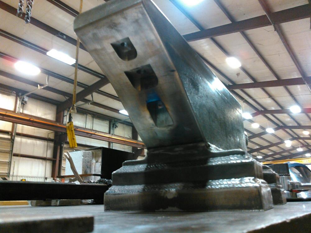

T.J.watts Posted March 9, 2015 Author Share Posted March 9, 2015 Still some machining left but here's what I have so far. Quote Link to comment Share on other sites More sharing options...

iron+carbon Posted March 10, 2015 Share Posted March 10, 2015 Looks good. Did you heat treat it yet? If so how did you do it? Quote Link to comment Share on other sites More sharing options...
BIGGUNDOCTOR Posted March 10, 2015 Share Posted March 10, 2015 Those are some pretty sweet welds. What did you use?Looks good so far. Quote Link to comment Share on other sites More sharing options...
Frosty Posted March 10, 2015 Share Posted March 10, 2015 Very nice welds indeed. Say TJ, did you matt the foot before welding?Frosty The Lucky. Quote Link to comment Share on other sites More sharing options...
T.J.watts Posted March 10, 2015 Author Share Posted March 10, 2015 Most of the welding was done with flux core and the base is L56 hard wire. What do you mean by matt? I haven't heat treated it yet I'm still working on the hardy. Quote Link to comment Share on other sites More sharing options...
Frosty Posted March 10, 2015 Share Posted March 10, 2015 Matting like framing a print. Makes em purty. <grin>Frosty The Lucky. Quote Link to comment Share on other sites More sharing options...
T.J.watts Posted March 10, 2015 Author Share Posted March 10, 2015 lol no I didn't. Charles and I have been kicking around a few ideas about how to heat treat this monster but haven't decided just yet. guess im going to have to do that pretty soon. I weighed it yesterday at 207lb. Quote Link to comment Share on other sites More sharing options...

iron+carbon Posted March 10, 2015 Share Posted March 10, 2015 That's a good size. I'm looking forward to finding out how you heat treat it. This is quite a project you took on. I like the shape of the horn, it makes sense to customize it to your needs. Quote Link to comment Share on other sites More sharing options...

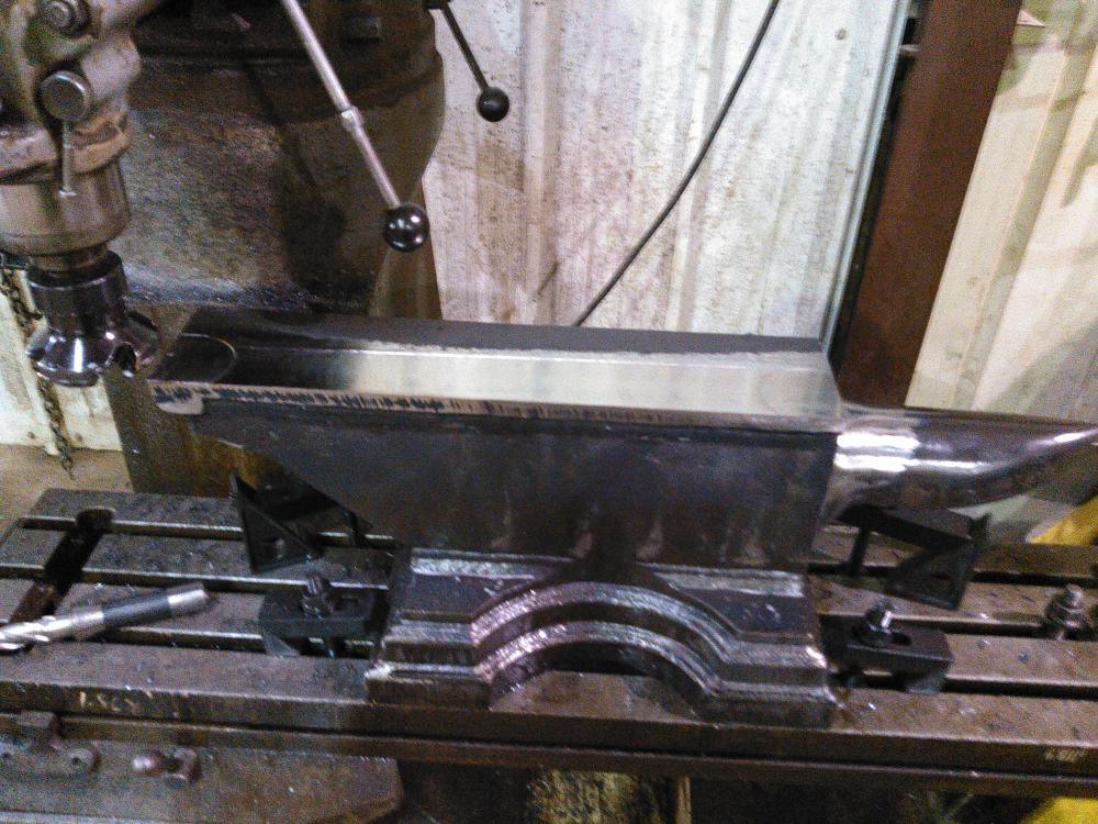

Charles R. Stevens Posted March 11, 2015 Share Posted March 11, 2015 TJ, why didn't you post a pic of your pretty weld job om that top plate? You sent me a couple of nice ones. Or do I have to post them?! Quote Link to comment Share on other sites More sharing options...
T.J.watts Posted March 11, 2015 Author Share Posted March 11, 2015 you go ahead I don't have them on my phone. Quote Link to comment Share on other sites More sharing options...
T.J.watts Posted March 11, 2015 Author Share Posted March 11, 2015 Quote Link to comment Share on other sites More sharing options...
Charles R. Stevens Posted March 11, 2015 Share Posted March 11, 2015 Quote Link to comment Share on other sites More sharing options...
Charles R. Stevens Posted March 11, 2015 Share Posted March 11, 2015 Looks like some sculpting on that heal is in order, lol. Quote Link to comment Share on other sites More sharing options...
T.J.watts Posted March 11, 2015 Author Share Posted March 11, 2015 I milled the heal now I just need to grind to the final shape. Quote Link to comment Share on other sites More sharing options...
T.J.watts Posted April 14, 2015 Author Share Posted April 14, 2015 207lb, 27" long, 4" wide, 9.5" tall, 18.5" table, 1" hardy, .375" & .5" pritchel. All that's left now is the heat treat and ill build a new stand. I have two chemical totes for the water and I may be able to borrow a water pump. I'm itching to finish and hammer some steel. Quote Link to comment Share on other sites More sharing options...
