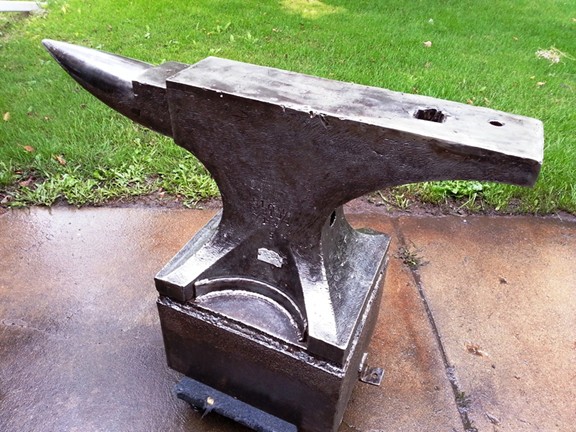

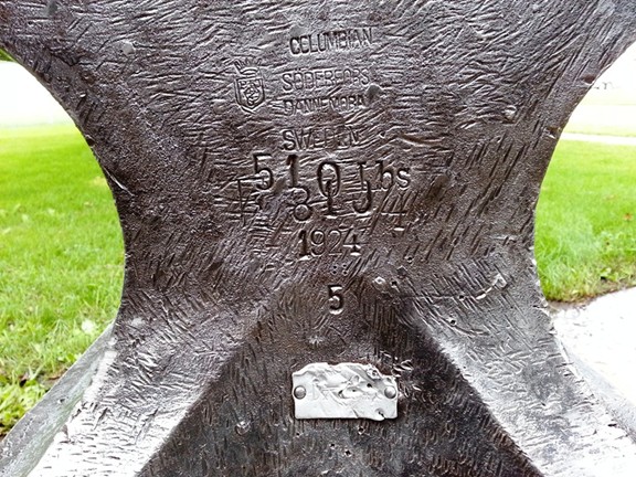

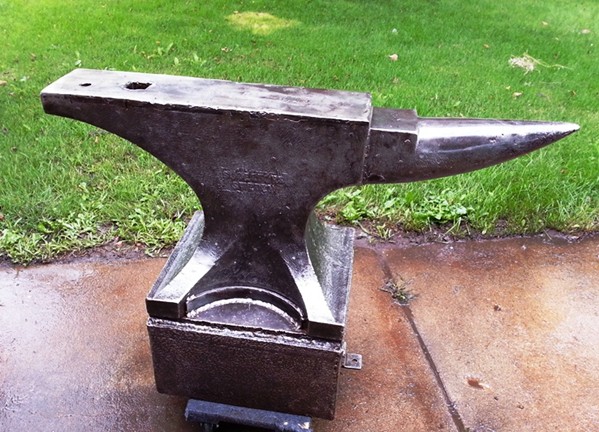

Black Frog Posted March 3, 2014 Share Posted March 3, 2014 Here's my lovely Soderfors anvil. Made in 1924, weighing in at 510#. This anvil has outstanding rebound. I did not need this anvil when the opportunity presented itself, but I couldn't let something like this pass by, especially considering the condition it is in. I know I would've kicked myself for the rest of my life if I hadn't snagged it.... I had to drive 5 hours each way to get it, but I am very glad I did. The anvil has a cast "SODERFORS, SWEDEN" on one side, and the stampings on the other side that are pictured below. Interesting combination in that it carries the Columbian stamp too, no Paragon markings. Soderfors made anvils for Columbian for a while during that time period, according to Postman. This anvil has the Dannemora stamp on there, indicating the mining/iron district in Sweden where the iron ore came from to make this anvil. Dannemora steel was claimed to be of a higher quality than other steels of the time. Some Soderfors of the same time period I’ve seen do not have the Dannemora stamp (that I can find) on them. This anvil has a nice stand with formed arch holders fit to the base of the anvil. Four little tack welds at the ends of the arches secure the anvil to the base. Base is thick and beefy with a top plate welded to the cast base. I don’t have a scale large enough to measure the whole thing, but I’m guessing the base adds another 150 pounds(?) to the package. It had many decades of grime/dirt/rust on it, but it cleaned up nicely. Quote Link to comment Share on other sites More sharing options...
CleetisMorgan Posted March 4, 2014 Share Posted March 4, 2014 Frog--did that one come out of Grand Rapids? I still have the pics of that anvil the lady sent to me, and when I told her I'd take it she said it was gone. I haven't blinked on an anvil since (: Super score--she's a beaut!!(: Quote Link to comment Share on other sites More sharing options...
BIGGUNDOCTOR Posted March 4, 2014 Share Posted March 4, 2014 Teenylittlemetalguy, don't worry, it isn't rusting away. Down here in the desert a little patina just adds character :) It also has company, as my 260# Fisher is just to the left of it. Black Frog, how many chisel marks are on that anvil of yours? Quote Link to comment Share on other sites More sharing options...
Black Frog Posted March 4, 2014 Share Posted March 4, 2014 CM- Yup, that was the one in Grand Rapids. I'm glad I made the drive. ;) BGD- Those are not chisel marks, you can see that the factory stamps are cleanly impressed into of all that surface texture. More like some sort of original finishing (or cast molding texture?) from the factory I'm guessing..... I've seen other large Soderfors similar to this. Quote Link to comment Share on other sites More sharing options...
