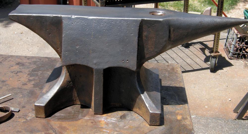

Kenny O Posted November 14, 2018 Share Posted November 14, 2018 A friends Soderfors anvil. Quote Link to comment Share on other sites More sharing options...
