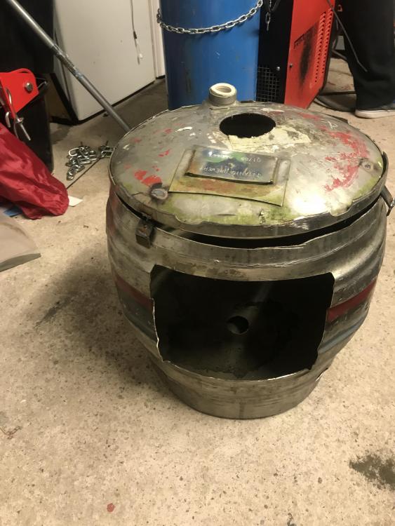

D4UNC36 Posted May 14, 2018 Share Posted May 14, 2018 I am not sure if I missed this but when making your own clay, what are your thoughts on mixing the bentonite (cat litter) with sand and cement. Would the cement hold it together in a similar fashion to some straw? Quote Link to comment Share on other sites More sharing options...
JHCC Posted May 14, 2018 Share Posted May 14, 2018 20 minutes ago, D4UNC36 said: Would the cement hold it together in a similar fashion to some straw? No. Cement gains strength from absorbing water and forming hydrate compounds. Above a certain temperature, those hydrates lose their water content, which then flashes to steam, sometimes explosively. I see that this was your first post on IFI. Welcome, but please READ THIS FIRST!!! Quote Link to comment Share on other sites More sharing options...

D4UNC36 Posted May 15, 2018 Share Posted May 15, 2018 12 hours ago, JHCC said: No. Cement gains strength from absorbing water and forming hydrate compounds. Above a certain temperature, those hydrates lose their water content, which then flashes to steam, sometimes explosively. I see that this was your first post on IFI. Welcome, but please READ THIS FIRST!!! Thanks, I’ll get on the things in the read this first section! I’ll steer clear of the cement then, just asking because I am just starting out and making a forge out of an old stainless steel keg and I am needing to line it. Here’s a pic of part way in (if anyone is interested haha) Quote Link to comment Share on other sites More sharing options...
JHCC Posted May 15, 2018 Share Posted May 15, 2018 6 hours ago, D4UNC36 said: I am just starting out and making a forge out of an old stainless steel keg Not sure what your plans are for the keg, but please read the threads about the JABOD forges before you proceed further. Quote Link to comment Share on other sites More sharing options...
Charles R. Stevens Posted May 15, 2018 Share Posted May 15, 2018 A small hooded forge makes working long stock difficult, as it dose large scrolls. If all you do is horseshoes from pre cut stock you will be ok, but otherwise you will find your self frustrated with the limits of your design This is my Mark II JABOD forge (John coined the fraze) This is some musings about design This is the latest version. None of these are plans persay, but they are intended as road maps for you to experiment with to find what works for you. These are small forges optimized for charcoal. A similar concept can be used with coal, either side blast or bottom blast (a ducknest as aposed to a steel or castiron fire bowl). I recommend prototyping your forge desighn in this way to save money and time. Once you know what makes a forge work for your fuel, air supply, work habits and class of work then go a head and make your self a work of art of a forge. Quote Link to comment Share on other sites More sharing options...
JHCC Posted May 15, 2018 Share Posted May 15, 2018 And if you have a source for stainless steel kegs, save one for use as a non-rusting slack tub. Quote Link to comment Share on other sites More sharing options...
