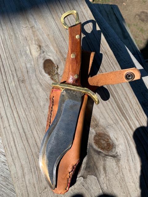

I've forged a knife blank, full tang, that I want to install a brass finger guard on. Both the blade and the butt-end are too big for it to slip over and then fit correctly. So do I do a two-piece guard, a slotted guard, or what other options do I have? I thought about changing the material too soft steel and then welding it after putting it on. But I really want to go with brass for artistic reasons. So if I use brass I thought about making a two-piece guard slip the top piece on, then the bottom piece and then rivet them together. Or comment welcome thanks Happy New Year
Once this knife is finished it will probably just hang on the wall in my collection. I don't do a lot of ninja fighting here on the West Coast. That said I want it to be a sturdy knife in case somebody did you use it for some reason. It's not an original design I'm trying to simulate the knife shown here below,,,,,,, although the knife in the example appears to be a hidden ratailScreenshot_20220104-083239.thumb.png.c6661e962f315de0b2a113472ac903b3.png
Tang I wanted to go Full Tang. Just to make things harder for me I guess LOL
Thanks for your help and I guess I'll look at how to solder brass that's why I like forging I have a lot to learn keeps me busy.

As long as you do this before your heat treat, you can braze a brass guard using acetylene. Almost all my early knives were done this way. Some brazed on both sides, and some just brazed on the handle side so it wouldn't show. So far, I don't know if you could call them bullet proof, but they have certainly been purple bullet proof! Here is one I made for a horseman from a farrier's rasp (the loop on the back is for clearing hooves). I start with 1/4" brazing rod, bend it around the tang section, braze it all up, grind it down and there you go.
That's a nice blade! Thanks for posting. Brazing maybe a good solution, but it raises yet another question for me. I can't fit the guard until the knife is at its final dimensions. I always Forge a blank and then go to the grinder and take it down close to final shape while it is soft. But not all the way to finished dimensions, because I thought it was unwise to heat treat a finished blade in the Forge because it was too thin. Have I got that wrong?
Keep in mind that I'm no professional, just a retired chem e. who enjoys pounding metal. Caveat emptor!
When I first started making knives I didn't have an oven. I used a coal forge  or acetylene torch to edge-quench, that is, only heat the edges to a little better than cherry red ( and when I say "edges" I mean at least a quarter to a half inch of the edge) and quench in oil. I would take off all the gunk and put a rough polish on the blade. Then I would (again using the coal forge or the torch) slowly heat the center or the spine of the blade and watch the oxidation colors. When the straw color reached the edge I would quench again. Then go for the final polish.
I never had a warp using that method. But it might be good to think about what CAN cause a warp. Again, I'm no expert, but warpage in heat treating can occur from two main reasons; uneven heating or uneven cooling. This can be because of the geometry of the blade, If one part of the blade has more mass it will give up it's heat to the quench slower, the thinner will cool quicker and shrink accordingly, pulling the still hot and slightly plastic thicker steel out of shape. The above method works because the spine never becomes plastic and holds the shape while the stresses are being built into the edge section.
Not being a professional, or ever having sold a knife, I'm not concerned with delivering a blade of x rockwell. I'm blessing someone with a tool fit for purpose. So far I haven't had any complaints of blades breaking or not holding an edge.
