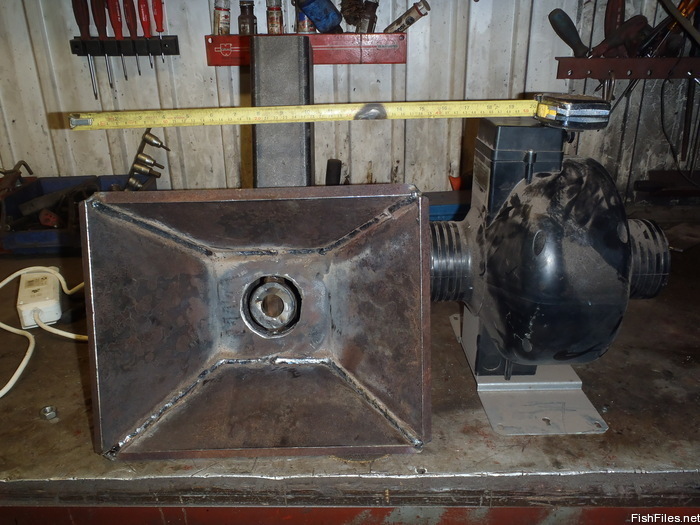

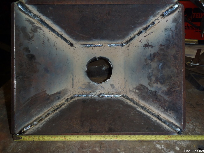

this is the firepot... it has an opening of 13" X 10" and is 4 1/2" deep, it is made of 1/2" steelplate

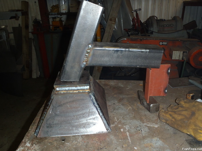

and this is the air intake on top of the firepot. i think it is called Tuyere in english

Very nice bit of welding, friend. Though, I am curious as to why your decided to angle the air pipe like that. Not saying it wouldn't work, just that I've never seen anyone do that before.
And don't worry about your english skills. You're doing great, and certainly better than a whole bunch of native english speakers that I know!!
"Very nice bit of welding, friend. Though, I am curious as to why your decided to angle the air pipe like that. Not saying it wouldn't work, just that I've never seen anyone do that before.
And don't worry about your english skills. You're doing great, and certainly better than a whole bunch of native english speakers that I know!!"
humm... i don´t know how to explain this other than saying "imagion driving your car straight in to a wall amd then driving your car from an angle in to a wall...
i am hoping to deflect most of the air away from the "ash pit"
Wow, I've never thought of that before... but it seems logical. :D
Well, it certainly won't hurt anything.  The air flowing into the pipe forms something of a pillow in the ash pit of the piping with the remainder of the air being forced up as the path of least resistance.  Depending on your air source, leaving the dump gate open a hair could be a good way of modulating how much air is going to the fire.
And, it's looks cool.  Run with it and let us know how it works for you.

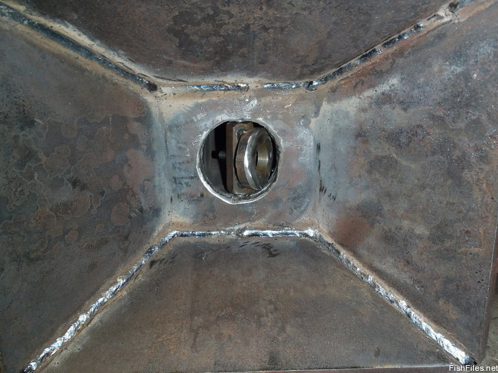

here is a pic of inside of the forge and that thing in the middle i think it is called a clincker-braker

and here is a pic of the forge and the blower i am thinking about using
flcsslcf_Eldst%C3%A6%C3%B0i_og_%C3%BDmis
the blower has an output pipe with a 3 1/2" (90 mm) inside diameter but the squer tube in the air intake of the forge has a insite diameter of 2 3/4" (70 mm)

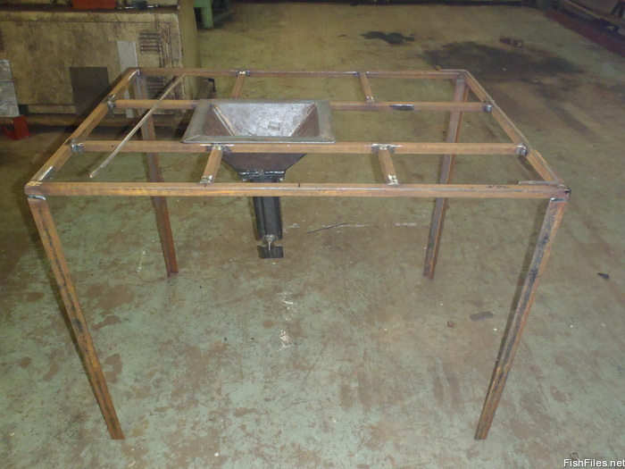

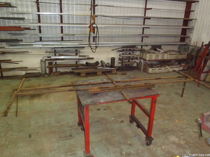

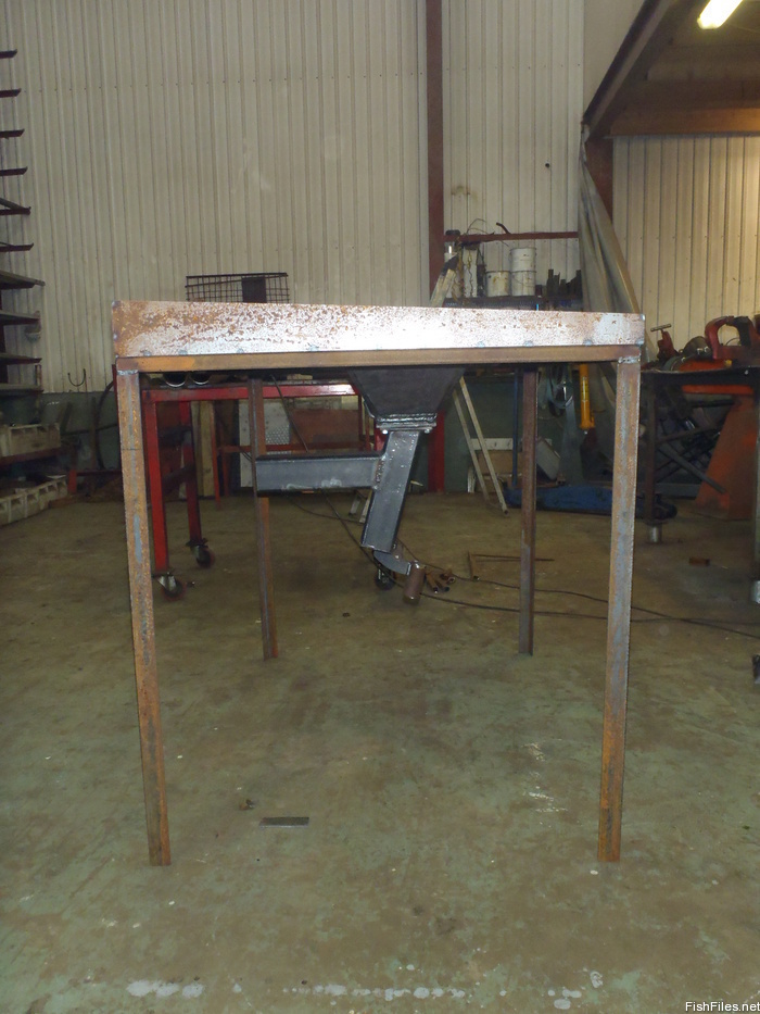

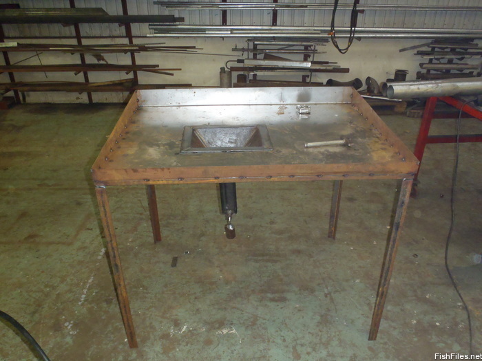

finaly i had some time to get some work done so time for updade
in 2 hours it looked like this
then after another 2 hours it looked like this

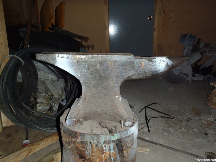

and finaly i got my anvil yesterday

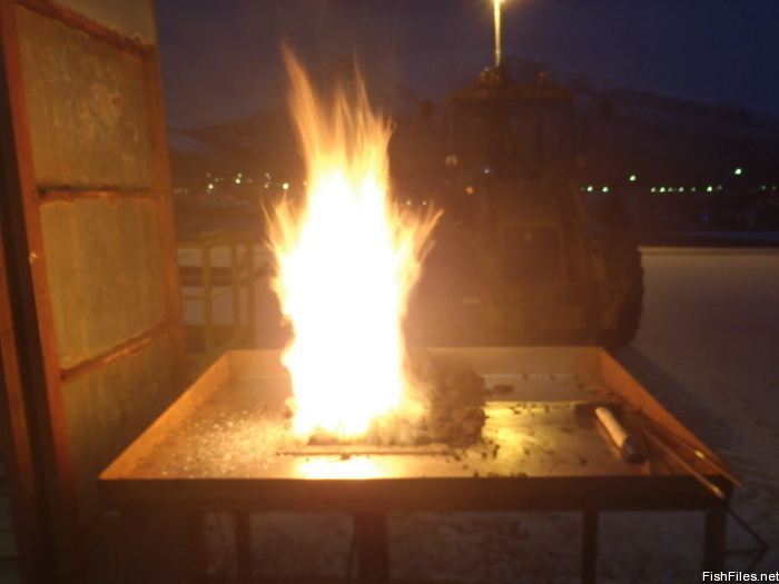

i hope to finish my forge to morrow and try it for the first time :)
my live has a new meaning lol
that genarates a huge heat it took less than a minute to get 10mm (3/8") bar to orange heat and man i had very nice 2 hours heating and hammering lol
and managed to make a pair of very ugly looking tong and a very ugly looking coal rake....
thanks for the inspiration guys now it will be a lot of practice

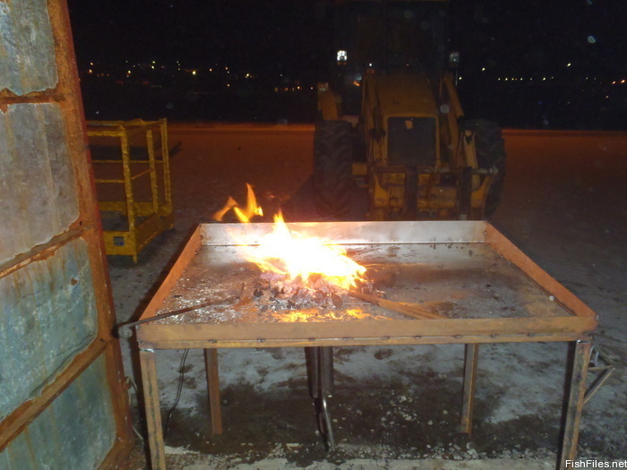

this pic is taken when i was quitting and had turned the blower off which is btw a hairdrier
in this fire i was using coal ( filled the houst with smoke while i was geting it hot) lol
yes i need to have some kind of damper for the air flow, it is burning coals very fast like this.
the future plans has a blower whitch is in one of the pic above and i am going to have a swifch on it that allows me to run it at very low speed so i can controle the heat better...
