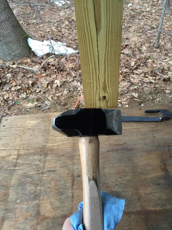

hikerjohnson Posted April 4, 2018 Share Posted April 4, 2018 (edited) I hadn't seen this post before, but have just finished doing the same thing as you folks. I picked up a 3# Harbor Freight hammer, and with a couple of cutoff discs and a flap wheel, got myself a pretty reasonable double peen hammer for a little less than ten bucks. It's not a Bailey hammer, but for the time being, it's quite good enough for me. I found thinning the handle also made a difference in the grip, and the accuracy of my hammering; something about indexing in the hand, I suppose. I am thinking of doing this again, but with a 2# hammer, to get something a little lighter. This is a bit over 2.5# now, I believe. Edited April 4, 2018 by hikerjohnson Added thoughts. Quote Link to comment Share on other sites More sharing options...
Latticino Posted April 4, 2018 Share Posted April 4, 2018 Nice job. I thought about making mine into a double diagonal peen (as I'd like one of those), but realized for the grinding effort I might as well forge one out of better quality steel instead. Of course I have to get off my butt and do that now... Quote Link to comment Share on other sites More sharing options...
Steve Sells Posted April 4, 2018 Share Posted April 4, 2018 why are the pien ends so square, thats asking for troubles Quote Link to comment Share on other sites More sharing options...
ThomasPowers Posted April 4, 2018 Share Posted April 4, 2018 Latticino; the most interesting hammer mod I've seen in person was taking an old hand sledge with an octagonal cross section (not a regular octagon of course) and heating it in a propane forge and then using a hydraulic press to make it a double 45 deg cross peen with reversed peen directions. Took about 2 bites each side with the press which left a nice curved peen face as well. Minimal clean up needed and the octagonal cross section made it easy to index the press dies to get a 45 deg peen orientation. Quote Link to comment Share on other sites More sharing options...
Latticino Posted April 4, 2018 Share Posted April 4, 2018 32 minutes ago, ThomasPowers said: hydraulic press Thomas, Yes that is definitely the way to do it. A hydraulic press is on my wish list. Almost picked one up a couple of weeks ago (15 ton forging press, a steal for around $2,000 and even relatively local), but was a bit doubtful about the guides after finding out that it was a modified unit that was originally for flattening cans or the like. If I hadn't had a massive headache that morning I would have driven the 4 hrs round trip to inspect it anyway. Needless to say it went to the next interested party for even more than I had negotiated for. So it goes... Quote Link to comment Share on other sites More sharing options...
ThomasPowers Posted April 4, 2018 Share Posted April 4, 2018 The reason I saw it was it was after an ABANA affiliate meeting and the person modifying his hammer asked the smith if he could use his forge/press. (You don't necessarily need the tools if you have *friends* with them!) Quote Link to comment Share on other sites More sharing options...
hikerjohnson Posted April 5, 2018 Share Posted April 5, 2018 22 hours ago, Steve Sells said: why are the pien ends so square, thats asking for troubles Steve, they're that sharp only because I haven't learned my lesson and eased them off with a flap wheel. I'm sure that in the near future I will do just that. So far, on smaller stock, it's working OK. I can see how working something wider than the hammer face would look terrible in very short oder. Quote Link to comment Share on other sites More sharing options...
ThomasPowers Posted April 5, 2018 Share Posted April 5, 2018 It also matters when you are working with the edge of the face and not the flat. Hammering has a lot of techniques folks use; some more or different than others. Quote Link to comment Share on other sites More sharing options...

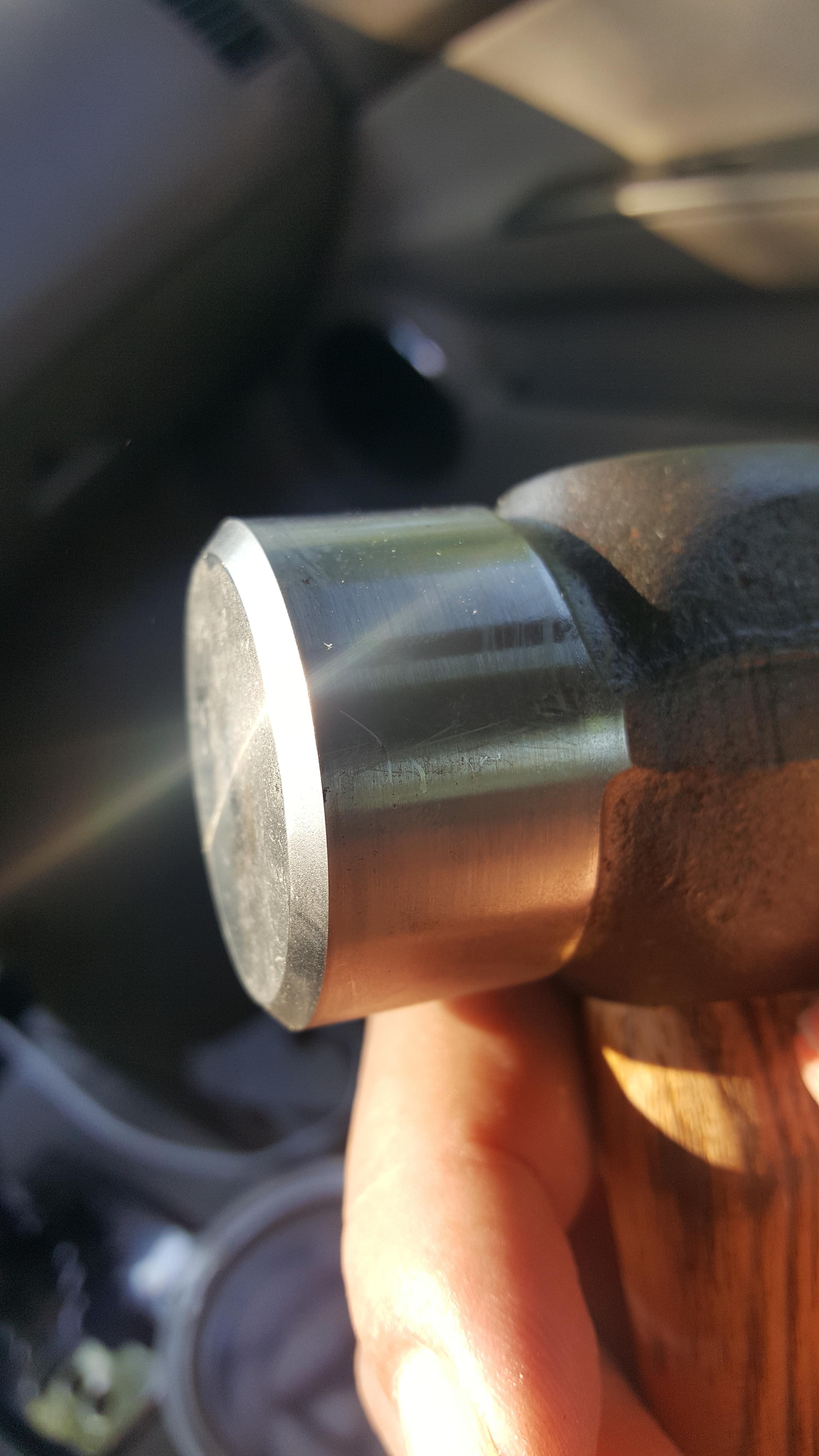

Ranchmanben Posted October 11, 2018 Share Posted October 11, 2018 Chopped down the face of a little ball peen to make it a little more balanced. I’ve never liked how unbalanced ball peen hammers are. Planning on using this hammer for peening small rivets. Quote Link to comment Share on other sites More sharing options...

Paragon Posted November 5, 2018 Share Posted November 5, 2018 Wouldn't taking too much material get into softer steel assuming the hammer is hardened or should this only be done on hammers with softer faces that a file can bite into? Quote Link to comment Share on other sites More sharing options...
JHCC Posted November 5, 2018 Share Posted November 5, 2018 That assumes that there's a differential heat treatment. As I understand it, many -- if not most -- commercial hammers are heat-treated in ovens that harden and temper all the way through. In other words, the interior steel should have the same hardness at the exterior. Quote Link to comment Share on other sites More sharing options...
Rick Marchand Posted November 5, 2018 Share Posted November 5, 2018 ^^^ I can vouch for that. I cut 3/4" off both faces of a 6lb'er and the inside tested just as hard as the original face. The brands that I have used and tested are Benchmark, Garant and Estwing. They are all through-hardened. Quote Link to comment Share on other sites More sharing options...
