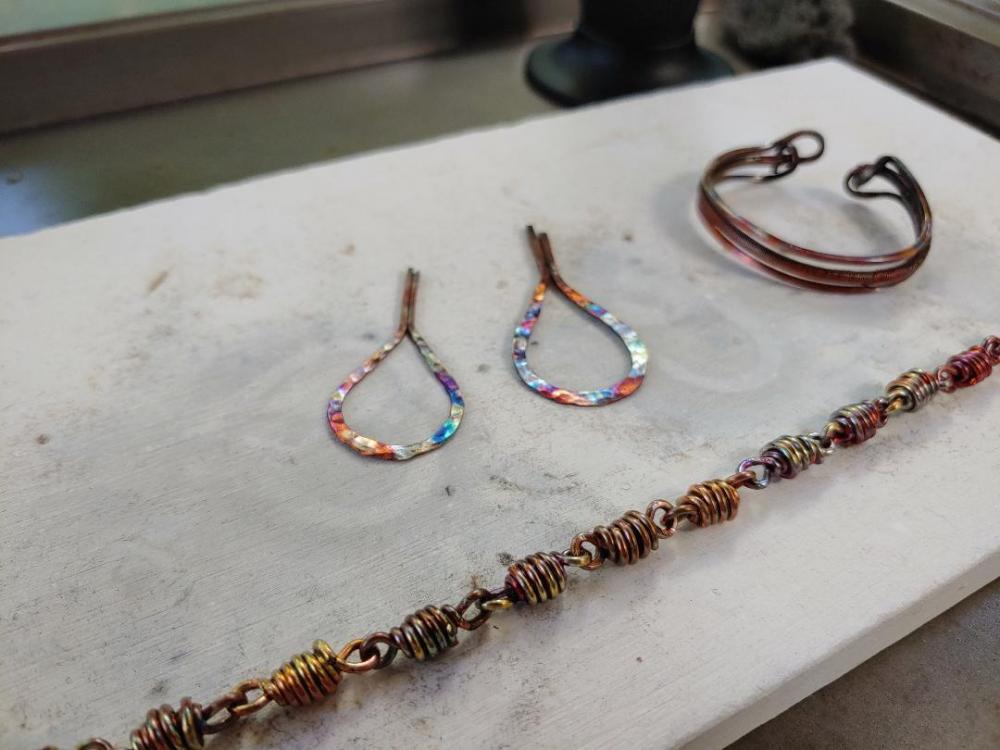

Maui Mermaid Posted October 23, 2019 Share Posted October 23, 2019 I watched a good YouTube video from George Goehl last night which gave me a better feel to more of a touch_&_go technique with my Butane torch, I was so excited to try it this morning. On my first 2 failed attempts earlier this week, it was in the middle of the afternoon, in my kitchen, indoor temperature was probably 80 degrees, with all the ceiling fans running, I torched holding my pieces in the air with insulated pliers. Watching other videos, sometimes it was mentioned how temperature, humidity, oxygen, etc. can all be factors in the outcome. So this morning, it was cool outside with no wind, around 72 degrees and I thought I'd try it again. I took some '0000' steel wool to both pieces and started over, plus I had purchased a soldering board yesterday, and I turned the heat control down to it's lowest setting (where previously I had used it on it's highest setting). I am very pleased with the results! Here's a picture. I can see I still have a lot to learn, but am excited to have achieved some vibrant colors by using more of a tapping motion, let the piece cool a moment, then tap again. Ultimately, (maybe even today) I will order a few copper sheets, and give it another go. Any suggestions on what gauge thickness for earrings/jewelry making? *I do have a question though, is there a setting I can enable which will send me an email notification each time this thread is updated? Aloha for now! Quote Link to comment Share on other sites More sharing options...

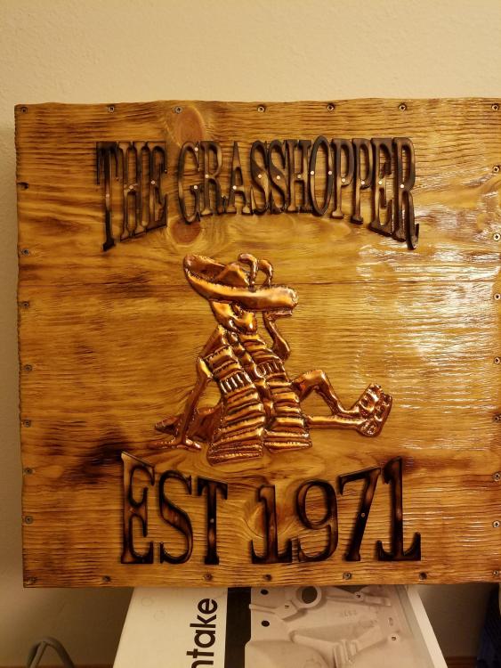

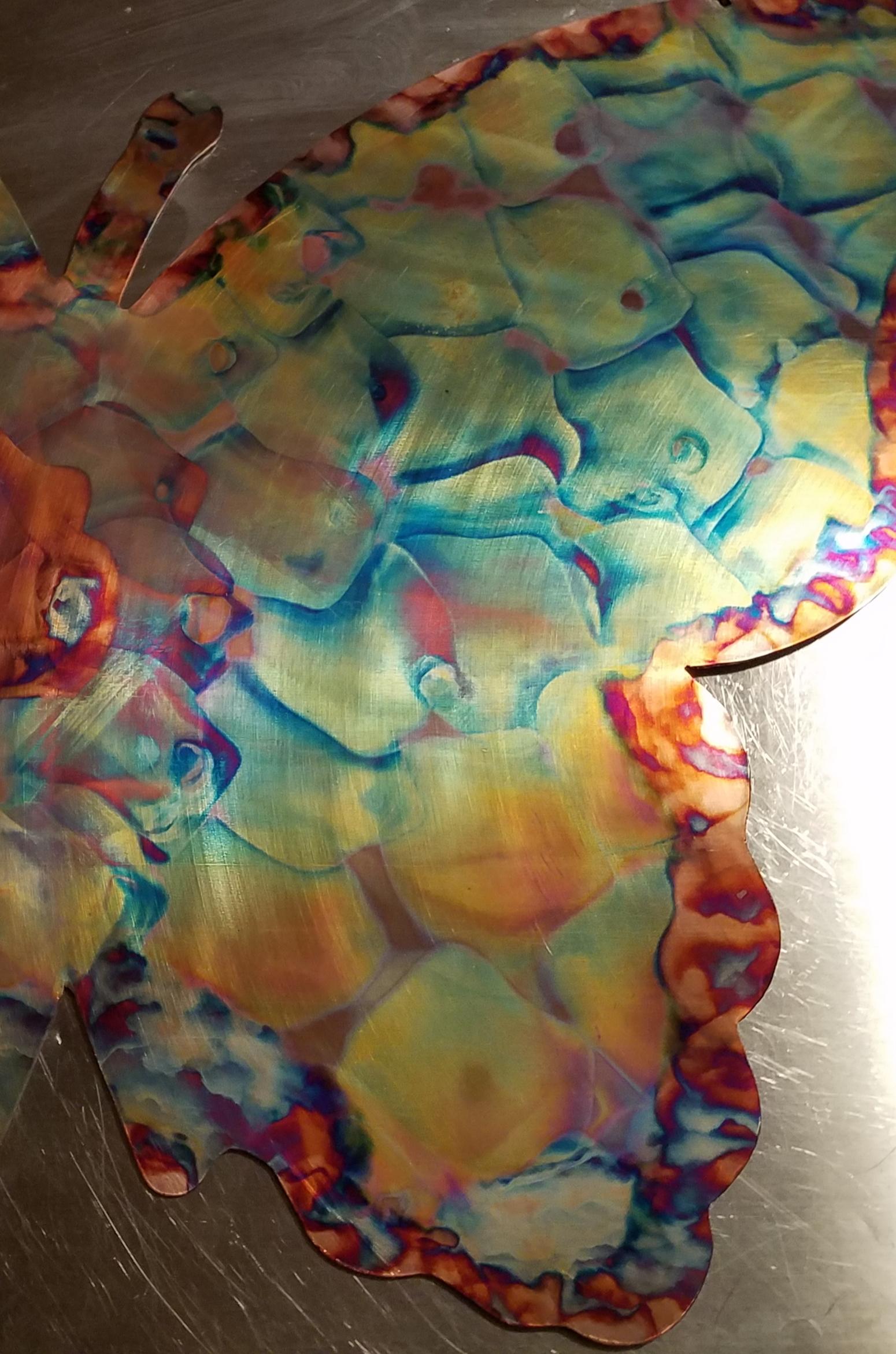

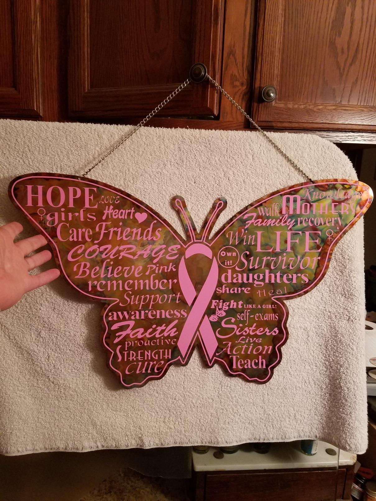

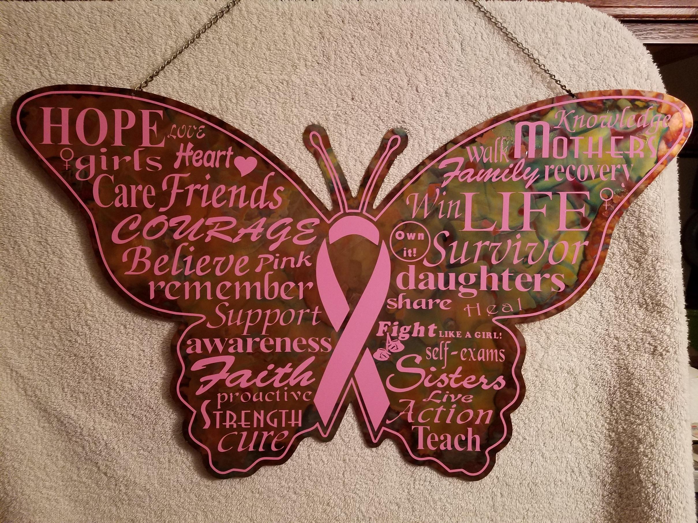

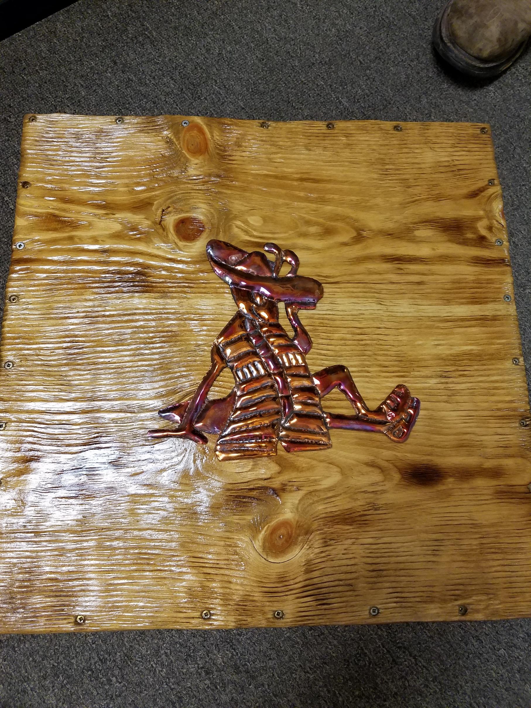

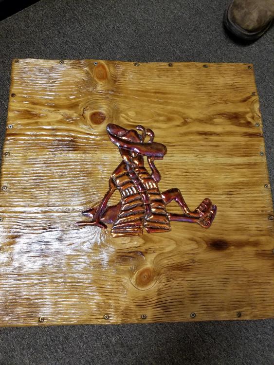

Welshj Posted April 29, 2020 Share Posted April 29, 2020 I did this with a mapp gas torch some time back. My stepdaughter battled breast cancer and won. She wanted a door hanger to represent breast cancer awareness. Enter me, and copper sheet. Then, I hand hammered a copper grasshopper logo for family's restaurant. Flame painted that with oxy/act torch and brazing tip. I coated that with lacquer, and promptly killed the colors. I found that water based poly acrylic doesn't kill the colors. I got it in a spray can and started with light coat, dry, light coat as suggested earlier in this thread. Worked well. On 10/23/2019 at 4:57 PM, Maui Mermaid said: *I do have a question though, is there a setting I can enable which will send me an email notification each time this thread is updated? When you're posting, or posting a reply- theres a box at the bottom just above the submit reply button that says "notify me of replies." It shows up on my phone that way. If you go into your settings under your account- you can modify how you're notified. Quote Link to comment Share on other sites More sharing options...
Mark88 Posted April 29, 2020 Share Posted April 29, 2020 Welshj -The pieces look great ! Quote Link to comment Share on other sites More sharing options...
Frosty Posted April 30, 2020 Share Posted April 30, 2020 The patina came out beautifully Welshj. I'll have to write, "water base acrylic spray" down. Frosty The Lucky. Quote Link to comment Share on other sites More sharing options...
