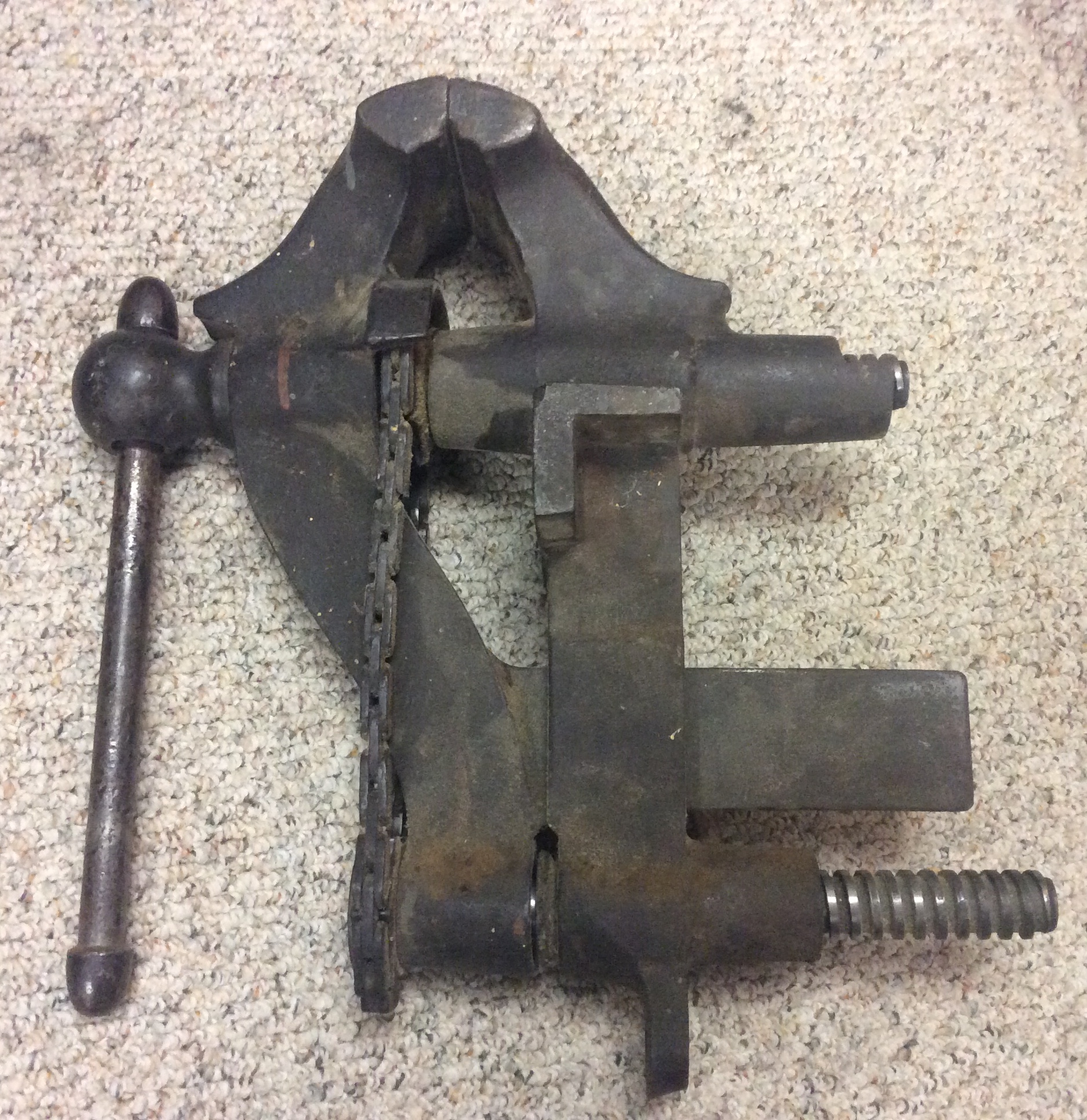

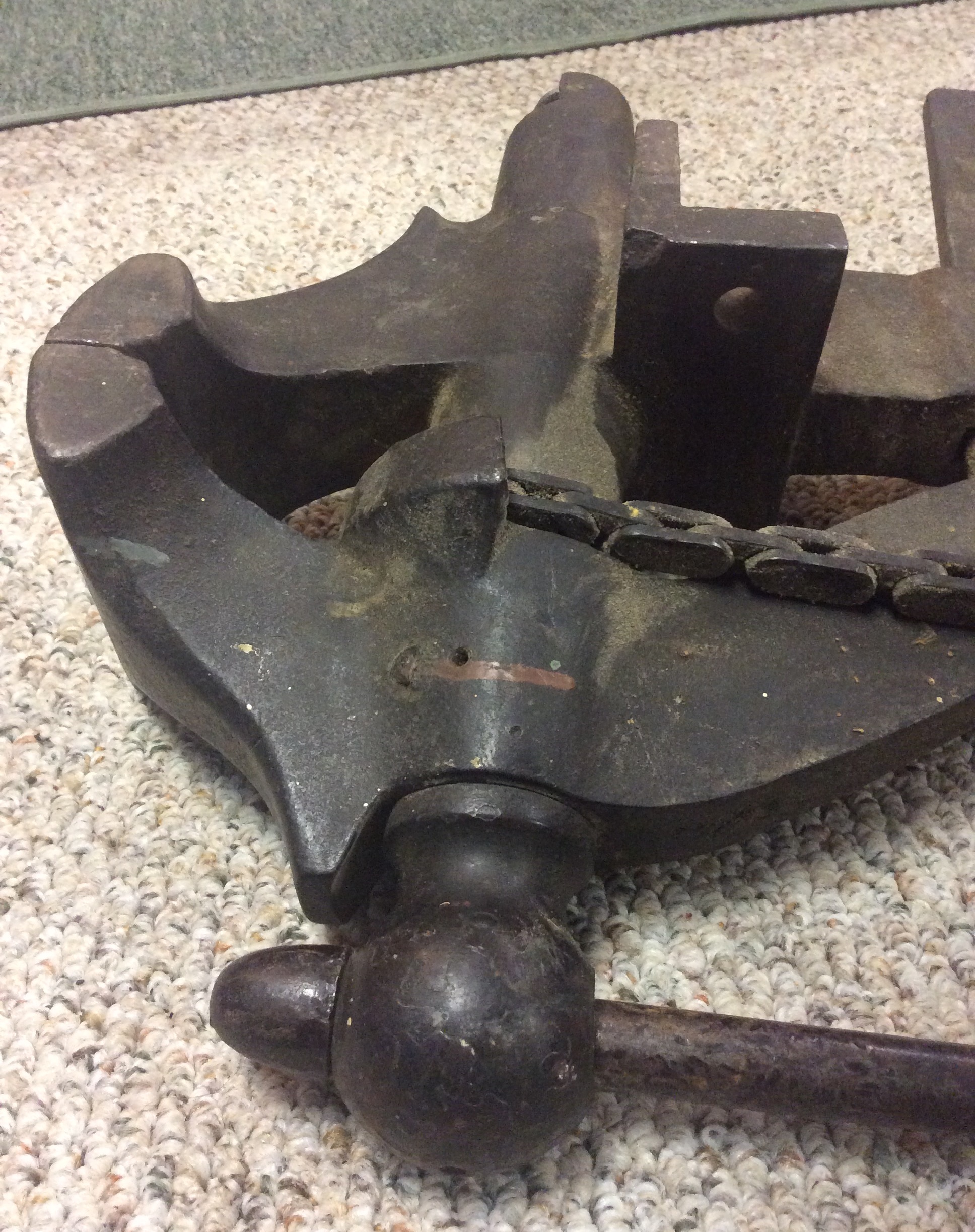

I came across this double screw chain vice recently that I am trying to identify.  From everything I’ve read, sizes, weight, etc....  it seems like it’s an early FISHER #2.   I have not been able to find any actual photos of a #2 online, only the later vices #3+.   There are no names on this vice and the only numbers are a small punched 21 in two spots.
