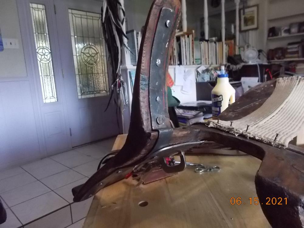

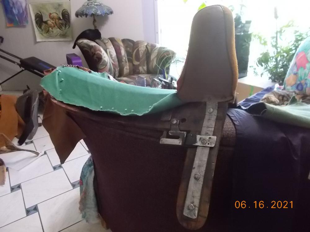

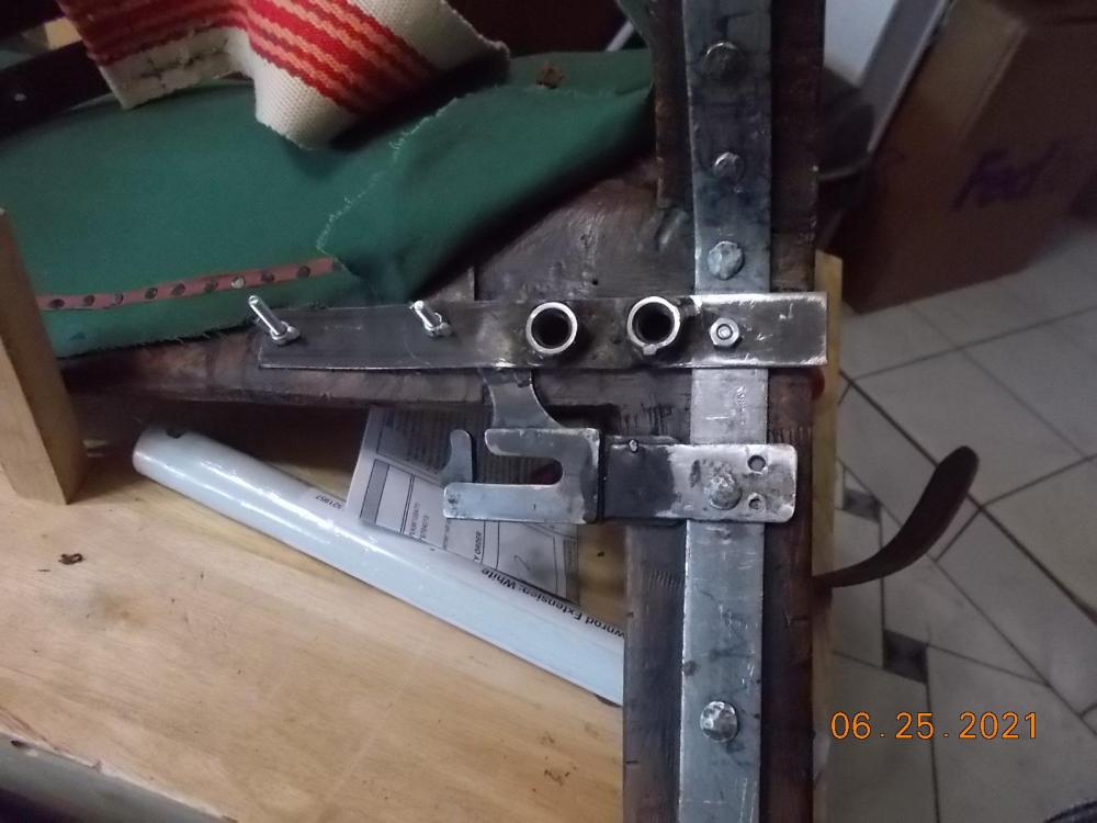

hi, can i use a bolt for a rivet??   i am cold setting mild steel rivets in a sidesaddle tree with wood between 2 pieces of mild steel.  i usually use common nails for rivets but would like to  to use 10-24 bolts
i have peened a couple of the bolts to see if i can form a head and i can.   any thoughts on the disadvantages??

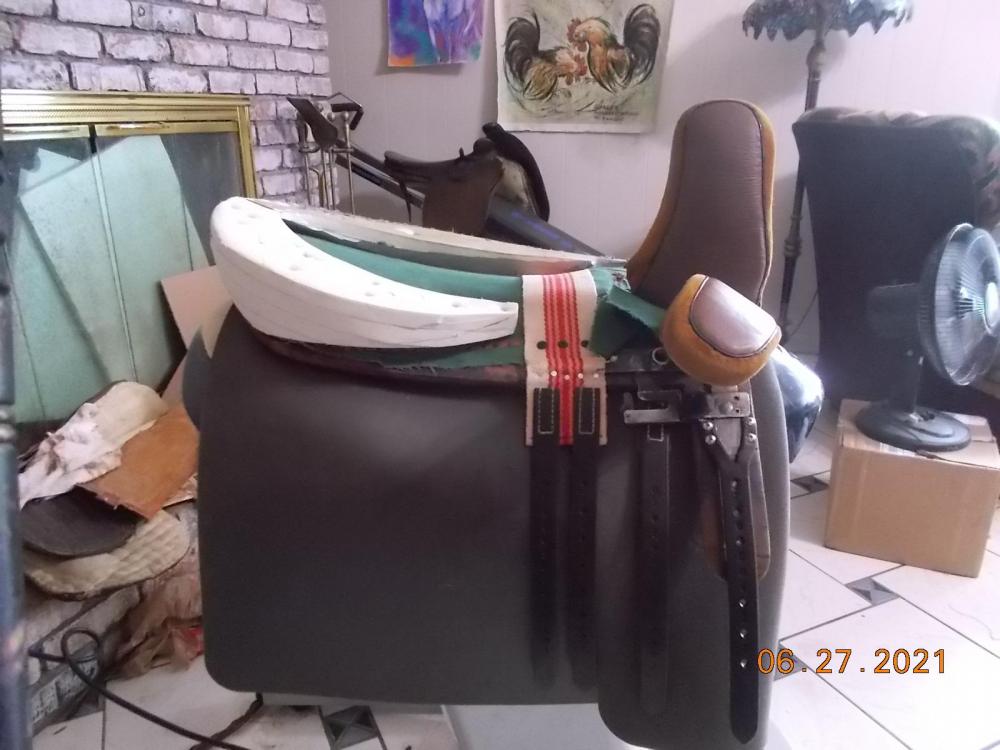

okay , lol!! that is what i was thinking but wanted to ask , i rebuild antique sidesaddles and have been doing it for a yrs. common nails work well and match the old mild steel i am working with. some of the saddles are 150 yrs old.
i am doing a re build on a newer saddle now , replacing the cheap aluminum, and using  11 and 14 gauge steel metal for the straps on this one
i used the bolts to pull the metal straps  tight against the wood, then planned take them out and rivet.    today i got to thinking why not just rivet the bolts.

Make sure to get mild steel bolts, the high C ones would be a pain to hammer on! If you go to buy steel; I'd look into real 1018 or 1020 and NOT A-36. Of course prior to 1850's  real wrought iron would be used; hopefully triply refined.
